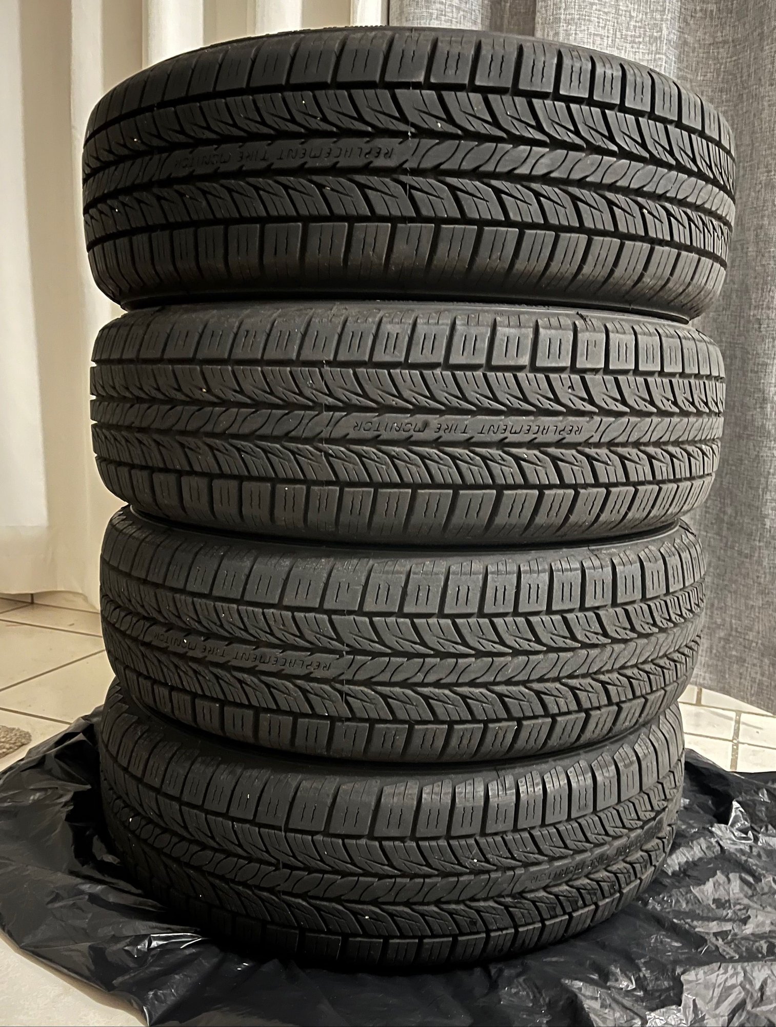

Found some nice condition General tires on offerup. $100 only for the 4.

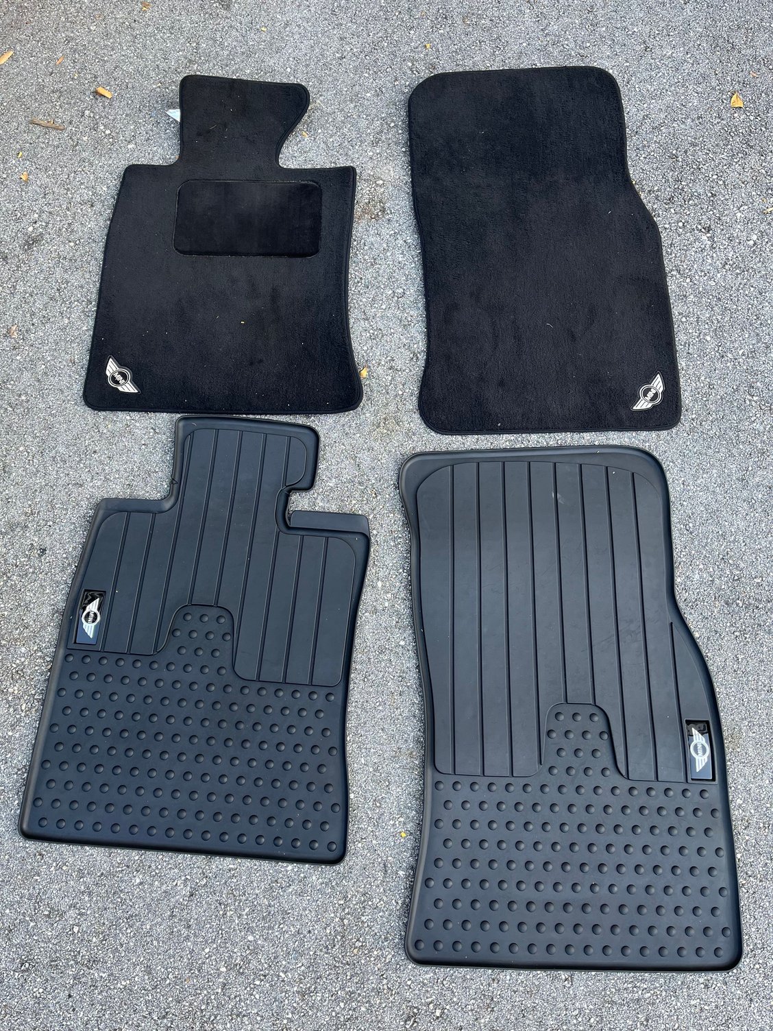

Old carpets were very dirty so i decided to get OEM rubber ones. Fit great and easy to clean.

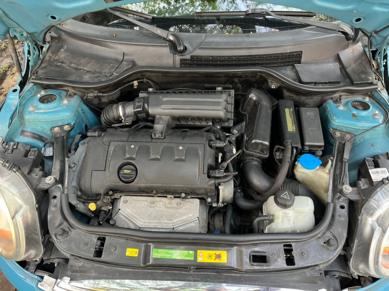

Engine bay, after

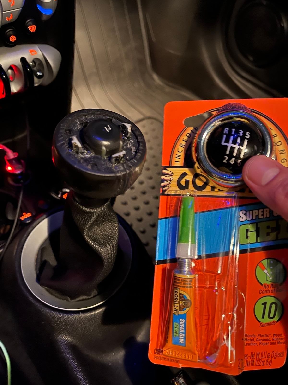

thank you, it's been pretty decent. The shift **** broke off, but it was an easy fix. Also got a check engine light last week for ABS/speed sensors in the wheels. Might be having to deal with that in the future. Also, ordered some LED headlight bulbs to swap out the aftermarket HID ones which intermittently don't work

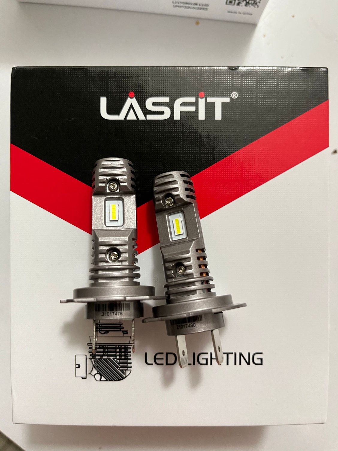

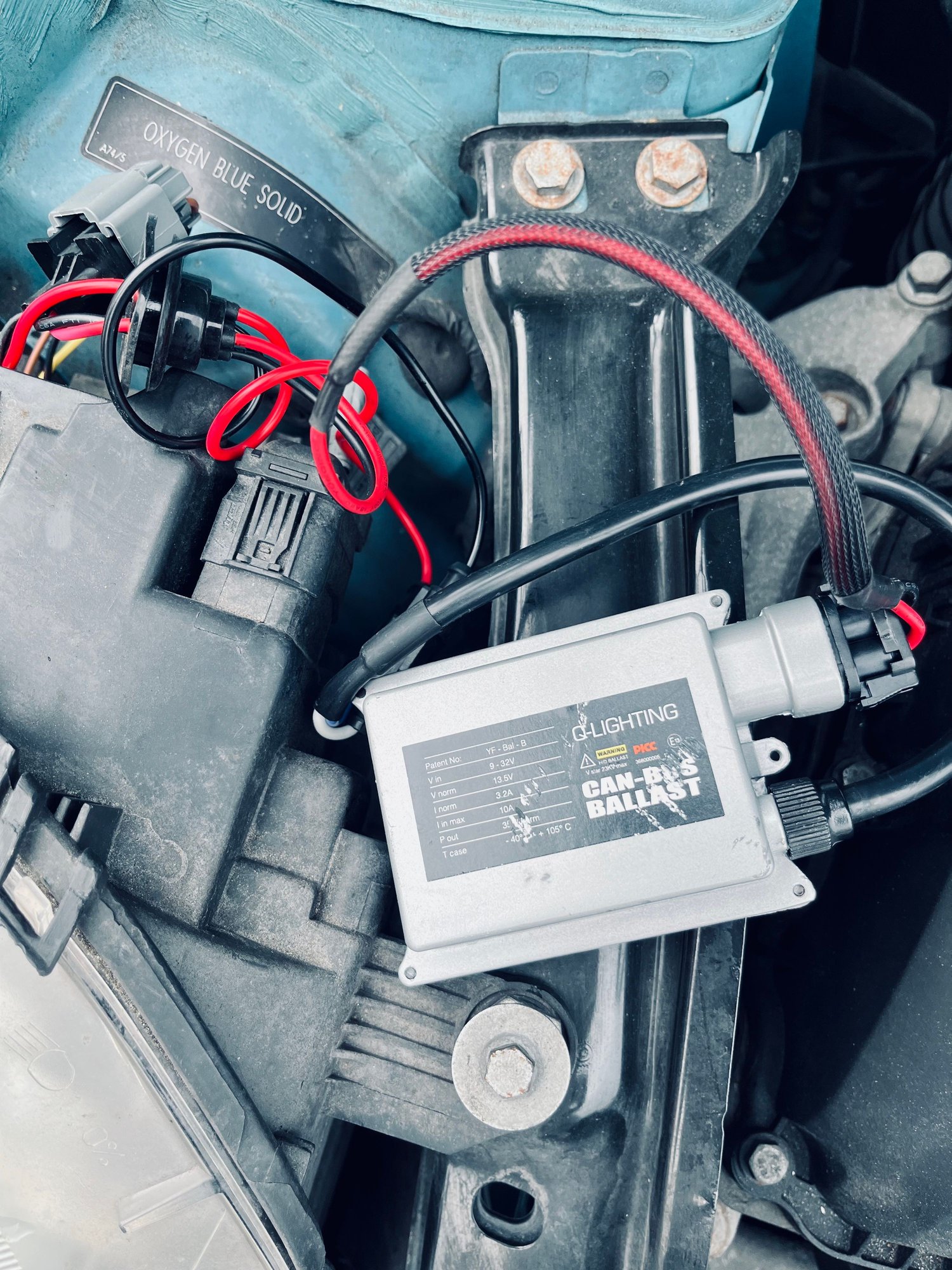

Thanks. The CEL light came on, apparently it's the front weel speed sensors. Probably going to order from RockAuto. Also the headlights are only working intermittently. I purchased some LED bulbs.
H7 LED bulbs
But when I opened up the headlight housing, I found this contraption. Apparently someone previously converted it to HIDs. Not sure how to proceed.
