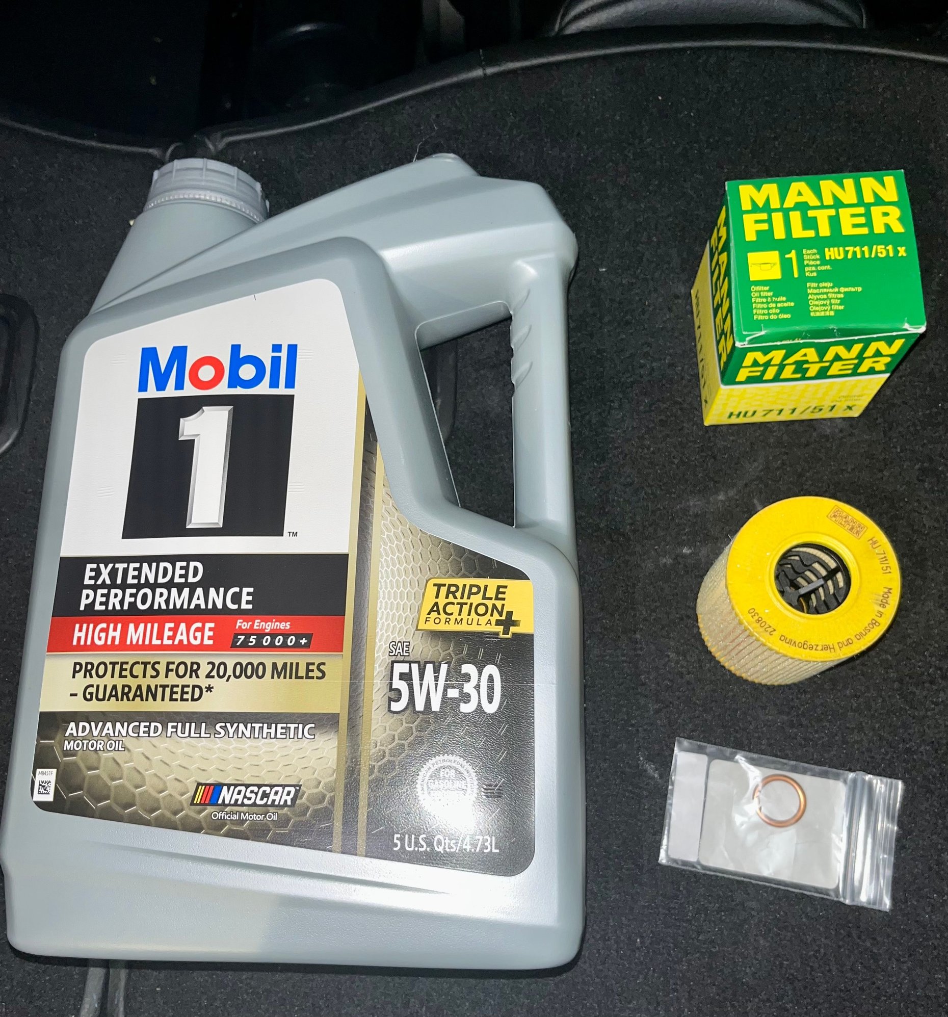

The oil light has occasionally been coming on. I still don't know how to properly check the oil level of the vehicle. I've been topping it off here and there. It seems to light up during sharp turns. Otherwise, I bought the supplies for the next oil change. OEM filter/gasket and Mobil1 extended performance. The best of the best, what i run in my GS460.

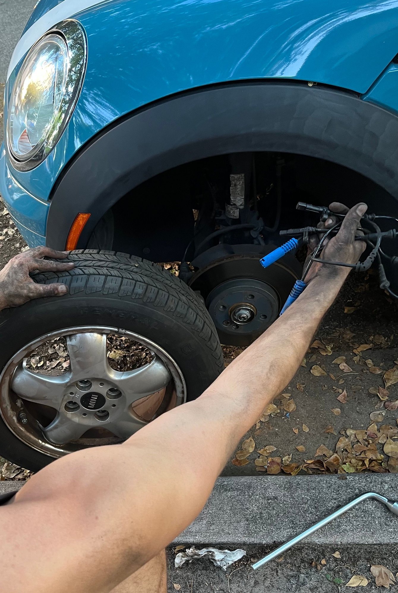

The ABS light has been on the dash for a long time. After getting the code scanned, I ordered new BOSCH wheel speed sensors.
I got the proper tools together and watched several instructional videos. The job had some difficult moments, but was pretty straightforward. Working for the first time on a German car definitely made me appreciate owning Lexus / Toyotas. I rounded one of the lug bolts on the wheel, and several fender liner clips. The sensor harness was brittle and crumbled away.
Not sure if the sensor has been replaced in the past, it seemed newer than the rest of the car, but the quality wasn't great.
Nevertheless, after changing the sensors, (to my surprise) the warning light on the dash turned off, and the car drove better.

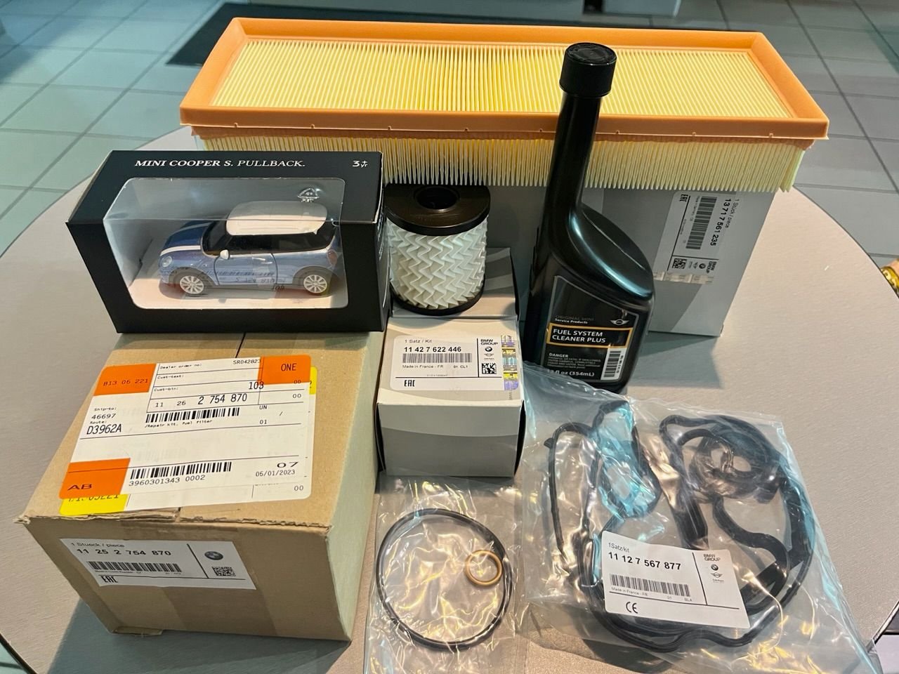

Went to the BMW dealership with a friend today. He upgraded his lease, and I got some OEM maintenance parts for the mini. OEM air filter, fuel filter, pair of oil filters, valve cover gasket, and fuel system cleaner.
