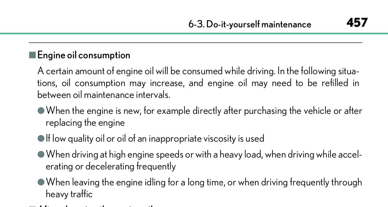

I would agree that it is normal to burn some oil, a quart at 500miles is not within spec (thus not normal) and spark plugs covered in oil are likely the result of a defect
Here is the official Lexus spec on the Ls460

Not at all supposed to be dismissive. Unfortunate you thought that. . I just find that there are misconceptions about oil consumption. The original LS from 1990 goes on about fuel consumption, it is all dependent on how it is driven. It also goes on about moisture and how fuel can get into the oil and high speeds hides dilution. Flat out says, it is normal to consume oil. Interesting stuff.
Lexus manuals flat out say that new engines consume more oil.
On the other hand, the LFA flat out tells the owner that 1 qrt per 600miles is acceptable, and this is using 5W 50.
As for DI, causing high oil consumption, perhaps. But Lexus cars are now more performance oriented and a 380hp likely will burn some oil, no different than the original LS that says it would burn oil too.
I think you are correct that consumers may think quality is down because of oil use, but that is not the case as it is normal.
Totally, they know the ramification of DI. Thats why they doubled the capacity of the oil sump for the 1UR engine over the UZ engines. Also note the spark plug replacement interval for the UR engine is 60k miles, for the UZ engine it was 120k miles. Why? Because of the additional wear on the plugs due to direct injection.
