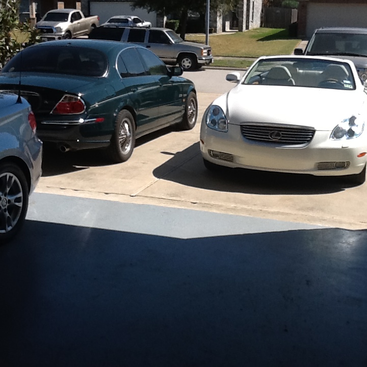

Winter tires in warm weather is a safety issue. Braking, and stability is reduced. Wear and tear no way. Things that cause more pressure on the wheel bearings, and suspension. Things not like changing your et60 wheels to an et 45. Going with wider tires. Improper wheel alignment can cause extra stress on those parts. I am not saying you can't or shouldn't. I'm saying it put more stress on the wheel bearings and suspension. With that said I have done both of those things with my s-type. When I lived in Michigan I ran winter tires. I have even driven cross country with snow tires on. Going from cold to warm. I have not had an issue. That statement must be some kind of myth he has heard. By the way I am a mechanical engineer. The only way tire compound can be a contributor to drivetrain damage would be with extra grip. This would only be true on the drive wheels. Instead of the tires spinning they hook up, and the axels, rear gear, drive shaft, transmission all now have greater stress. Now sticker tires on the front can have more stress on steering components. Winter tire in the summer do not have better grip. You can smoke those things readily.
Bye the way, 3.0 or 4.0?

Coleroad, her car is the 3.0 V6 version. It turned 15 years old last March and has 157,000 miles on the clock. The car still looks great, and (knock on wood) still runs great. Do you still have your S-Type?

OH yes, I still have mine. Mine is a 4.0, 2000 with 91,000 miles.

Neat car BTW, I am down to 3 Jaguars... love em.
