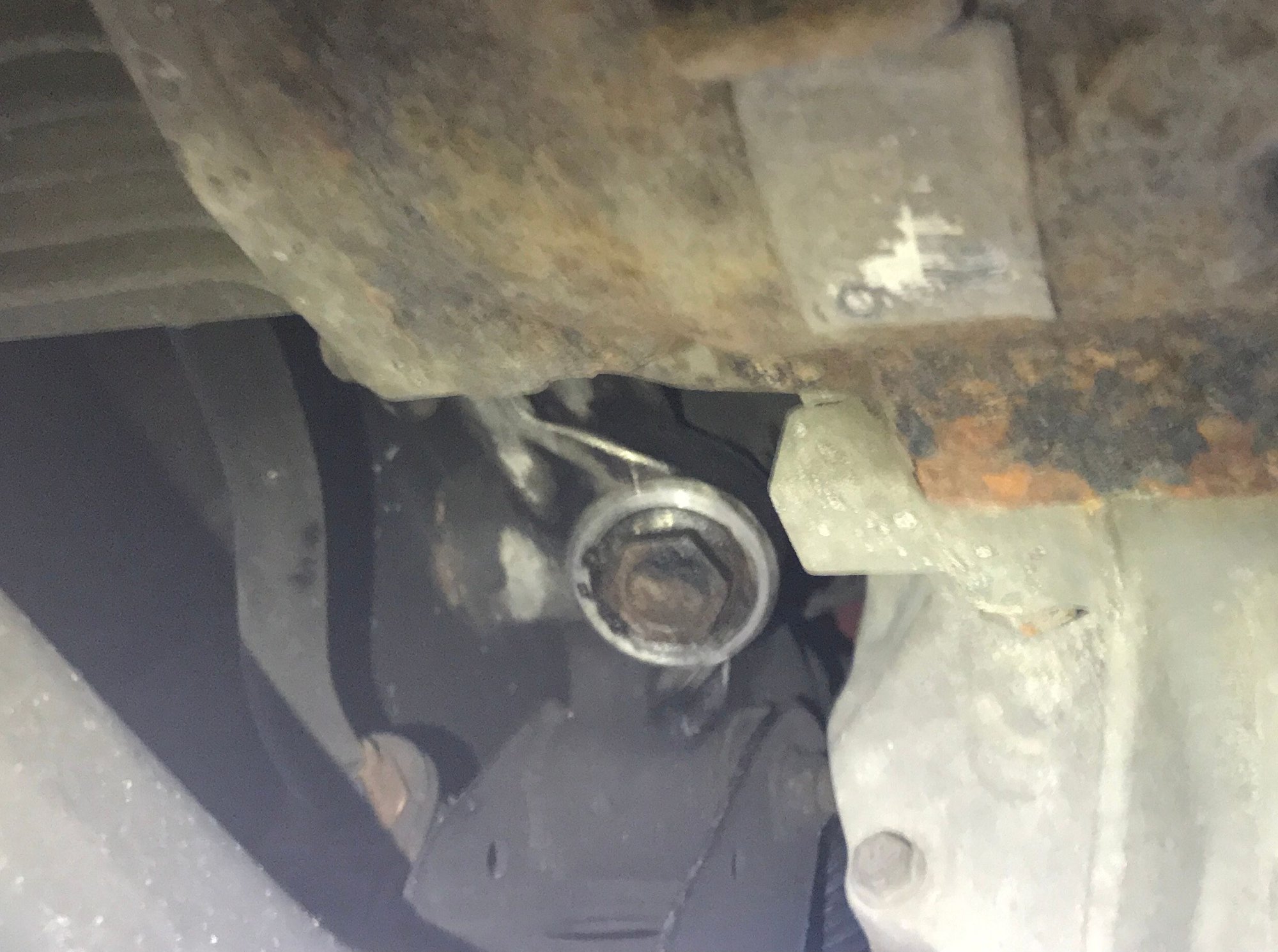

LH1...thanks for the reply. I see your point on keeping it. I was thinking about it this morning...for the extra money i put in on gas, i'm saving on a car payment. I wouldn't buy anything thing new (I prefer used). Also..in the current market new and even in the USED market, car prices are bonkers! Then i thought..maybe i'd get someone else's problems? I KNOW the car i have now, i know the original owner and drove it easily. I've done basic maintenance myself (plugs, coils, oil and tranny/transer case/rear diff fluids, brake pads, rotors) , which is up to snuff.
as for the power steering, the pump got changed a couple of years ago. I suspect the tie rods need to be changed (wobble in wheels when shaking at the 9 and 3 positions). I can also feel a slight "bounce" feel in the steering wheel. The tie rod boots are also always covered in oil/grease) there is also "sweating" around the bolt, underneath the rack itself. I figured for the work to do the tie rods, may as well change the whole rack???

Confirm that the rack isn't leaking, if it's not there is no reason to replace it. The PS pump has an O-ring on the feed side that sometimes degrades and can drip on the rack on the pass side so check that as well.
Tie rods are not hard or expensive to replace even if you do the inners as well, book time is about 2 hours max excluding alignment.
As far as struts if you want he factory glide you need to use OE strut inserts and factory springs, KYB is the OEM but their aftermarket options are valved harsher than OE so I can't recommend them.

Striker... as i mentioned, the ps pump was changed over a year ago, but i will look again. Also as i said, there is "weeping" from that big (drain?) bolt on the bottom of the drain bolt of the rack. I'm also getting some excess clunking when going over harsh roads...maybe the bushings on the rack are getting old?

i took a look underneath the car around where the ps feed hose (bigger hose) connects. There was just a drop of , what seemed to be regular oil, not ps (red) fluid on top of the bolt where the tube connects into the pump. I would imagine that when they changed rhe ps pump, that oring would have been new?
i took a picture of that big bolt on the bottom of the rack...

All of the GR V6s have an infamous timing cover leak around that area as well, I wouldn't be shocked if that's where your oil is coming from
oh no...is this something to worry about? Is it something that gets worst?
striker...is it timing cover or the top valve cover gaskets??
No, it's just annoying. One of my friends has put nearly 250k on his ES350 with that leak being there since 90k miles.
Timing is the infamous one, pain to do on the transverse cars.
