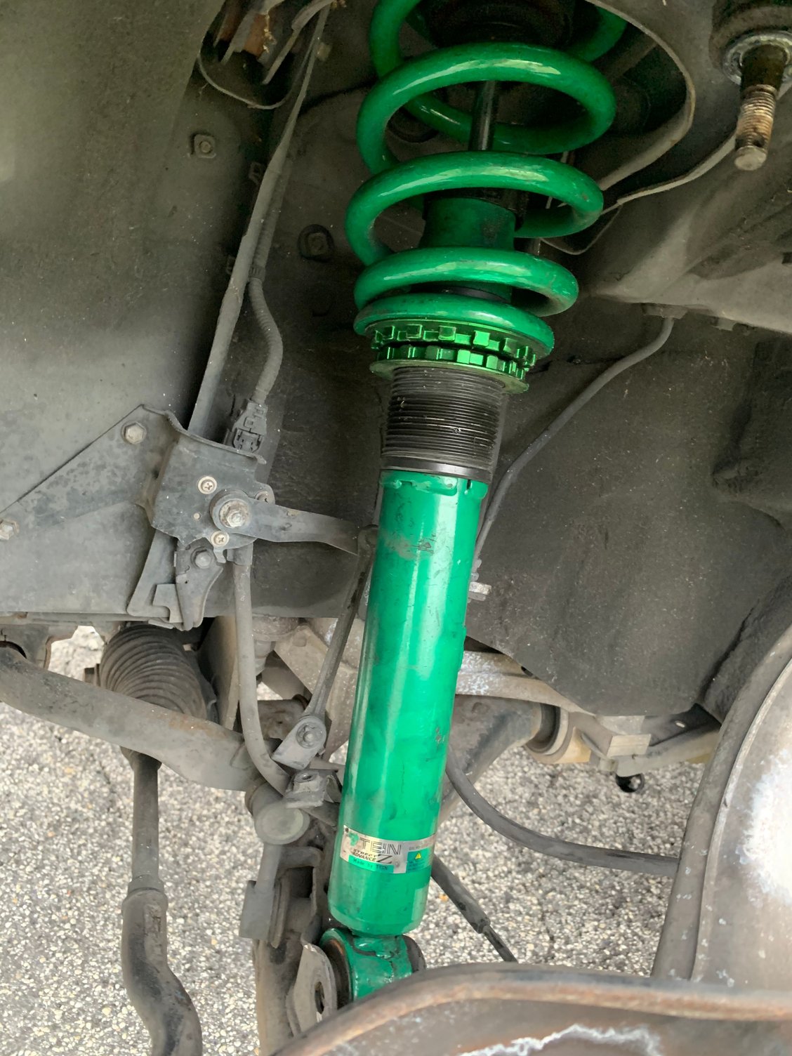

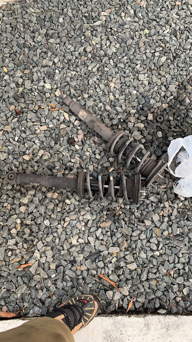

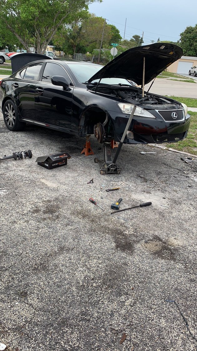

So I happened upon an 07 is250 with 108k miles, for a rack. So the car has peeling paint on the bonnet and the front fenders, blown suspension, melted door panels and looks like maybe some water damage to the interior cause the carpet on the floor looks washed out, the car sat for 4 years, drivers seat is torn but all other seats are mint and the ac blows cold radio works speakers all work and I can’t seem to find anything wrong electronically atm with the exception of the driver door controls don’t control all the windows but each door can roll its own window up or down. Considering the price I got the car Id say not a terrible buy and I’m willing to put money into it as a blank canvas right now. So far I bought used tien coilovers and installed in the front(automatically drops car 2-3inches currently no gap in front) and not the back yet. Honestly took way longer than expected to install due to ceased up bolts that wouldn’t turn so I got to cutting and replacing. Cut the upper control arm out on the passenger side and bought a new one only cost $76 for whole assembly. Where the bottom of the strut bolts to into the bracket, had to cut both those bolts as they would not budge at all, 15$ each. The car also came with some China rims and all rims had a set of 5 locks...I usually only put 1 per wheel this guy had 20 on the car, so I bought some new lugs and locks. My next thing is to put in the rear suspension and dye the carpet.

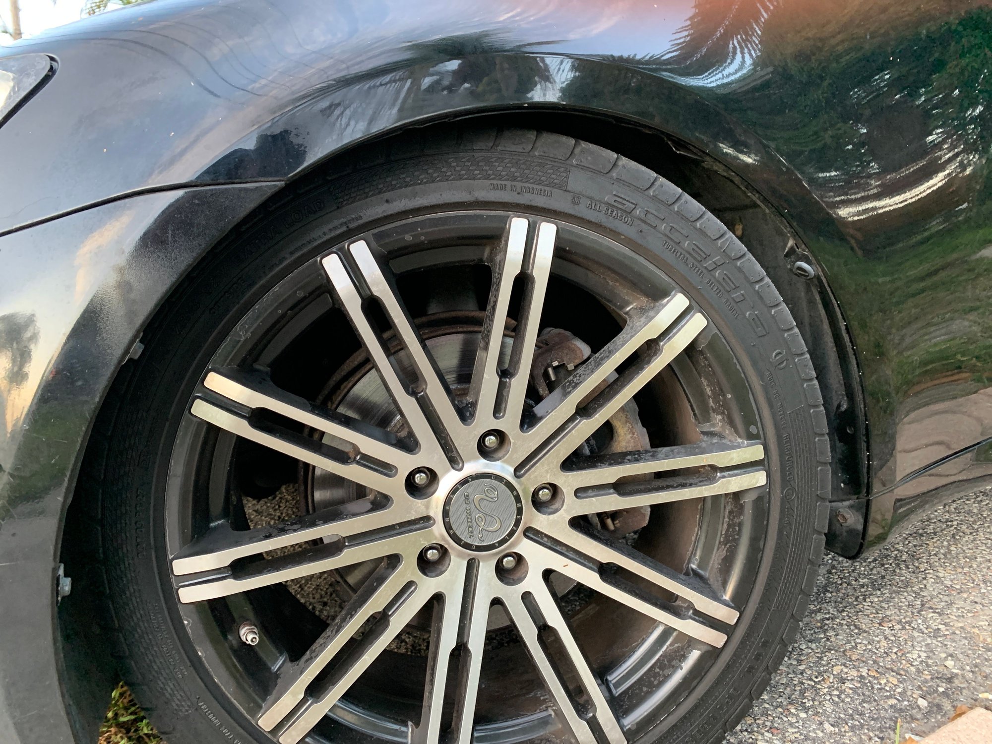

Not really a good pic cause the wheel turned but there is barely any gap

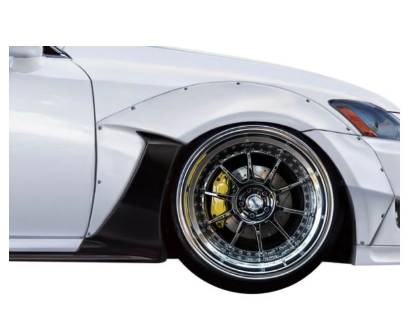

Also hearing some rattling sounds like tensioner needs to be replaced, found a timing chain complete kit for 150$ gonna jump on that. And these are the exterior parts I plan to go with on build. Anyone seen or had experiences with these parts?
