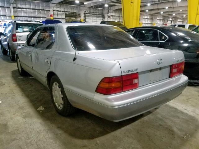

I picked up my 1997 LS400 from a salvage auction in December of 2019 for $425, total bill was $695 with fees. Interior was in pretty good condition and it had 177k on the clock with fairly regular dealership maintenance. Belt and pump were done @ 100k.
Once I got it home I replaced the broken light, mirror and driver fender for about $200 from a junkyard. I pulled as many of the dents as I could, the pictures don't really do it justice but the rear driver door dent was massive, and was happy enough with the results. Lastly installed new door glass in the driver door, new hood struts, new antenna motor and new motor/transmission mounts.

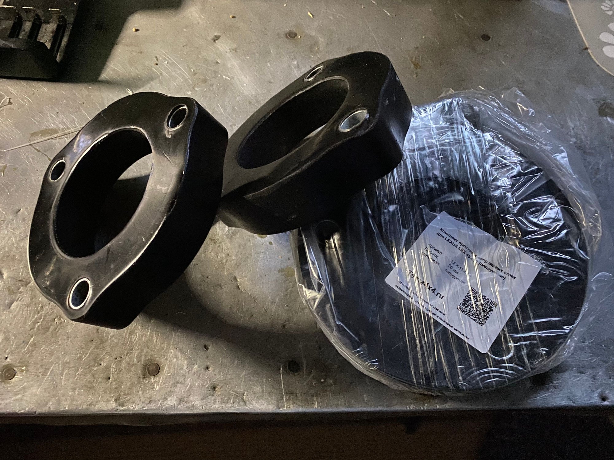

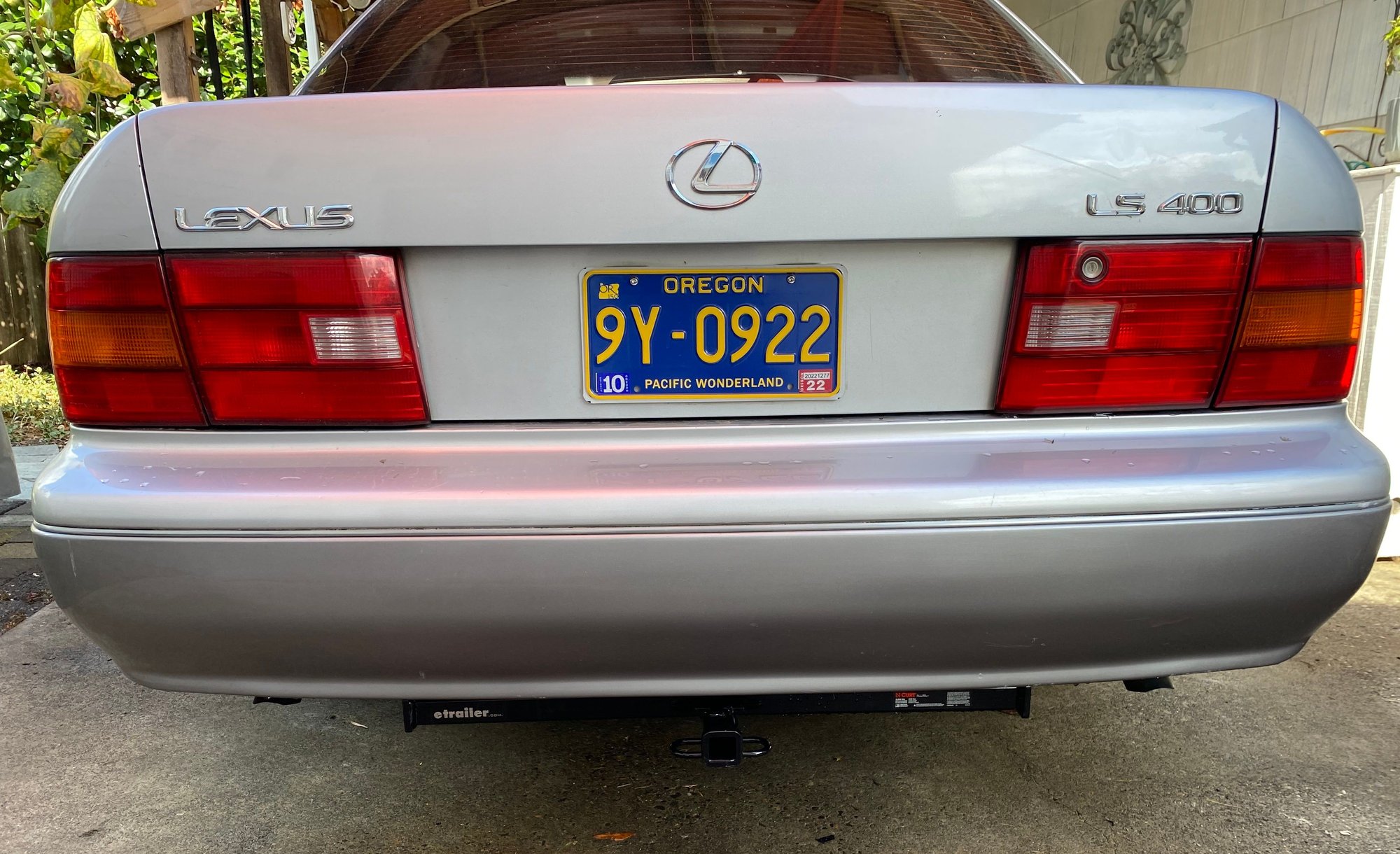

Started off by buying a Hitch, transmission cooler and some 30mm strut spacers.
Trailer is rated @ 3500lbs GVWR 300lb tongue weight

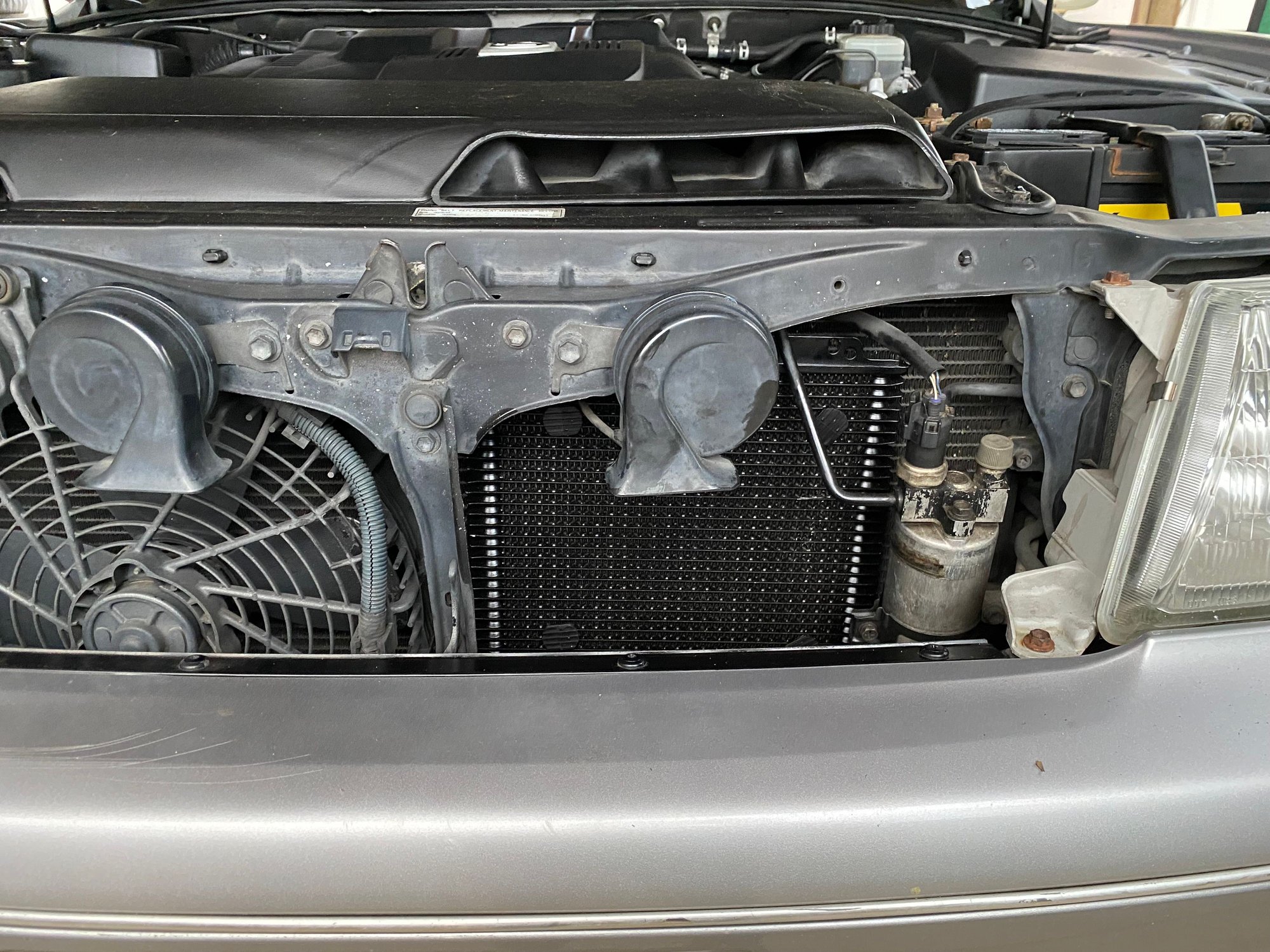

Transmission cooler is a Hayden 679
Install for both is pretty easy, I didn't love the bolts the trailer came with but other than that pretty straightforward. Right now I still have it on ramps and I'm waiting for a transmission filter to arrive as I figured I'd do a simple transmission maintenance while I've got it drained. I'm tempted to do some additional mods to the transmission but it looks like I would have to drop it to do much else.
Initially I wanted to do a VIP build because you know, VIP builds are awesome but with its new life as a tow vehicle I'm thinking more of a "battlecar" setup. I have 30mm front a rear strut spacers in the mail for a lift and as time and money allow i'll do all the requisite dumb **** (tires, lights, cargo rack, flares, etc).
Auction pictures:

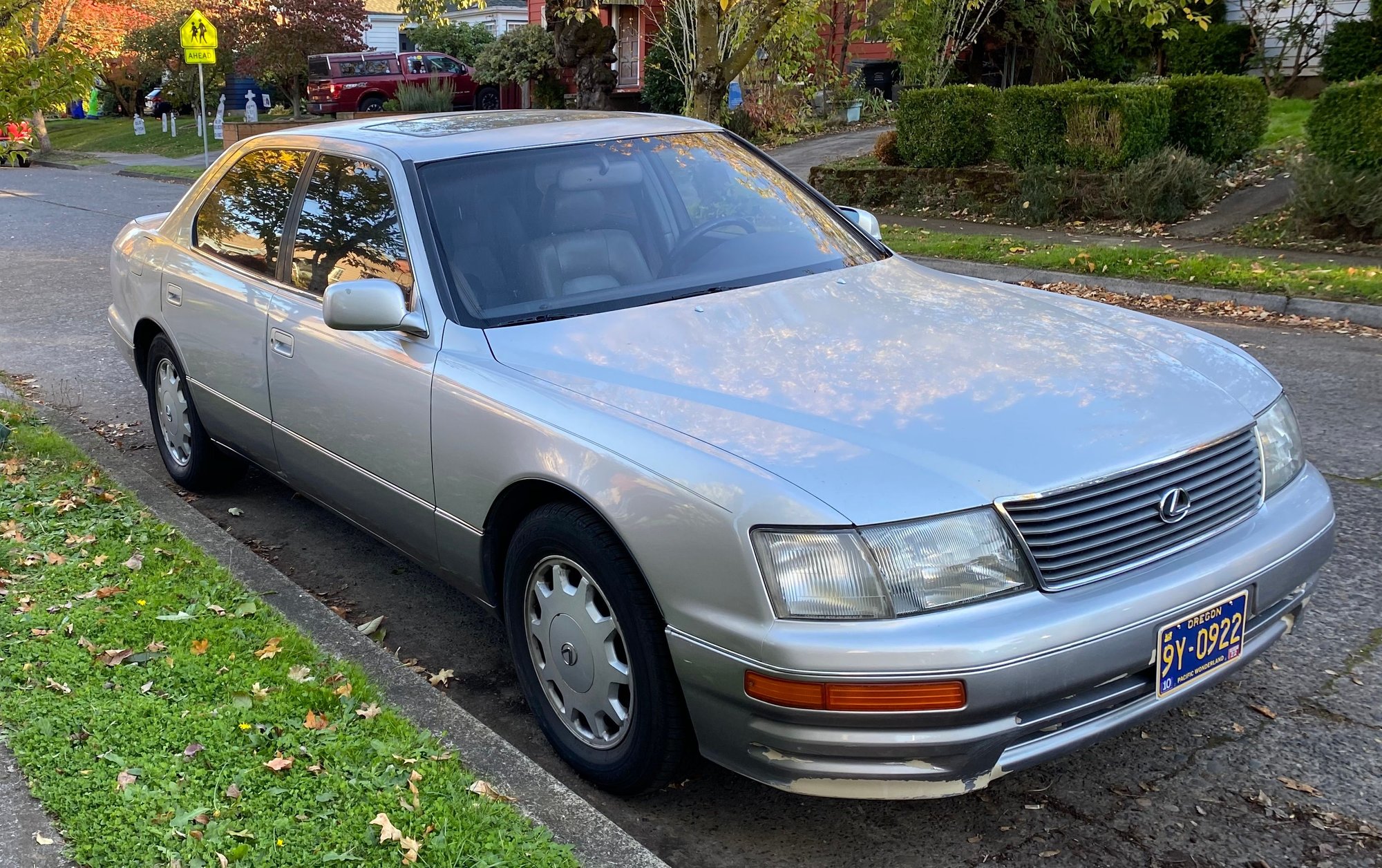

As she sits now:
Hitch

Spacers arrived, 30mm front and rear. I think the plan is to buy a set of wheels off a Jeep. Lots of stock sets up on FB and CL for 450ish with tires.

interested to see the lift once you install those spacers.
as for the yakima rack, you will just have to play with the towers and clips until it tightens down to the roof. the 1st gen might be more round at the roofline compared to the 2nd gens. i reused clips off different cars and i always got it to work on different vehicles so you just have to adjust the distances of the towers and clips to make it work.

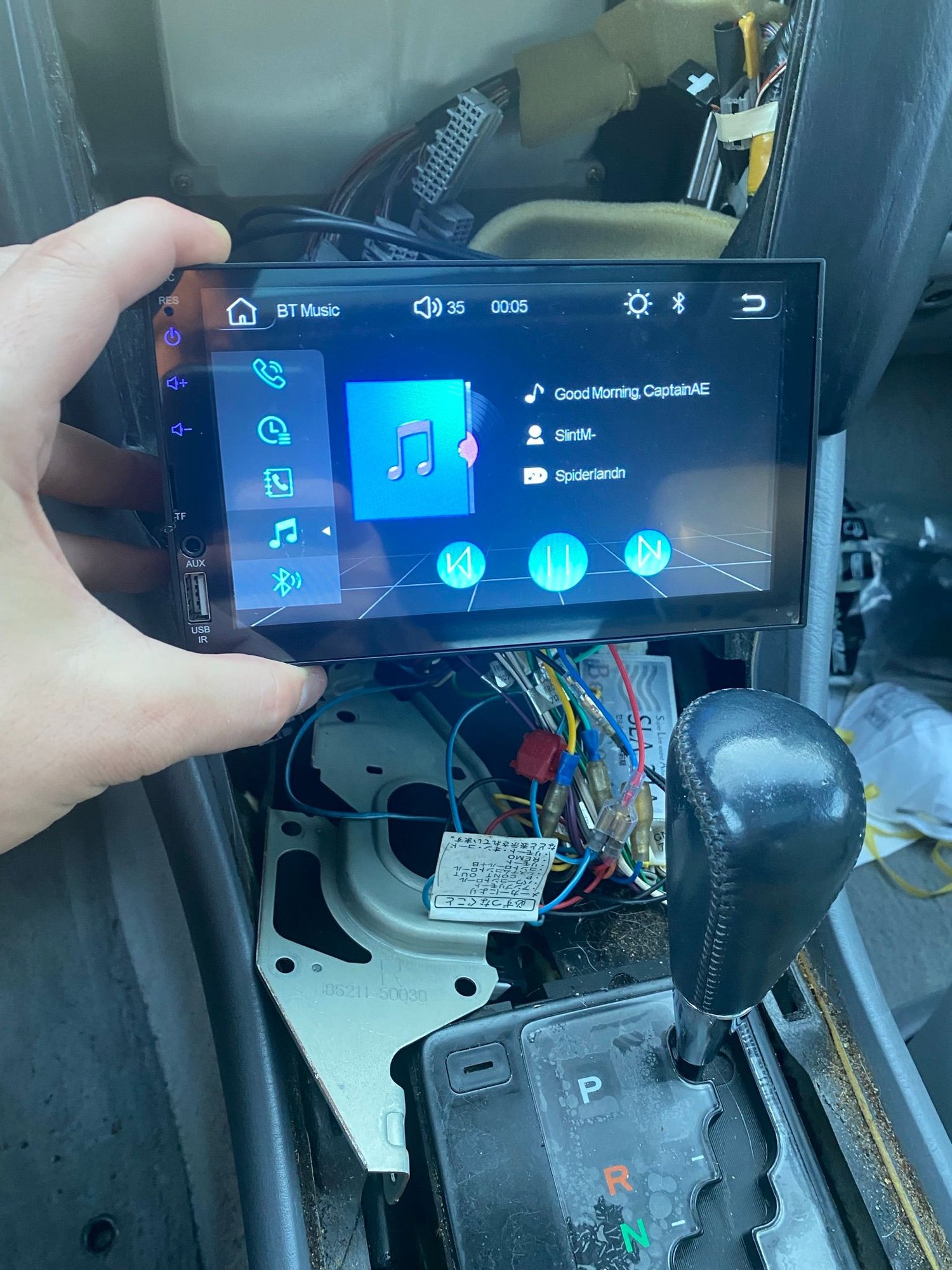

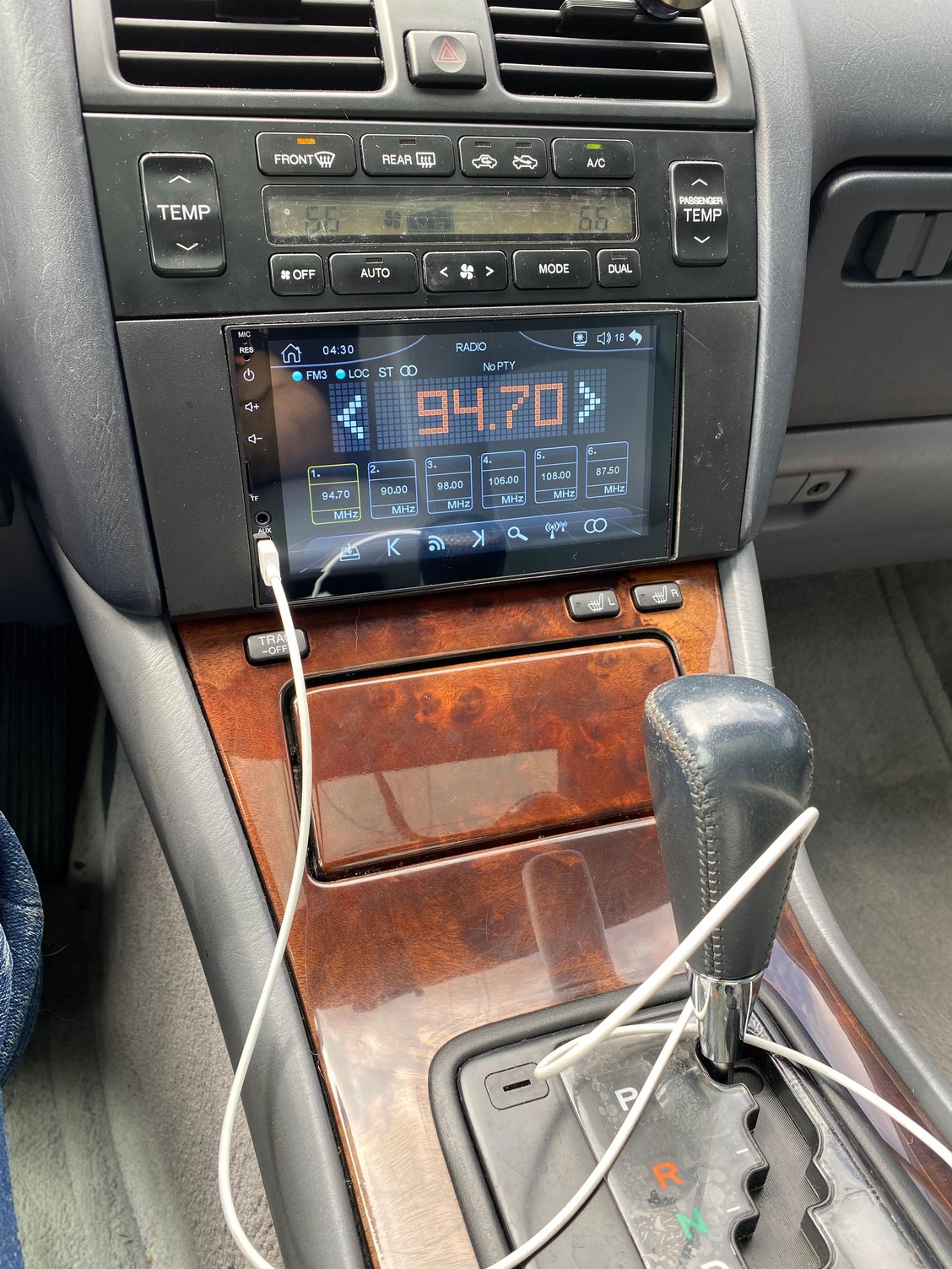

So rather then doing something useful I installed a touchscreen radio using a Beat Sonic SLA-21a I was able to find. I kinda janked up the plate it “fits” in but thankfully it was only 15 bucks so I’ll order another. Everything works well except the disk changer.
