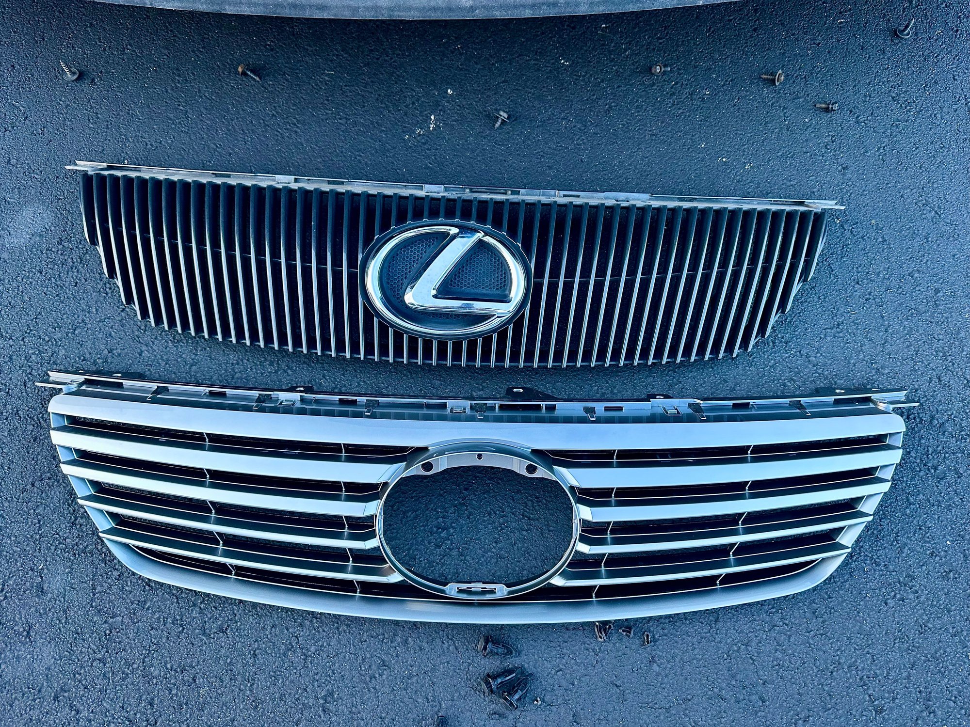

Wanted to change the front of the GS, in particular the grill. The one with vertical vanes looked sporty, like an IS.
Ordered the hybrid grill, PN 53111-30C80. $240 fron lexuspartsnow. Originally an option for the GS450h, and came with a blue hybrid emblem. The horizontal design looks classier, similar to an LS.
The entire bumper cover has to come off, then the bezel. The top weather stripping clips needed replacement. PN 90467-07137.
The emblem is slightly larger, same as on SUVs. PN 90975-02117, found a new one on ebay for $50, beware of "aftermarket" ones. You also need the retaining clips. PN 90183-06044.
A little over $300 total, and really cleans up the front of the car. The horizontal grill fits better with the whole car's design, in my opinion. I am happy with the outcome.
