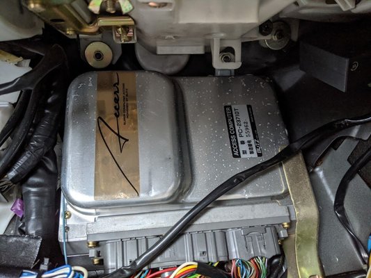

Next two steps are to clean the throttle body like @TrueGS300 suggested, and I think I should also check the ECU. Reading some other threads with other Lexus' from this time, leaking capacitors seem to be a potential cause for IACV's not functioning properly. Given that is a relatively common issue with the ECU's on this car, it's definitely worth looking into.

I had a look at the ECU last night. Bit of a surprise...
But really shouldn't be a surprise. This car seems to have almost every upgrade that was available for it in the '90's. My phone died after I took this photo, so I didn't get any photos inside the ECU, but the other good news is no visible leaks from any capacitors, so that's not my issue.
