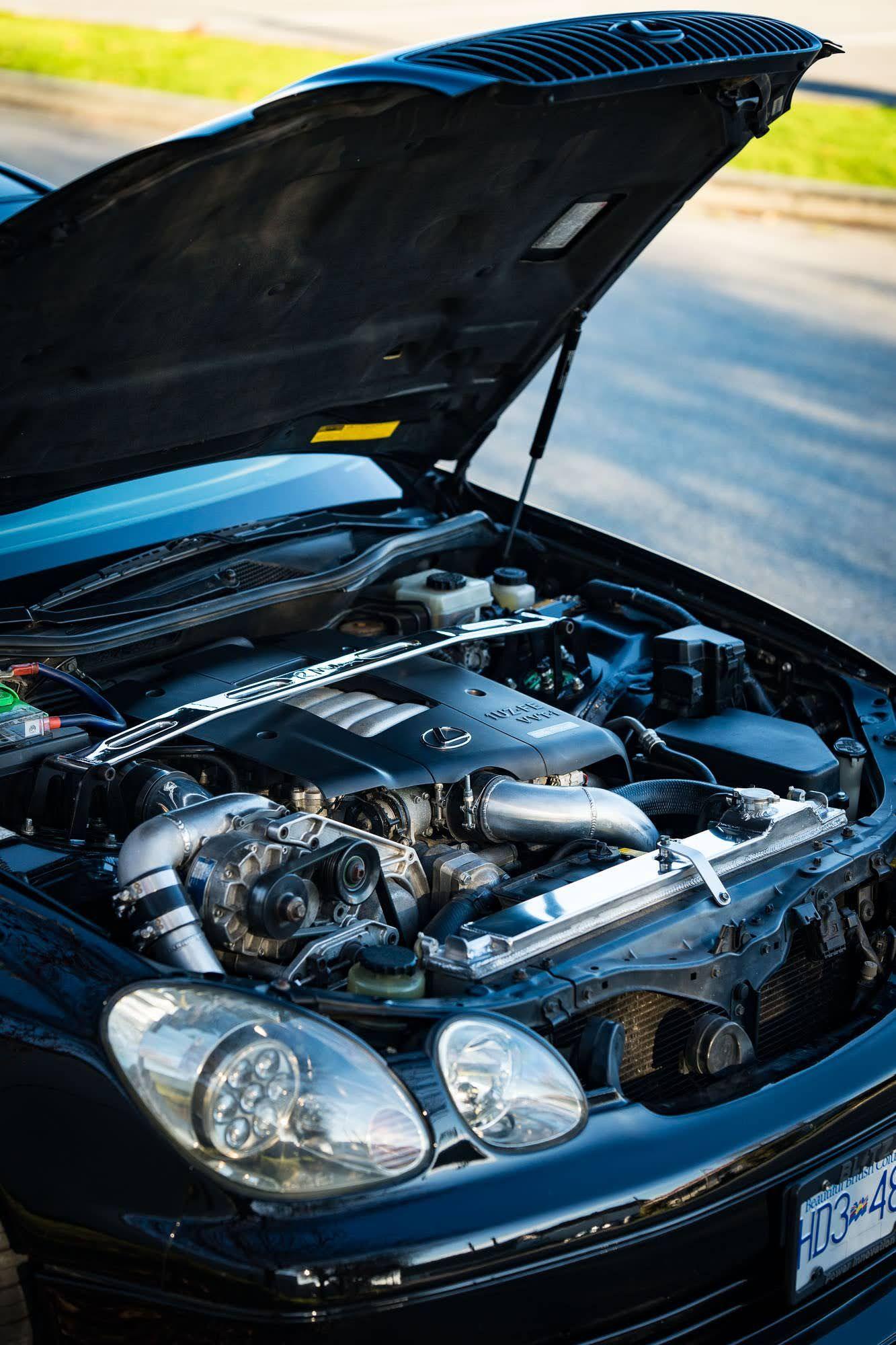

A few years later, I think its time to update this build thread
RMM Supercharger is installed. Dyno'ed at 348.5WHP with the automatic transmission

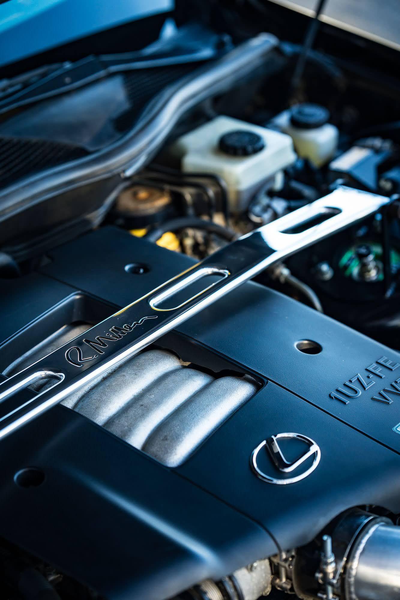

Added an equally rare RMM Strut Bar. Polished, of course
Also manual swapped with a Nissan CD009 transmission and a SerialNine shifter. If there was ever a car that should come in a manual transmission, it should be a Japanese car with a V8.

Very big progress. Forced induction and a manual swap. Great work! I am finally done with my FI and CD swap as well. What adapter kit and clutch did you use?

Fisch Racing UZ to CD adaptor and a Heat Lightning Shop Clutch kit for the GS. It all works together well.
I had to go from the 3.76 mk4 Supra gearing back to the 3.23 stock GS400 gearing with the CD. At 3.76, first gear was not usable. Much better with the 3.23 gears. I kept the Torsen LDS tho.

I ran into the same thing. My factory 3.92s are insane with the CD series gearing. I already picked up a 3.26 GS400 diff and planning to swap the ring/pinion into mine soon. The Fisch unit is very nice, looks like Serialnine and them planned theirs together. I have the Collin's kit because it was a steal used. But those are definitely the highest quality out there. Took a hard look at the HLSS interior mount clutch pedal/master too, but again. My kit came with everything used, so drilled the firewall for the IS300 pedal. Great work on your build! Seems to be going well!
