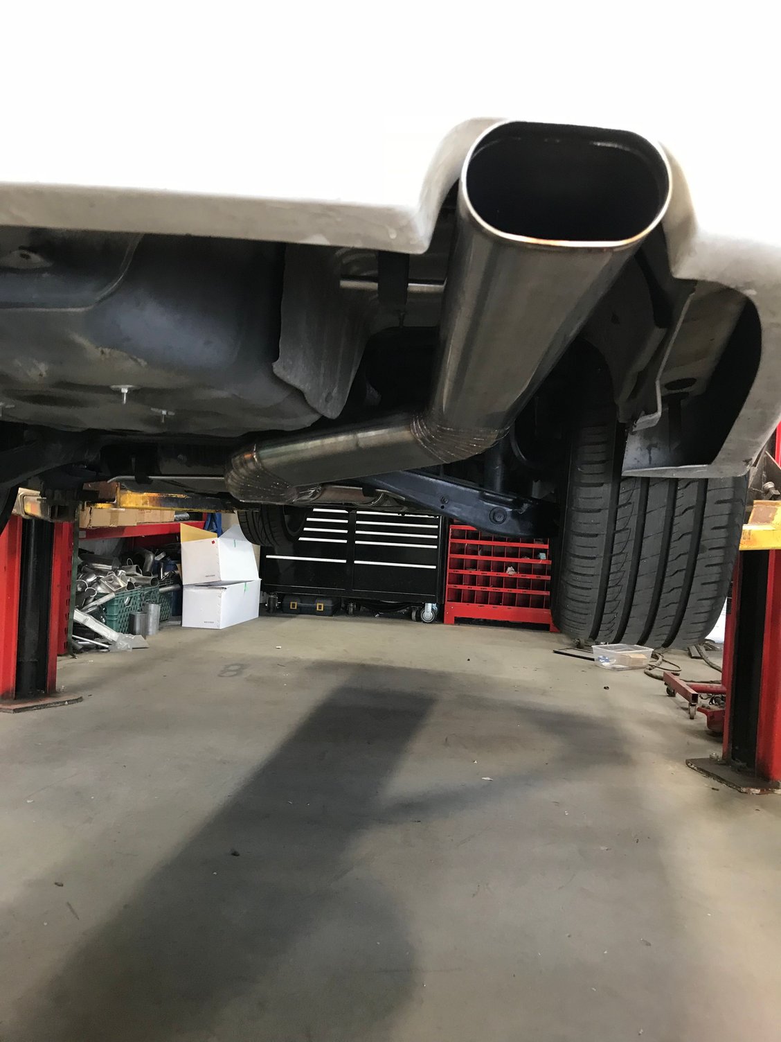

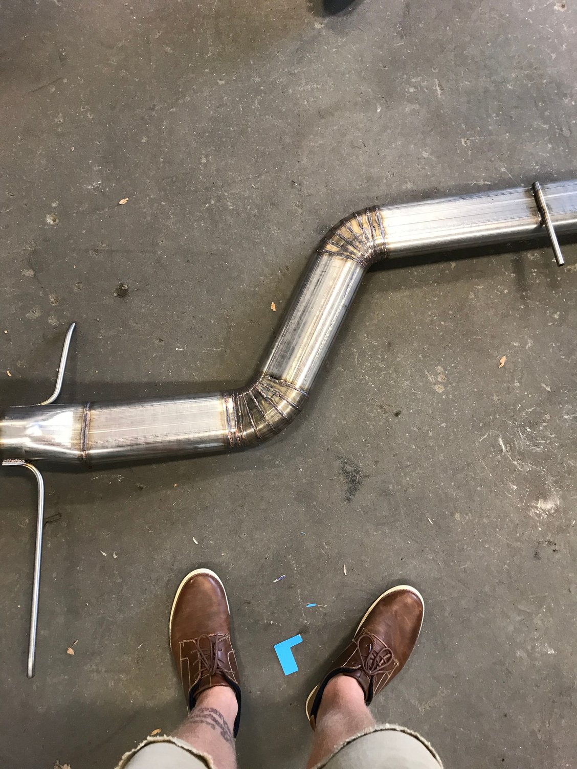

Little sneak peak of the 4” single exhaust. With using the 4” oval there’s going to be quite a few pie cuts.

Justin and Shawn finished the exhaust and they did an awesome job with it. Keeping it tucked tight. Loving the choice to go 4 inch oval. Some photogs and a couple videos for sound clips. Start up and idle.

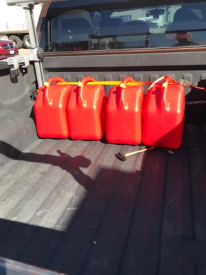

100 litres of E85 loaded up for the journey home.

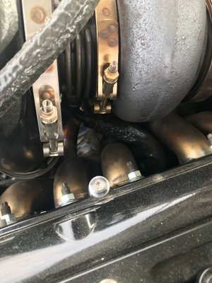

Car was driving really well and there weren't any serious issues. Had my oil drain line on the turbo loosen off a bit and spring a small leak. Having it drip down onto the turbo manifold was a little worrying so had to fix that.
Enjoyed a little over a week of the car before I headed back up to work. Put on a nice chunk of KMs and dropped her back off at the shop while I'm gone for a week of work. They gave her a good once over at the shop, changed out the engine break in oil, found my VVTi gear leaking so changed it out with overnight parts from Vancouver. Then my turbo blanket arrived and tossed that on. Also grabbed some of the same fabric to make a blanket for the Clutch Master Cylinder as we found it was getting heat sinked on my brothers car when he was drag racing and we expected the same would happen to my car. Have to finish trimming the shift boot mock up my Ma made and then get her to make this CMC blanket as well. Nice little shot of the turbo blanket installed.

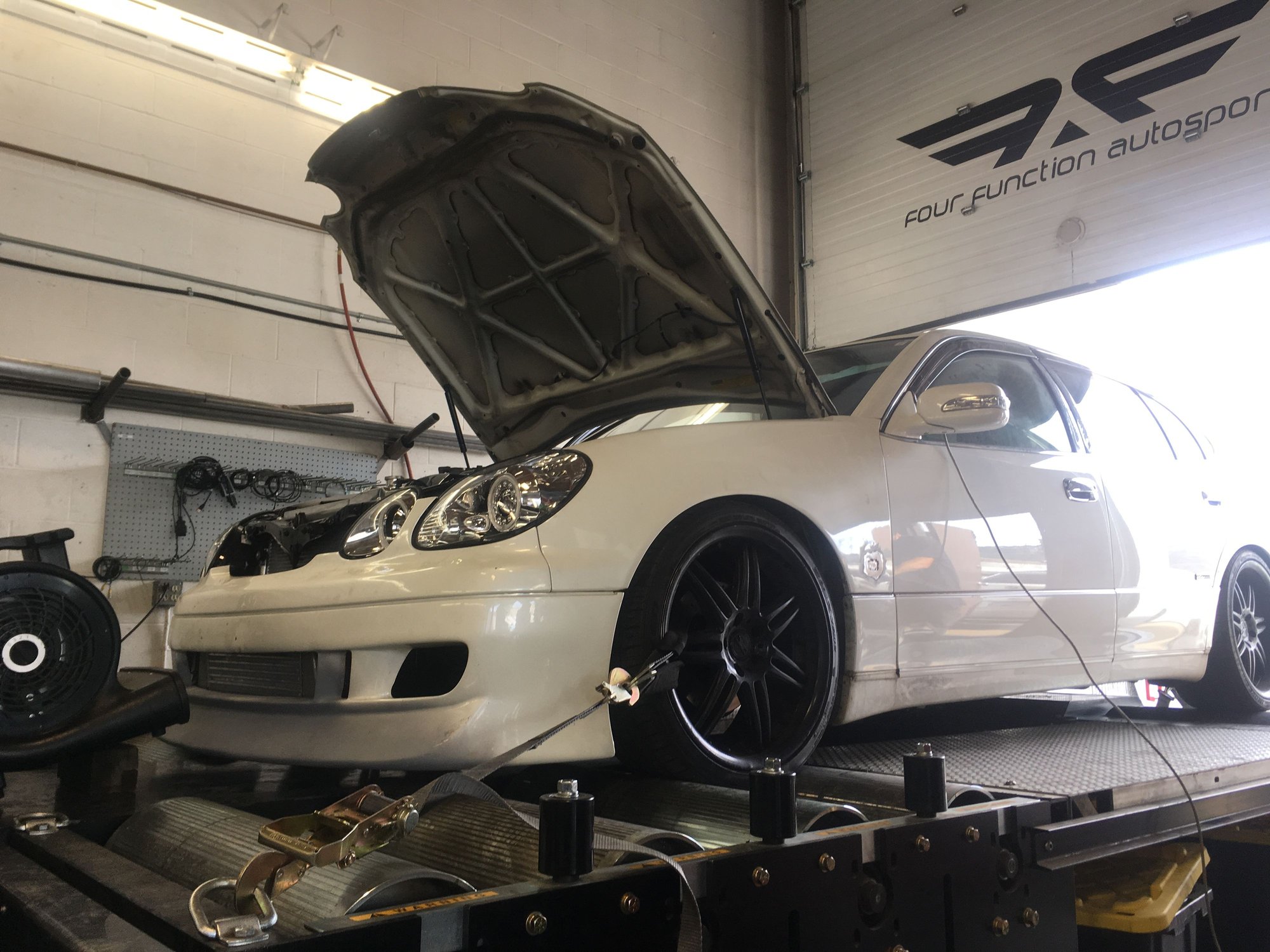

The tuning process has finally begun. Got the car booked in for a day on the dyno yesterday letting Shawn @driftunion spend some time getting the VVTi going and then adding some boost. VVTi upped the wastegate tune from 593whp to 620whp @ 16psi. Then I got this text message.
After quite the build journey we did it. We broke 800whp on pump gas and kept the A/C in the car. We hit 811whp and 592lb-ft @ 24psi on 94 pump and meth. Shawn kept tuning and ended up hitting a tune of 848whp and 612lb-ft @ 26psi before the CMC got heat sinked as we were guessing it would. She's still got more in her so we ended the session at that and will pick back up today and see where we end up on pump gas.

Finished the 94 pump gas and meth tune this morning. Bringing the final number up to 871whp.
Then it was time to syphon out the pump gas and see the car on Fury 120.
The clutch was starting to slip on the top end. Hard to believe that we made it this far before finding a mechanical weakness. At least it was what we expected it to be, the clutch.
Now all that’s left tune wise is to setup an E85 tune. Not that we were chasing numbers, but hitting four digits was a bonus. So we can just build a solid E85 tune.
My brother made it to the shop in time for the 1005whp pull. Was awesome to have him there while I was at work.
