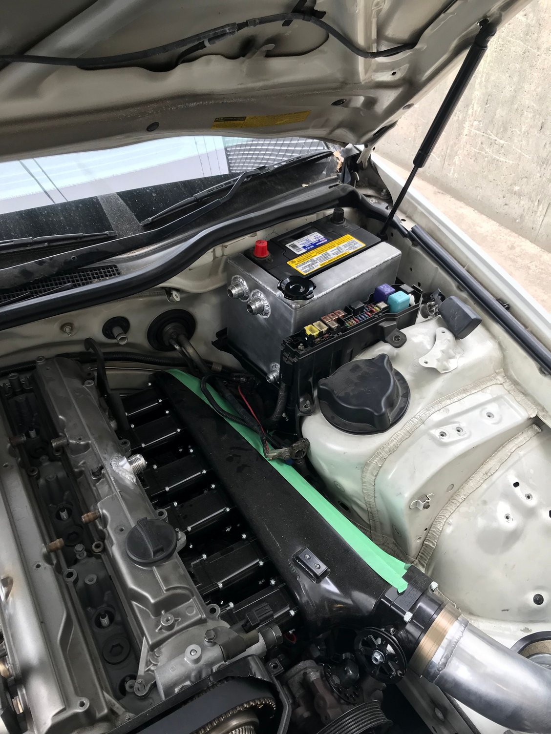

Thought I’d show the catch can setup in location. It mounts in the stock battery tray. Also a little more detail on it, it has a hidden wall and is acting as my relocated power steering reservoir.
Headlights are a hot topic, right now they’ll be better than the faded headlights. Always have an eye out for a deal on some new oem ones. They won’t make or break the build right now so I’m not too worried.
The wiring harness from Wiring Specialties arrived along with my new throttle cable from PHR. They made it in black for my build which is awesome of them, always good dealing with them. All the AN fittings and hoses are also here to button up most of the fab work. Last piece of the puzzle will be the T4 spacer which is set to arrive Monday and we can get into the exhaust setup finally. A good ol’ box of jewelry.

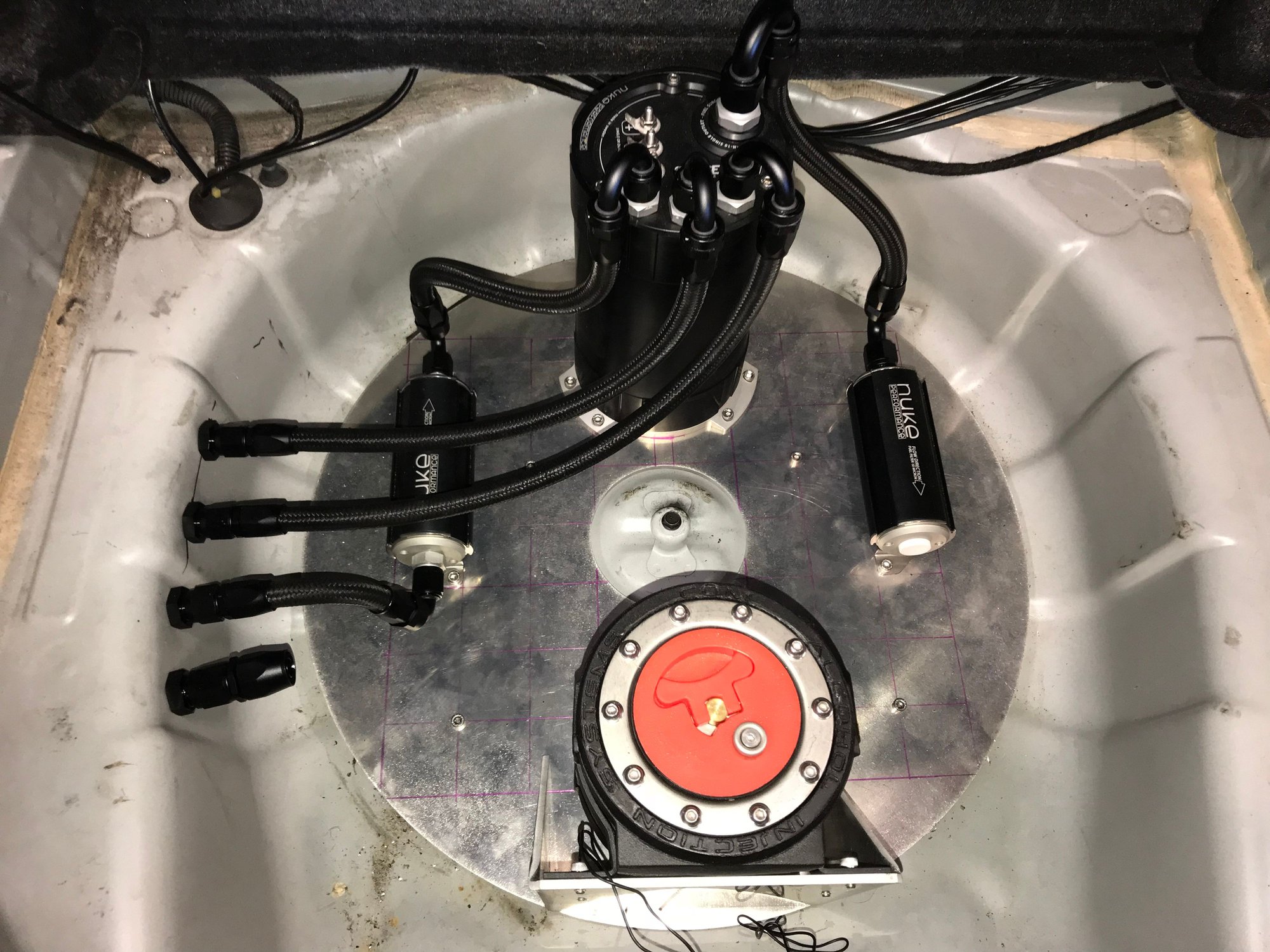

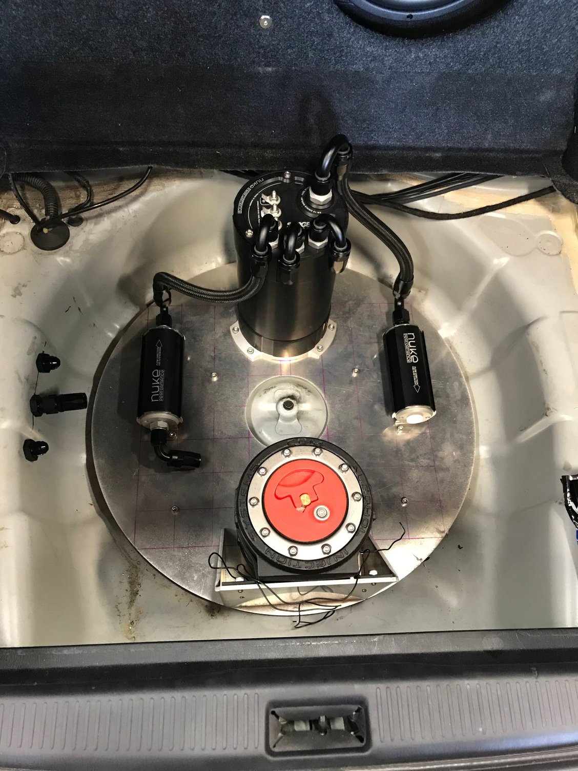

Got some work completed on the trunk setup. For some reason I didn’t get a photog of the finished setup but I’ve got an in progress of the install of the bulkheads for the fuel lines. Running a -10AN from the surge and -8AN lines into the surge. Plus drilled and tapped the mount for the water/meth setup.
Shawn finished all the -8 lines. Just waiting on a fitting (O-ring boss to AN) to finish the -10 line coming from the filter to the bulkhead.

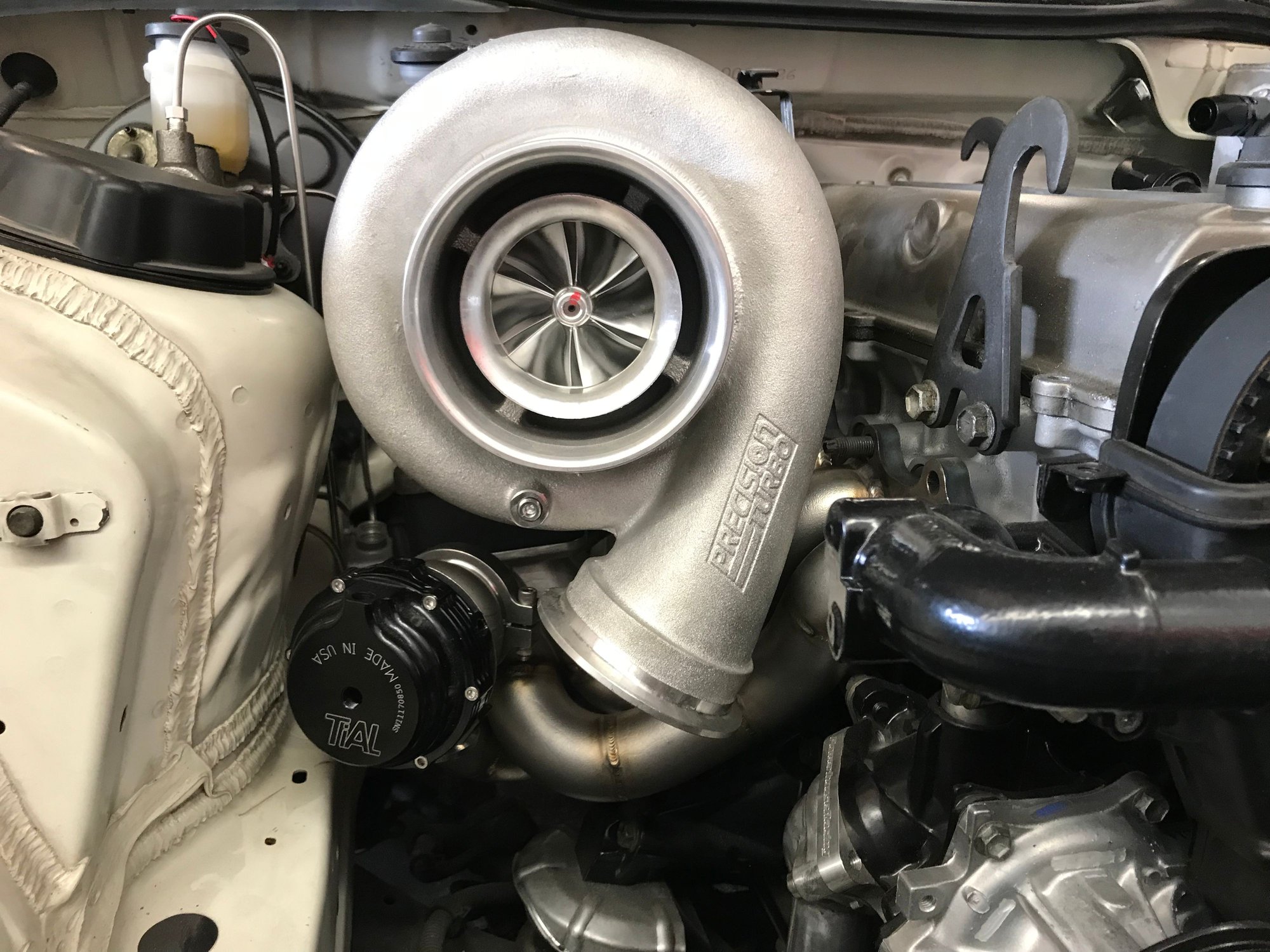

Turbo spacer arrived and somehow it makes the turbo look bigger when it is mounted now.

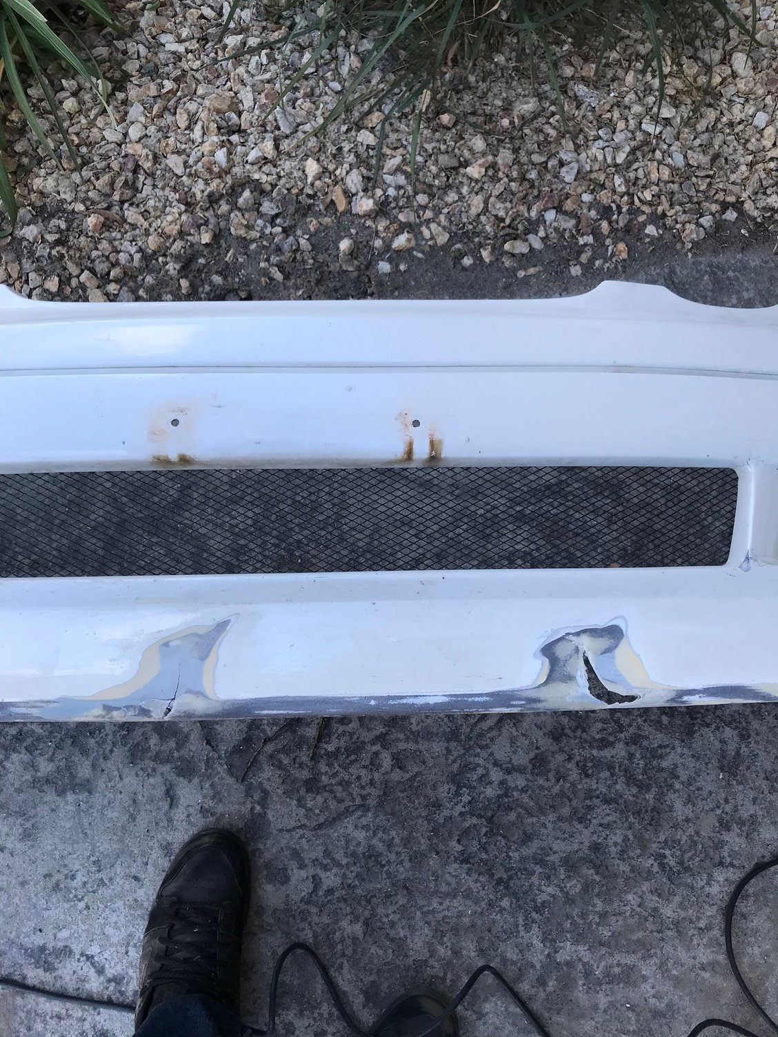

This gives us the clearance needed for the wastegate now. I took some homework home that I’m about to get started on. Took both bumpers home to do some fibreglass work on. Going to delete the left side exhaust hole on the rear bumper as I’m running 4” single. The front has a few repairs that needs to be done. So I’ll get those patched and sealed then primer and prep for getting the car wrapped. A bonus clip for you guys, Russ finished getting his Soarer back together and was getting it tuned afterhours. This is him on 10psi, precision 6265, 1.5JZ. Made 320rwhp. Didn’t stay to see them turn up the boost and the finished tune.

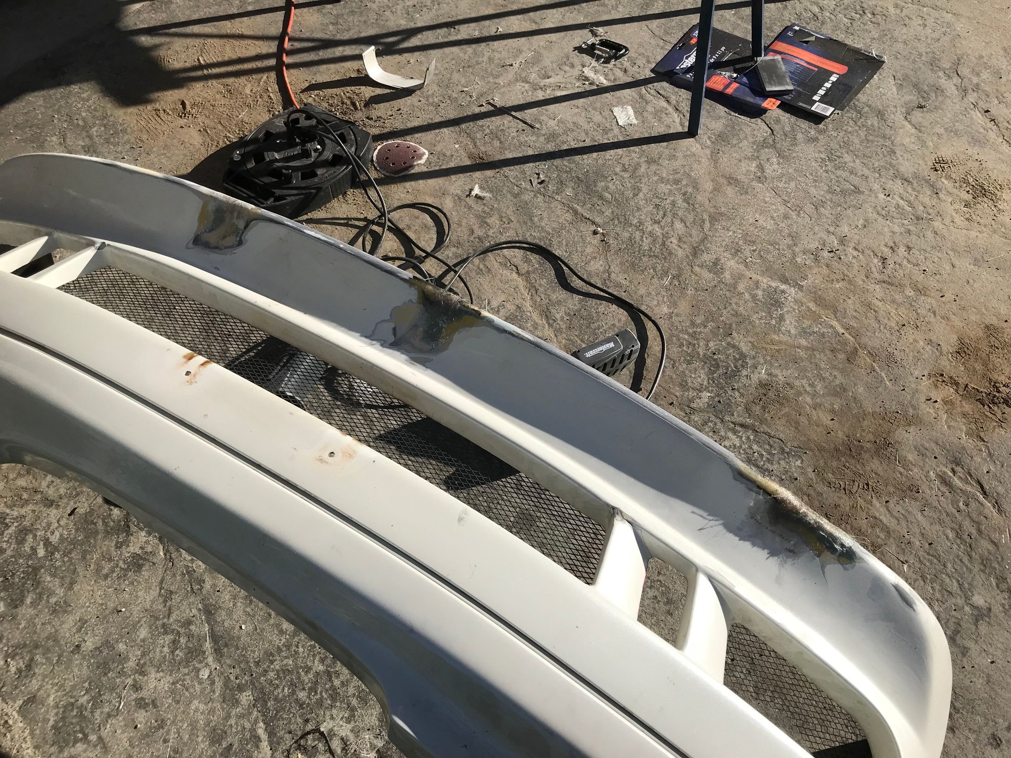

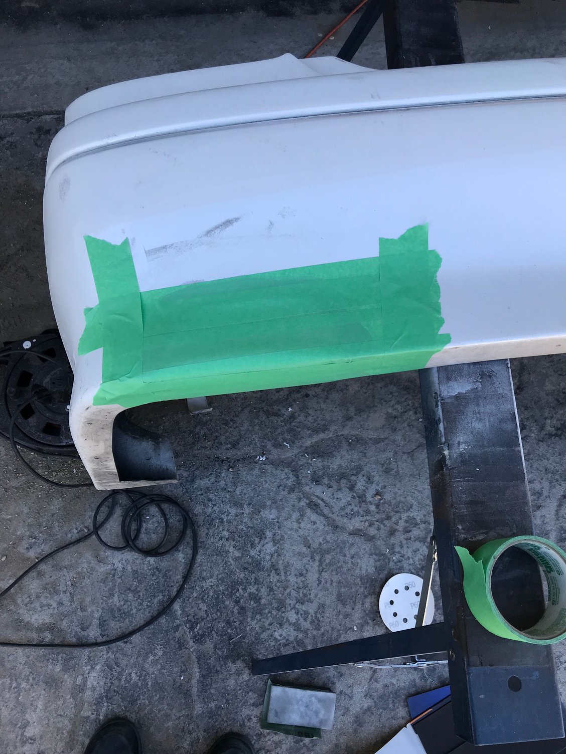

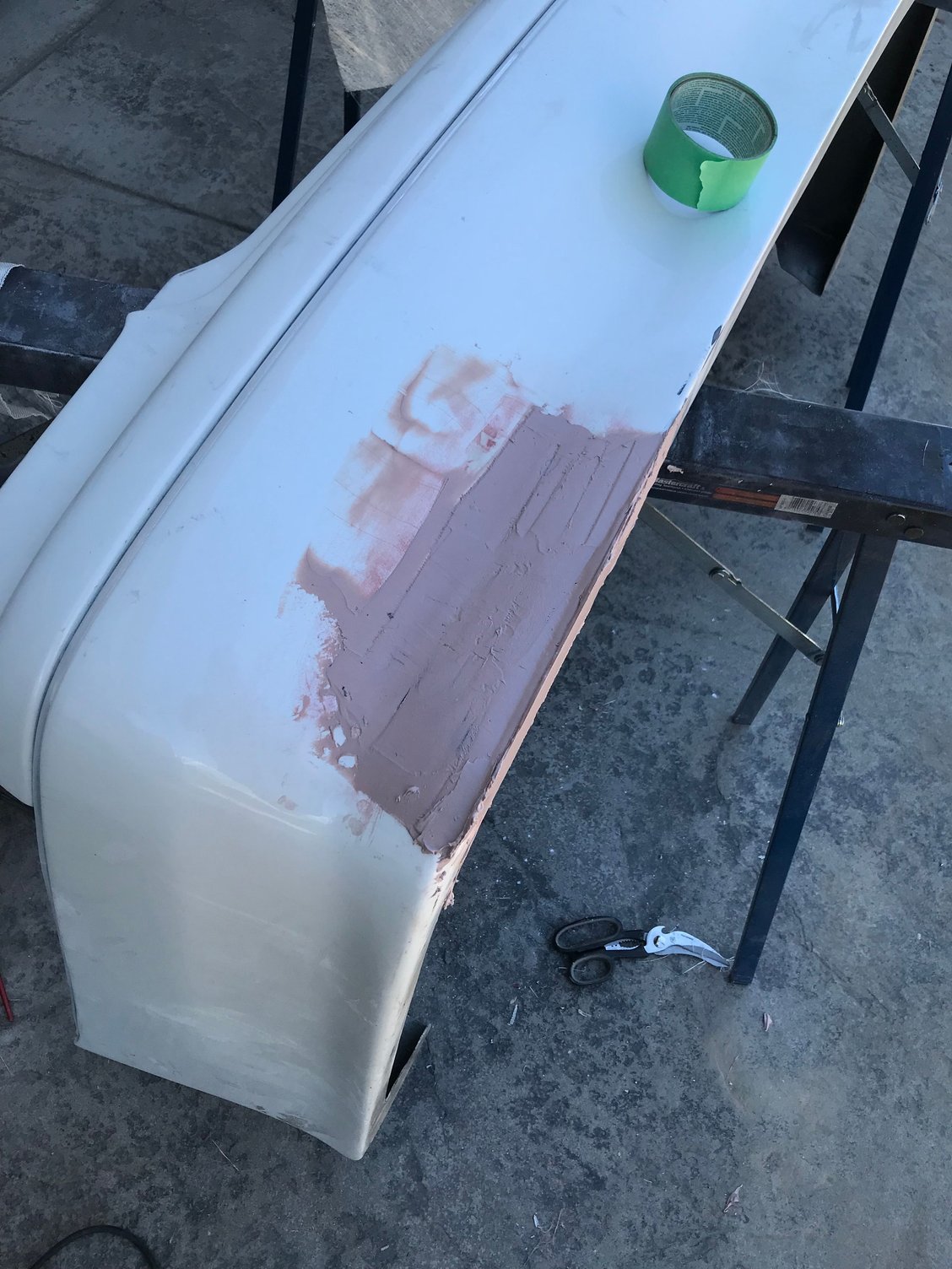

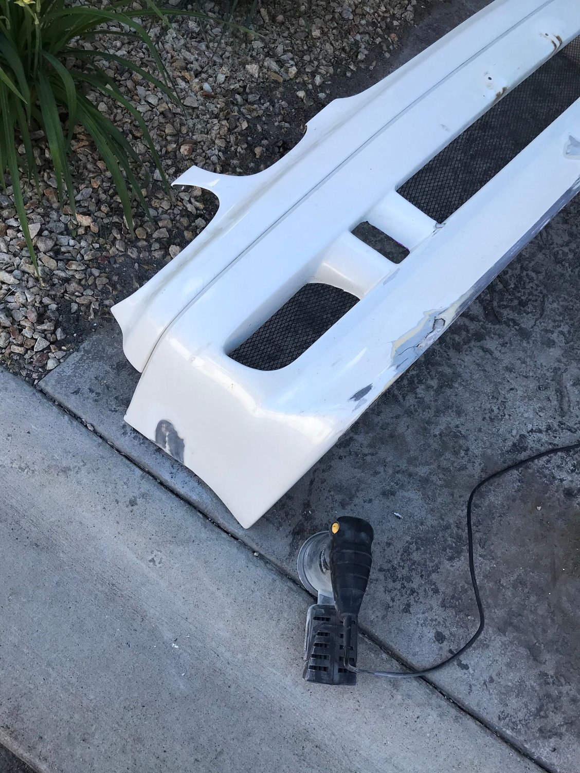

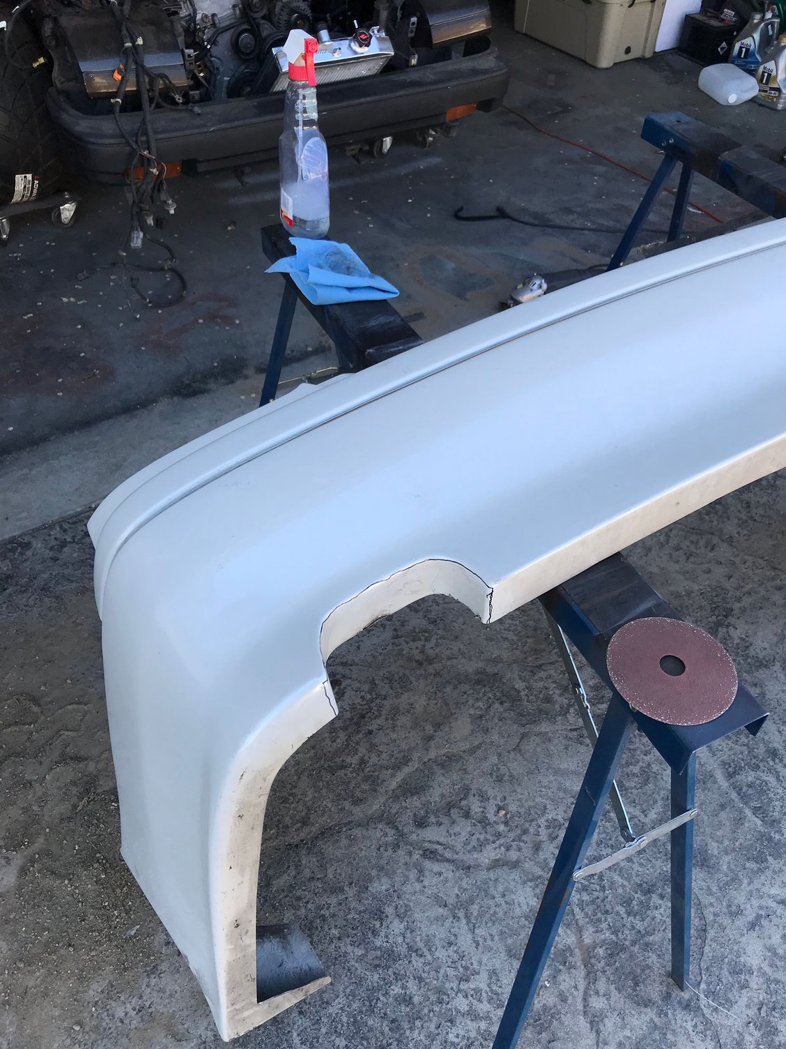

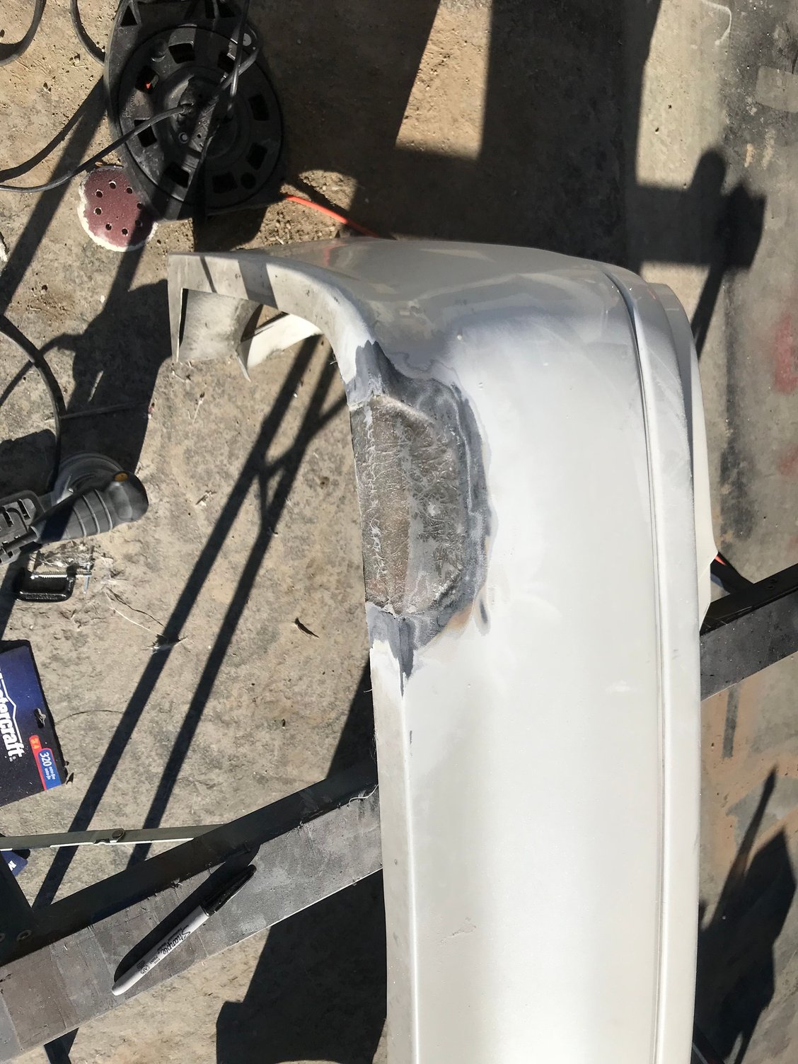

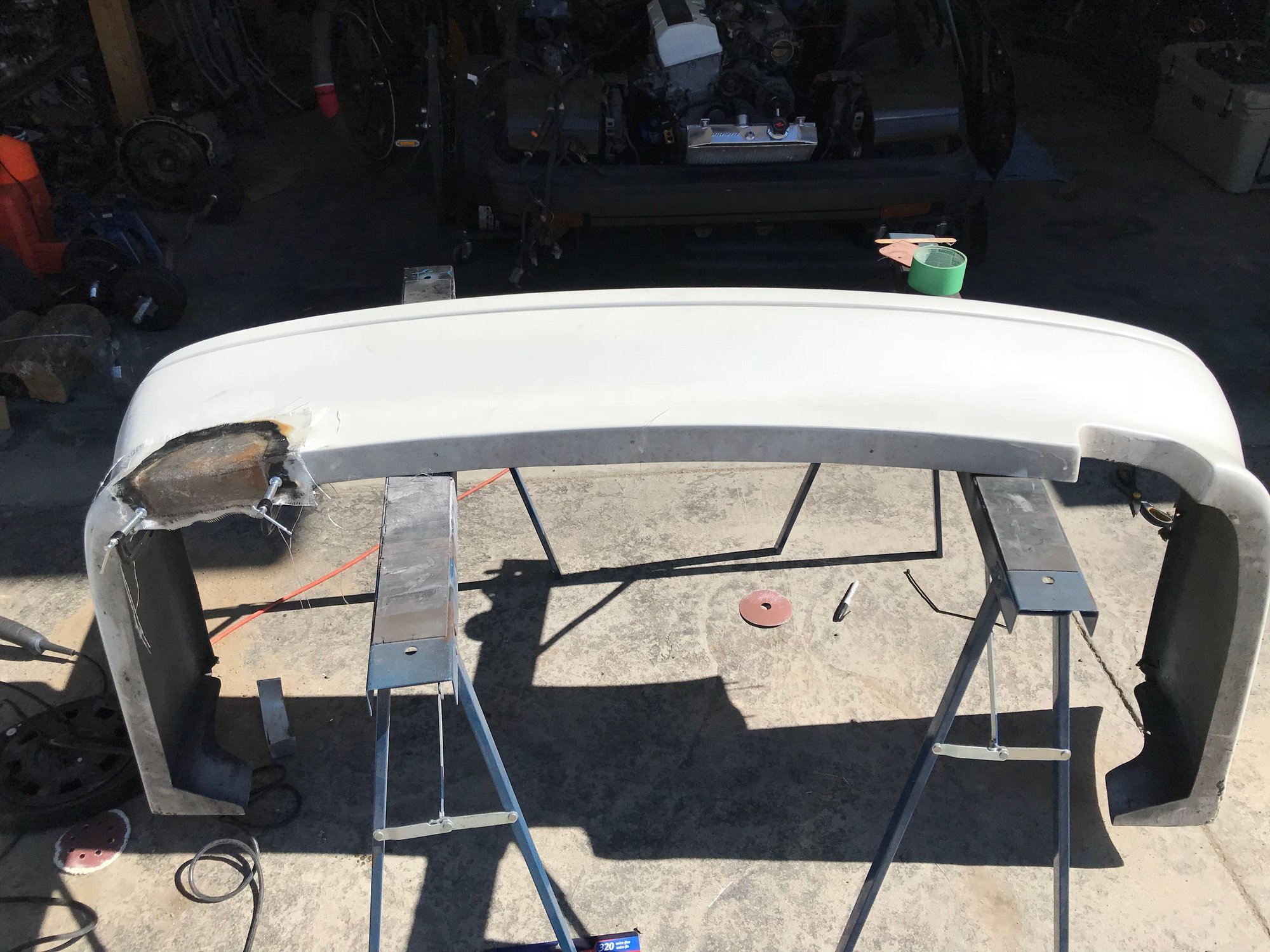

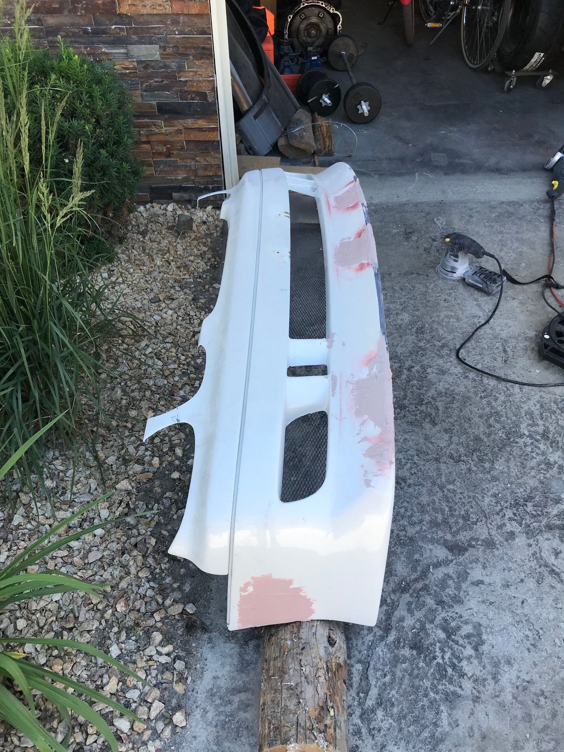

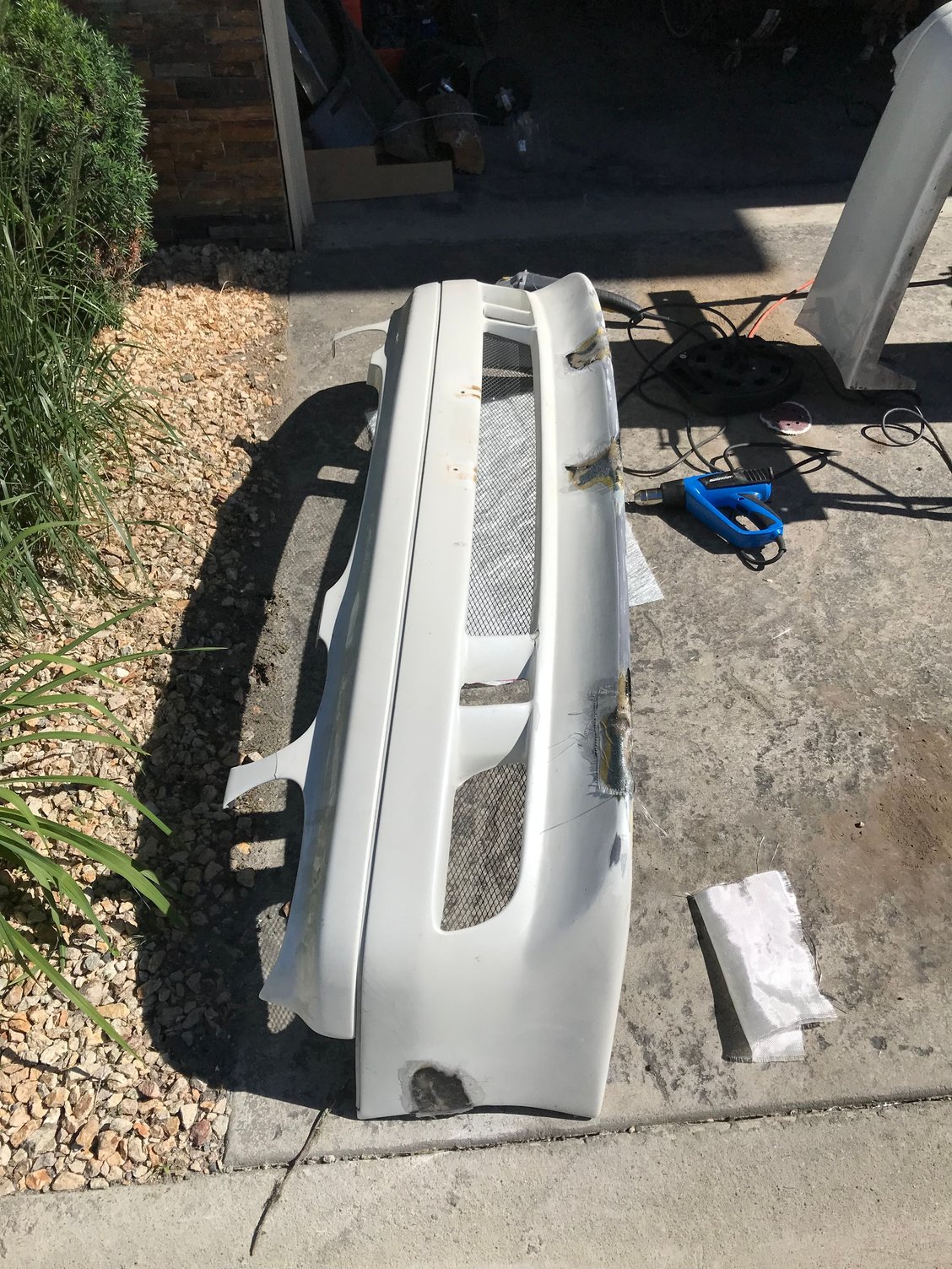

Well started the bumper repairs. First time doing fibreglass on one of my own cars. So took my time to try and layer the fibreglass as evenly as possible so I’d have less body filler in the end. Hindsight happened for sure lol. Probably made the rear bumper harder by doing the inside first. If I could do it again I’d do a layer on the outside to get the bumper body line set then do the inside layers for reinforcement. Doing it the way I did made it so I had to do some smaller strips near the bumper cuts to fill some indents. Turned out good. Have a bunch of sanding ahead of me to get the final shape but here’s some progress shots.
So now going to let these cure for a bit and hit the lake as it’s a beautiful day out. Always good to be productive and still have fun.Shaping and primer next.
Happy Father’s Day to all the Dads our there 👍🏼🍻

Completed to the best of my ability. I’m ok with the finished product and it will get a little bit more of a finishing touch by the pros before it gets wrapped. Overall a good experience on this one. Get your resin to hardener ratios on point and it’s more patience than difficult. Time to go toss them on the car.
