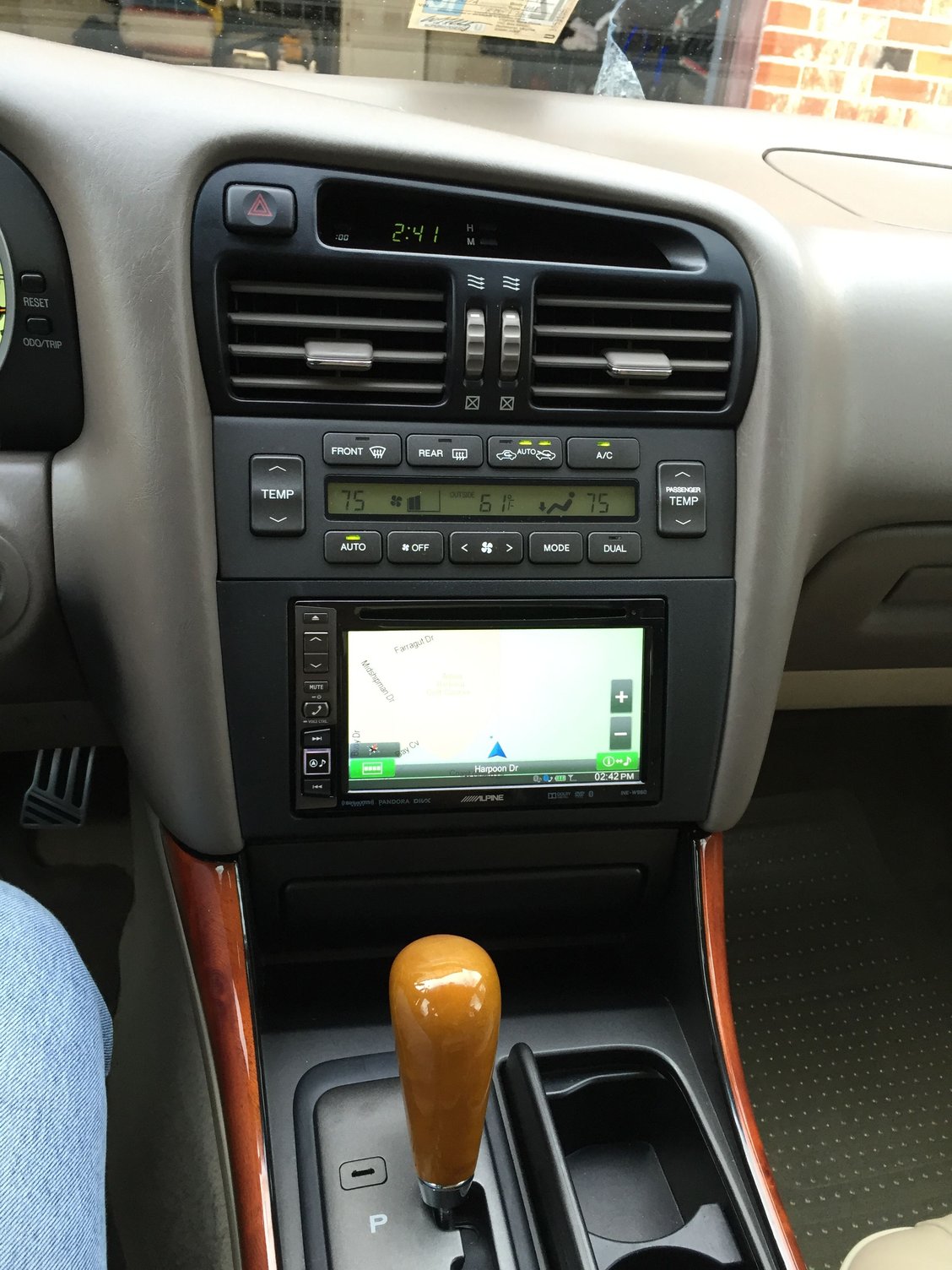

Default Custom Center Dash Vent
Got bored the past few months, tried to install the lip which was just a disappointment but that's what you get with replica eBay parts.
Anyhow, I've changed out the center vent module with a black one to match the radio and HVAC controller. I also swapped out the vent blades with the beige ones. I think it looks pretty trick, check them out!
Since I have to take apart the door panels to swap the speakers I'm going to do the power folding mirrors. I've figured out how to swap just the motor part allowing me to keep everything else by using the power of forum search! I'll post more as I go. Still trying to locate a set of Taiwanese door ecu boxes so it basically becomes plug and play well mostly.
