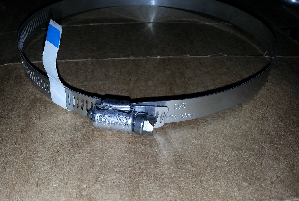

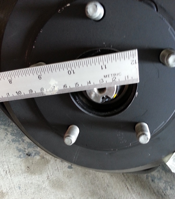

I've been troubleshooting a vibration above 65mph (105 km/hr) since I put my spacers on. After much research, troubleshooting, trial and error, I came to the root cause and figured out a custom durable solution.
PROBLEM: With the 5 mm spacers, the rims were no longer seated in the hubcentric ring. A ring adapter extension for the to 60.1 mm hub does not exist online, local car parts stores, no where.
SOLUTION: Made my own hubcentric ring extensions. Main material is from 6 inch stainless steel clamps (not the zinc-plated metal ones which WILL RUST). I'm able to cut two 188 mm length pieces from one clamp, and grinded down the width from 13 mm to 6 mm. Painted the pieces with black paint to give it an extra layer of protection (also painted my aluminum spacers for protection), shaped the strip into a ring, and put a tiny piece of duct tape to hold the two ends. Placed it on the existing hub which protrudes about 3 mm with the spacers on - enough for my new ring to hold on to. Then bolted the wheel on with the 5 lugs securely. Done! The force of the rim's hub holds the ring together onto the spacer for a secure fit. Ride is smooth, no vibration, and I get to keep my 5 mm wider stance of this beautiful car.
Attached Thumbnails corradoMR2's USB "The Lightning" Thread-ring0.jpg   corradoMR2's USB "The Lightning" Thread-ring1.jpg   corradoMR2's USB "The Lightning" Thread-ring2.jpg   corradoMR2's USB "The Lightning" Thread-ring3.jpg   corradoMR2's USB "The Lightning" Thread-ring4.jpg

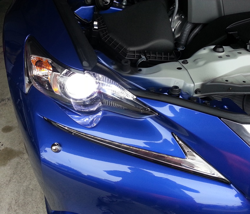

MOD UNVEIL: HIDPowerhouse 6000K HID bulbs installed (Fast shipping by the way!).
Stock 4300K bulbs look yellow in comparison (right bulb) in the first three pics.
