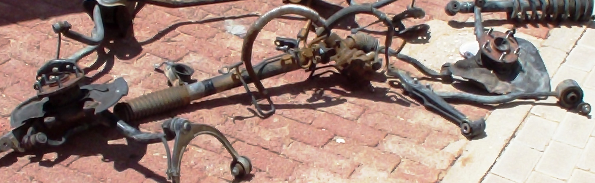

I have since stripped the front suspension from the donor car and am busy with the painstaking chore of removing the front suspension from my car. It's a mission when you have an engine in the way and years of grime to dig through.
No, I'm not complaining. I'm truly enjoying every step.

I know that the right thing to do is get new bushings and ball joints all around but I just can't afford them at the moment. The photo above shows the donor front suspension together with my front air struts. I will be rolling on stock springs and shocks for a while until I can source something else.
Is it safe to chop a coil off to lower the car a bit?
I have also been exchanging interior and body pieces that were broken or missing on mine such as some trim pieces, body mouldings and mirrors.
The mirrors were direct plug-ins. I just don't know if Series 4 mirrors will work in a Series 3. I removed the battery from my car so i cannot test all the gizmos I'm putting in until I put it back.
I struggled a bit to pull the upper ball joints but managed with a slightly modified gear puller. Zip ties are like duct tape. When all other tools fail...
