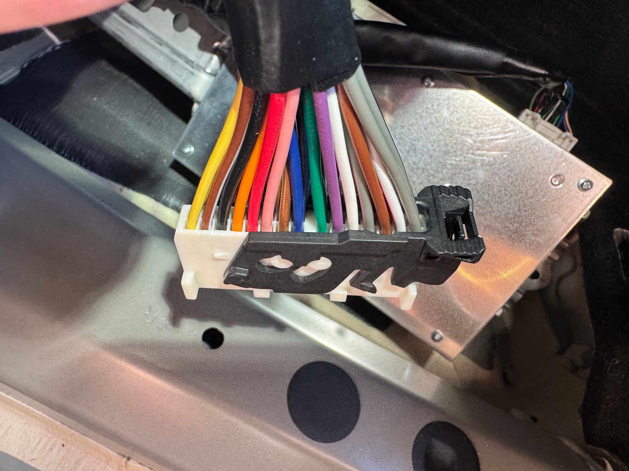

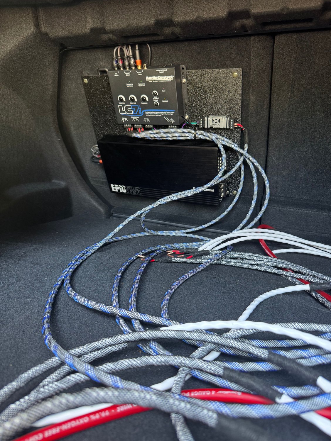

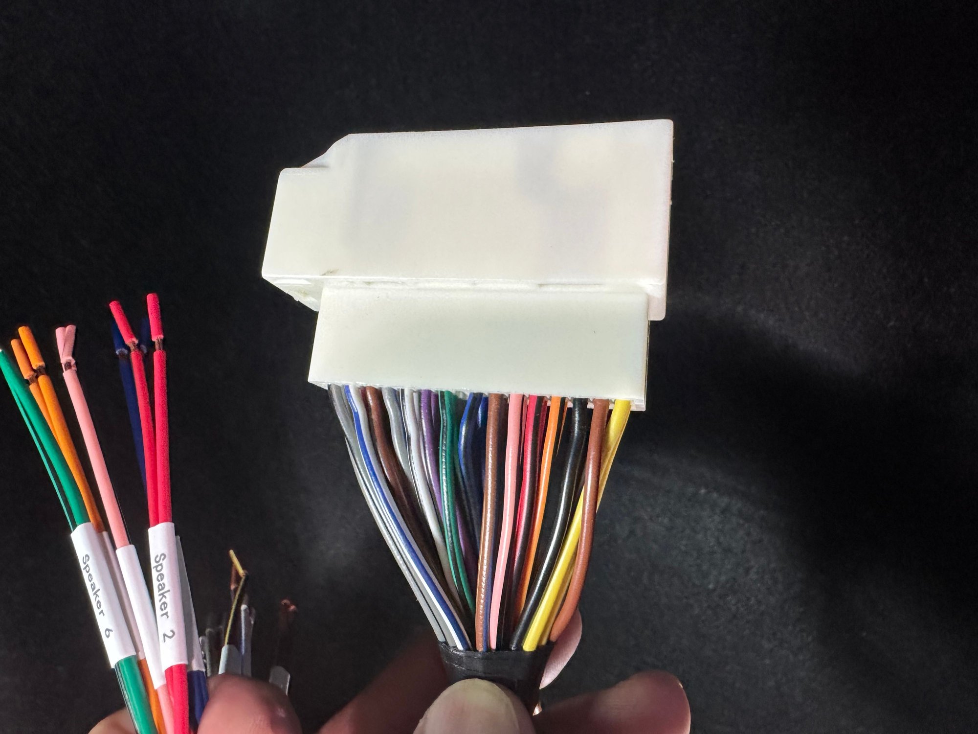

• I completed the speaker/subwoofer/amp/LOC install and I’m very happy how it turned out. Sound is immensely better than what it was. Highs, mid and lows all stand out now.
First thing I did was I swapped out the speakers. From there, I installed the amp and LOC. I used a PAC harness plugged into the output of the amp, which is located in the trunk. The hard part was figuring out which wires belonged to which speaker. But, eventually figured it out. Then ran the power line from the battery through the firewall, then ran it to the back amp. I mounted the amp rack to the backseat on the driver side.

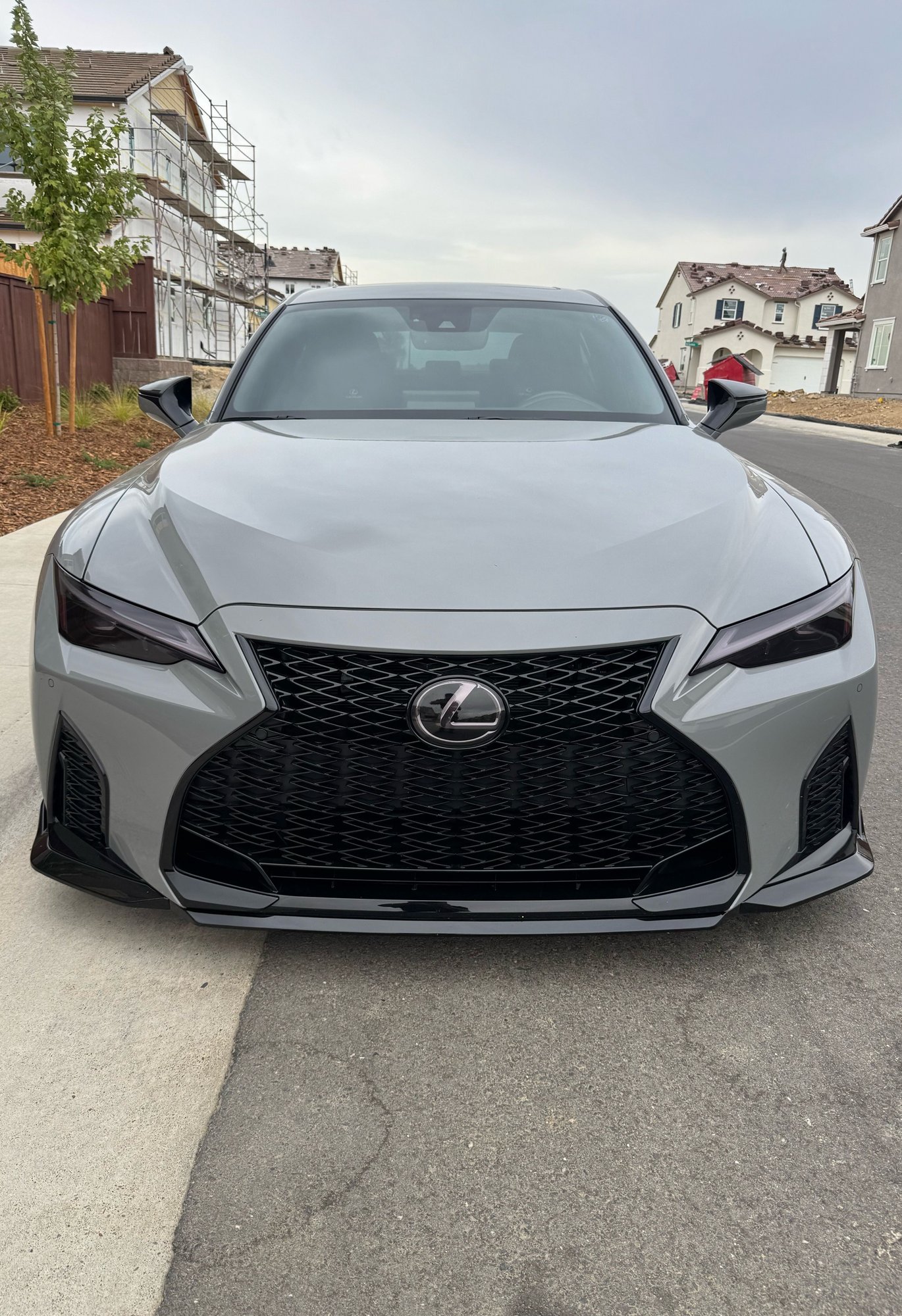

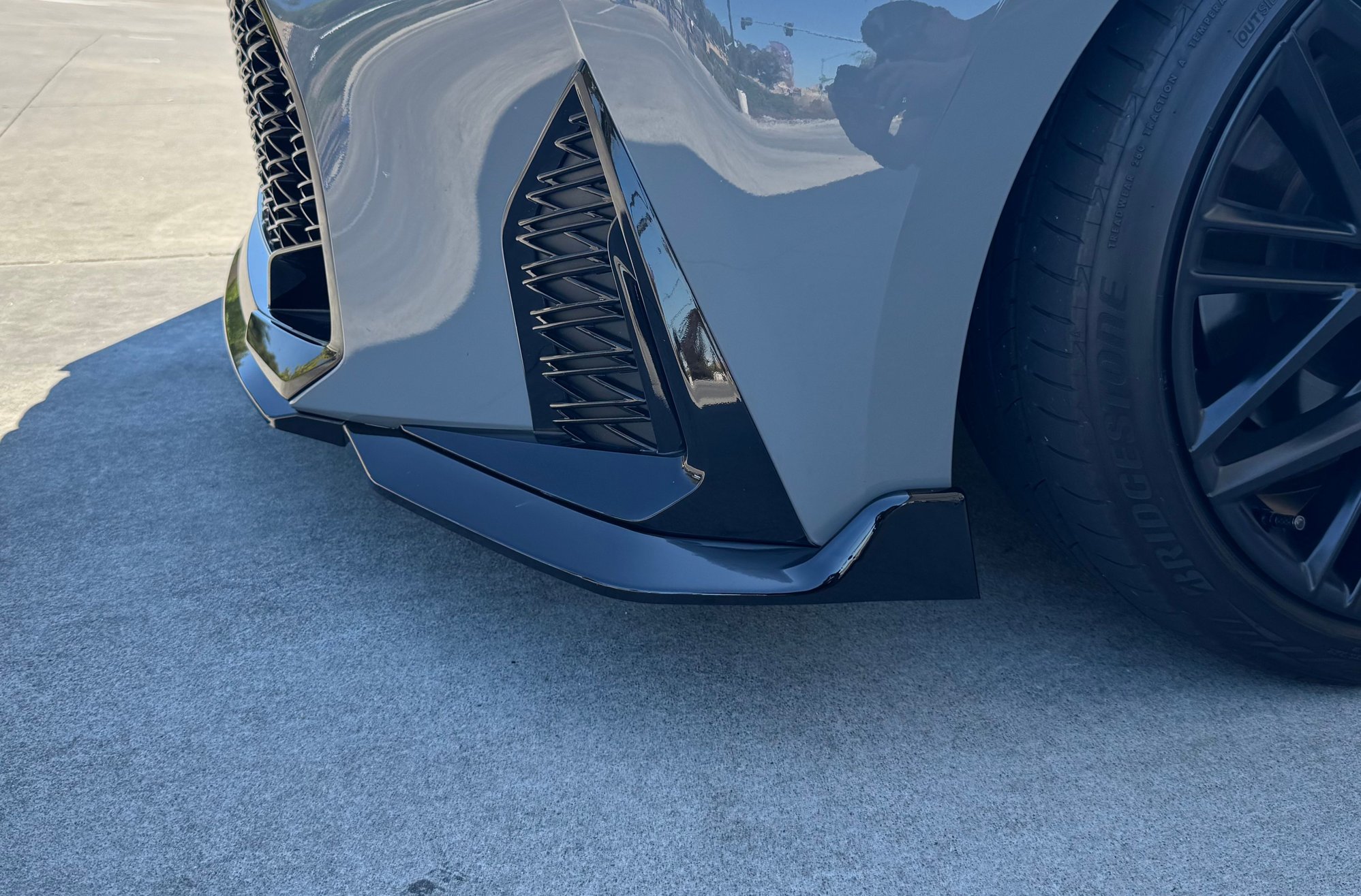

• Added a front lip. One of the cheapest that I could find but it’s the one that I like. They call it a V lip. Funny thing is I scrape on my driveway. I come in at an angle, but every once in a while, not enough of an angle. I like the way it looks. Thought about getting the carbon fiber and still may later.
• I swapped out my previous badge with the gray and black badge. I like it a lot. It goes well with the incognito.

The front lip looks great! It’s sporty but doesn’t look over the top. Do you have a side profile pic of the car? Did you have to drill to install it? I’m looking for one that I can use the factory holes/hardware.
Reply 0
Oct 28, 2025 | 09:23 PM
Quote: The front lip looks great! It’s sporty but doesn’t look over the top. Do you have a side profile pic of the car? Did you have to drill to install it? I’m looking for one that I can use the factory holes/hardware.
Here you go Bill. I did’nt need to drill, however, I used provided screws to fasten it to the underside of the bumper. Here’s a breakdown of how I did it:
1. It’s a three piece lip that you screw together. Hardware is provided.
2. Test fit to see where or if there were gaps. It’s a very tight fit.
3. The next step after test fitting, I used alcohol under the bumper where the lip would stick and the top of the lip to remove oils and grime.
4. I used 3m double sided “extreme” tape on the top side of the lip. I attached it far enough away from the edge so that it was not visible where the lip meets the bumper. I peeled about 3 inches of the red vinyl from the tape away to use as a tag so after I attached it, I could then peel away the vinyl and press up into the bumper to help it stick better.
4. After attaching the lip to the bumper, I then used the provided screws to secure. If memory serves me correctly, there are indeed holes in the lip. These holes line up where the oem clips that keep your undercarriage liner on. You’ll pop out those clips, line up the holes from the lip and then reinsert. When you open the link below, you’ll see the holes I’m referring to. I would not recommend just using the clips.
Super easy install. It cost me $60 but I ordered it from Temu I think. I thought why not since it was so cheap. I really liked the style and quality is okay. It lowers the front end about an inch, that’s an estimate. They have the same one on Amazon for $93 https://a.co/d/d5aQL3n. I might buy the real carbon fiber version later, $260 but we will see.
