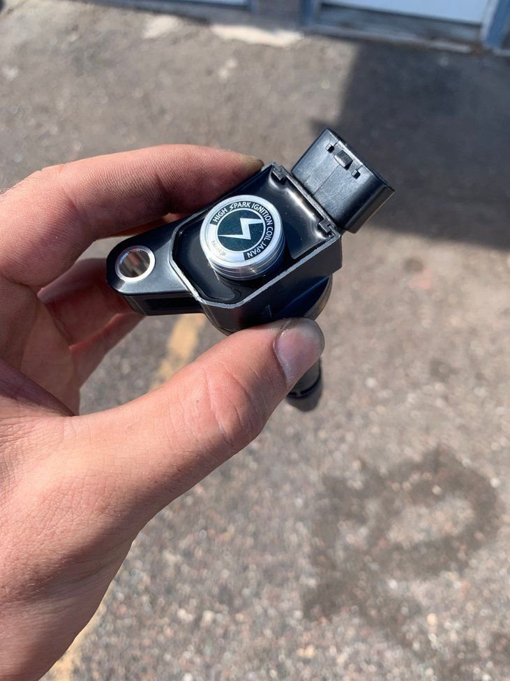

High Spark, Premium Coil Packs
  • Purpose/Reason for the Upgrade: To enhance ignition reliability and optimize combustion efficiency. These premium coil packs provide a stronger, more consistent spark, which can improve performance, responsiveness, and overall engine smoothness. These came highly recommended by my tuner tunedbyloi@gmail.com.
  • Performance & Driving Experience: After installation, the car demonstrated slightly smoother idling and noticeably enhanced throttle response. Acceleration felt more responsive, and overall, the engine ran with greater consistency. This was done together with the NGK 94122 spark plugs.

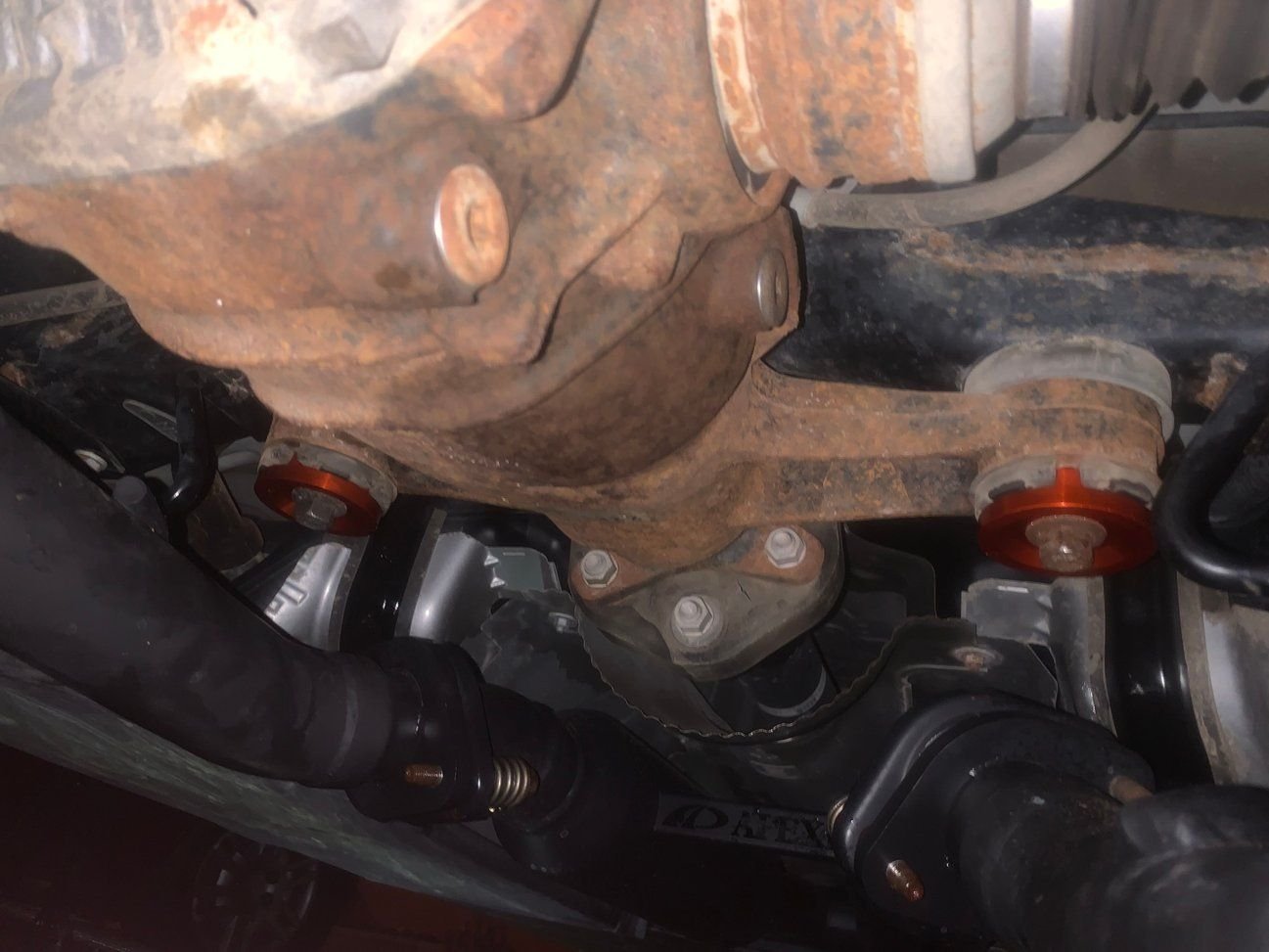

Super Now Differential Lower Bushing Collars
  • Purpose/Reason for the Upgrade: I installed the Super Now differential collars on the lower part of the differential bushings to reduce the play in the OEM rubber bushings without fully replacing them. This small but effective modification enhances power delivery, making it more immediate and consistent, aligning with my goal for a more performance-oriented driving experience.
  • Installation Process:
    • Preparation: Due to some rust on the bolts connecting the mid-pipe to the axle-back flange, I chose not to disconnect them. Instead, I removed three exhaust hangers from each side, which allowed the entire pipe to drop down a few inches for access to the bolts securing the differential.
    • Collar Installation: The installation process was straightforward. The Super Now lower collars are designed to fit over the factory rubber bushings, reducing slack and compressing the bushings without needing to replace them.
    • Compatibility with Upper Collars: I initially inquired with Top End Motorsports about pairing these collars with the Think Design upper collars. However, it’s not advisable to use both, as the Super Now collars already compress the bushings significantly. The upper collars would likely increase metal-on-metal contact, creating more noise without effectively reducing slack.
  • Performance & Driving Experience: The impact of these lower bushing collars is substantial. Power delivery feels far more immediate and progressive, with improved predictability under throttle. There is also a noticeable reduction in noise under wide-open throttle. At low RPMs with partial throttle, I experience a slight increase in driveline noise within the cabin, but this is minor compared to the benefits. Overall, the consistency and responsiveness of power delivery have improved, giving the car a more cohesive and performance-focused feel.
  • Conclusion: The Super Now lower bushing collars have transformed my car’s drivability, making it feel more cohesive, luxurious, and responsive. For anyone looking to improve power delivery without sacrificing comfort, this upgrade is a worthwhile addition. Top End Motorsports provided excellent customer service throughout the process, addressing my compatibility questions and ensuring a smooth experience.

        • I had to remove the entirety of the rear member having jacked up for support. This gave me very easy access.
      • Inserting the collars into place, ensuring proper alignment.
        • Dont forget lots of copper grease beforehand.
      • Retightening the bolts to the manufacturer's torque specifications.
    • Time Required: The entire installation took under three hours and can be considered a DIY project for those comfortable with working under the car.
  • Performance & Driving Experience: The impact of the Spoon Sports subframe collars is remarkably significant:
    • Improved Responsiveness: The car responds more immediately to steering inputs, making driving feel more direct and engaging.
    • Enhanced Stability: There's a noticeable increase in stability during cornering and over uneven road surfaces. The car feels more planted and composed.
    • Linear Load Distribution: The collars help in distributing dynamic loads more evenly, resulting in smoother transitions during acceleration, braking, and turning.
    • No Negative Effects: Impressively, these benefits come without any drawbacks. The ride quality remains comfortable, with no increase in harshness or noise. In fact, the car feels even more luxurious due to the improved solidity.
    • Overall Feel: The car now exhibits a higher level of refinement, making daily driving more enjoyable and spirited driving more rewarding.
  • Conclusion: I cannot recommend the Spoon Sports subframe collars enough. This modification offers substantial improvements in handling and driving pleasure without any compromises. It's a must-have upgrade for anyone looking to enhance their vehicle's performance and feel, whether for daily commuting or enthusiastic driving.
