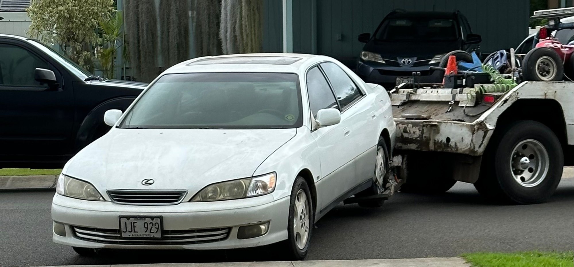

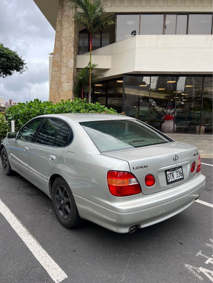

Enter, Millennium Silver Metallic 2000 GS 400 with 100k miles, from off-duty used car dealer. Apparently this car had been through 11 owners, yikes!!! But after driving the car, looking it over up down side to side, I couldn’t help but wonder why, so I jumped. Jumped to hand over $4000. How could I pass up a 100k mile GS400 that seemed to have no issues, besides a samurai sword shifter, a chunk missing from the A/C vent and border, very worn front seats, a mysterious ticking ignition coil, P0446 and P0441 best friends, and a two-face Harvey Dent appearance (scuffed paint repair on the passenger side fender and rear quarter panel)? I’ll find out the answer soon once I find time to pop the engine cover off and do an oil change! Here’s the next star of the post:
and here’s this proud GS400 papa’s twins sitting all cozy together:

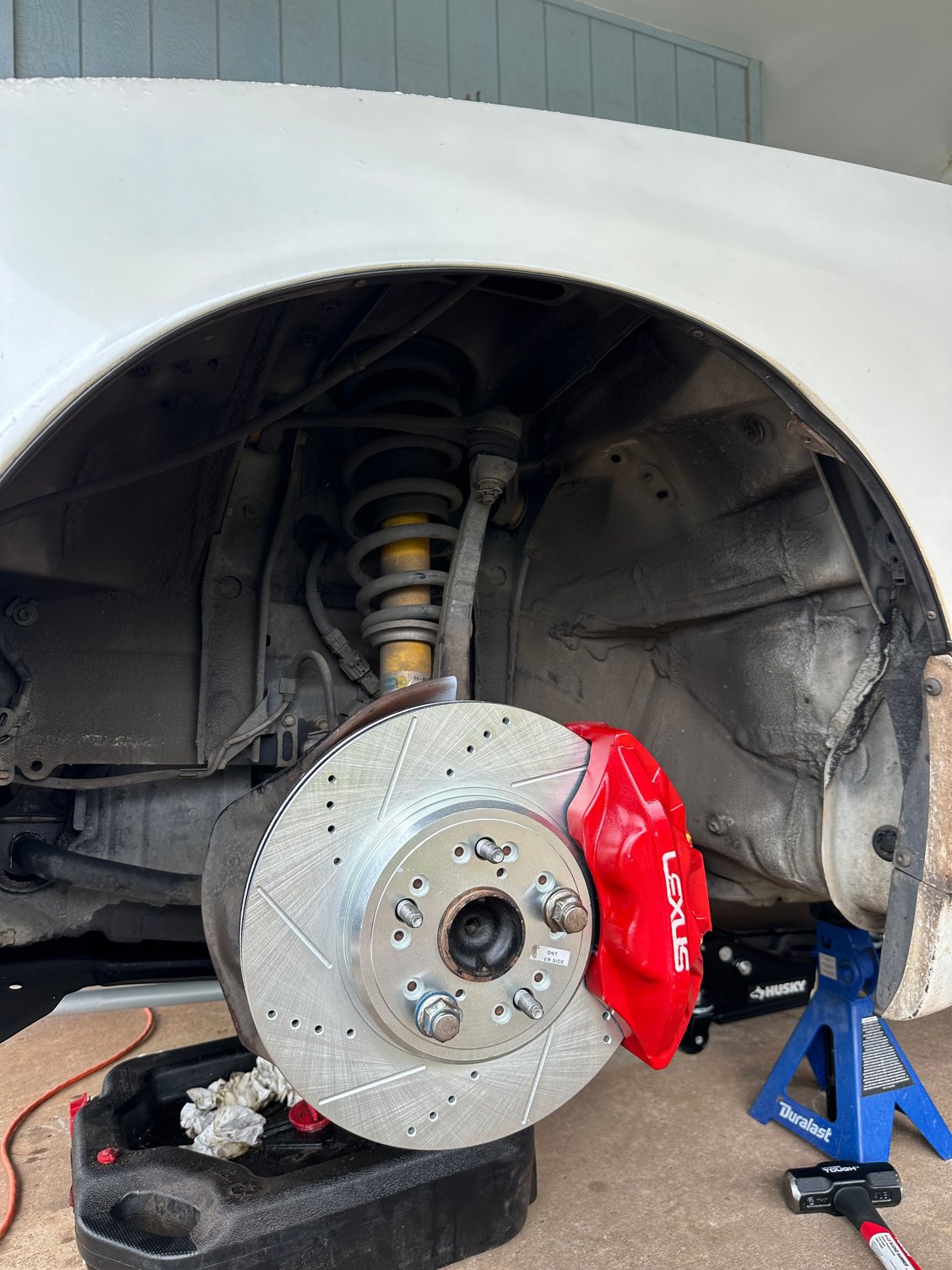

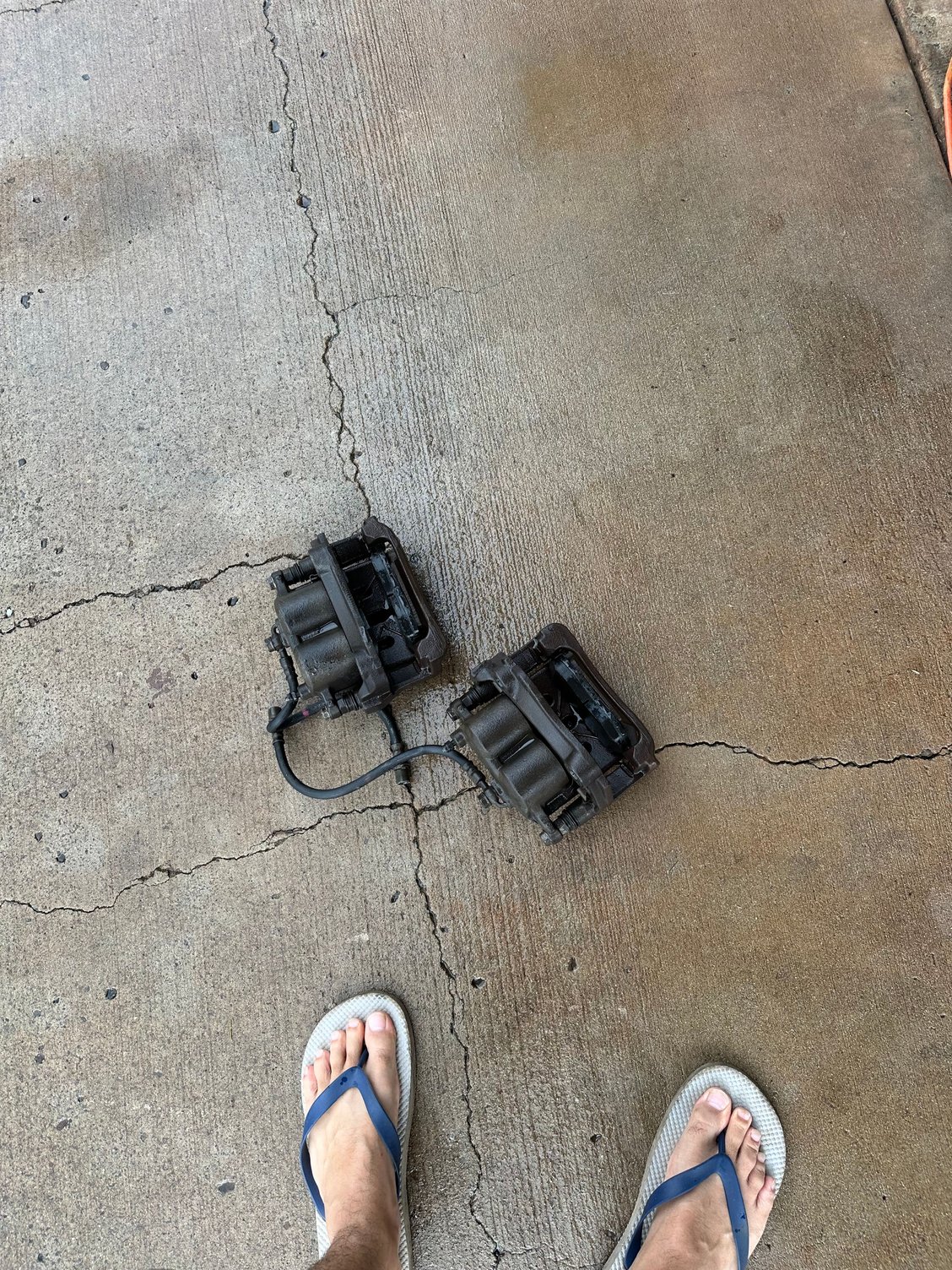

New brakes alert someone said the LS400 brakes don’t fit if you have 18” IS350 wheels, but they do.
Car also sits a little lower thanks to the RCA, which is nice.
Apparently you have to shave your brake line bracket in order to fit upgraded stainless steel lines. I tried grinding the hole to open it up enough for the stainless steel nut to go in but it just wasn't working out. I'm pretty sure that's also what's causing a clunking/tapping sound that comes and goes. Unless I forgot to torque my lug nuts again but I drove for about 15 miles last night and my wheels didn't fall off so they must be torqued.

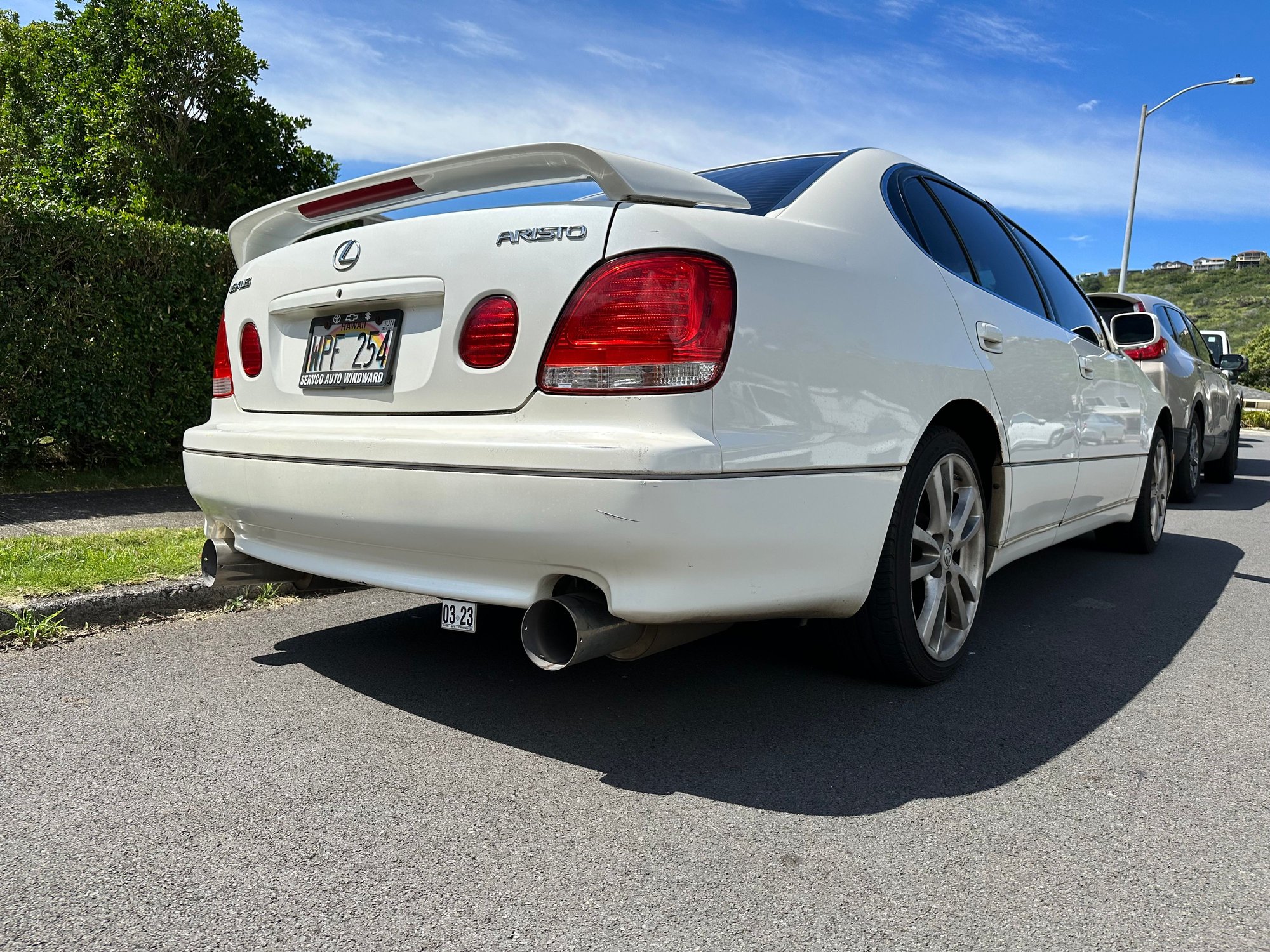

Progress update. I was able to put the Cerberus II’s on my white GS400. Took 25mm worth of spacers to clear the LS400 calipers with a mid lip. Replacing the oem wheel studs was pretty simple apart from replacing the parking brakes. I highly recommend the wheel stud installation tool. I have no idea how you’d do it without that.
Then I threw the old IS350 onto the silver GS and I have to admit those wheels work pretty well on the GS. Too bad they’re 18”. I really wish I knew how small 18” wheels would look on the GS. Thankfully I got 45 series tires, so at least it fills the wheel well a decent amount.
White GS400:
Silver GS400:

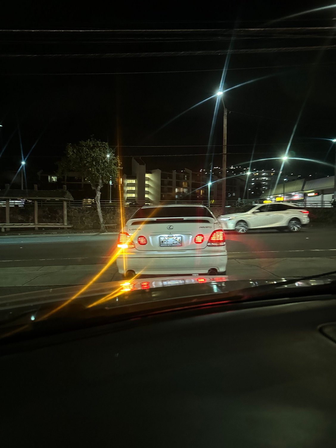

It looks like the white car came with some JDM LED taillights that are much nicer and way more valuable than a set of DEPO’s. And the trunk mounted taillights only come on with the headlights and not the brake lights. Although it seems like they should come on with the brake lights. It looks pretty good the way you have it now.
