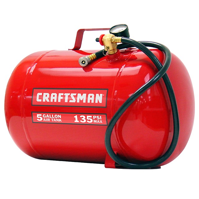

kinda off topic, but I saw some dude using this as their tank: I guess if it works then why not right ?

a tank is a tank as long as it can hold the pressure and vibration in a car.
most shop tool tanks as for the 120 psi range while suspension is in the 175-200 range. part of the reason buying a water trap is a pain as it is not rated for high psi.
Biggest problem with this tank is it is bulky and not made to be installed nicely so it takes up way to much room.
adding this tank to a car will not work as the electric motor is made for the cycle of 120 volts and not 14 volts dc.
The way i mounted my 5 gallon tank was perfect for my since it keeps the tank high under the parcel shelf almost perfectly behind all the original carpeting and the pump is at the side under the floor carpet where i can drain the trap. I have lost zero room unlike most others with a similar setup.

u can convert it to 14 volts ya ?
