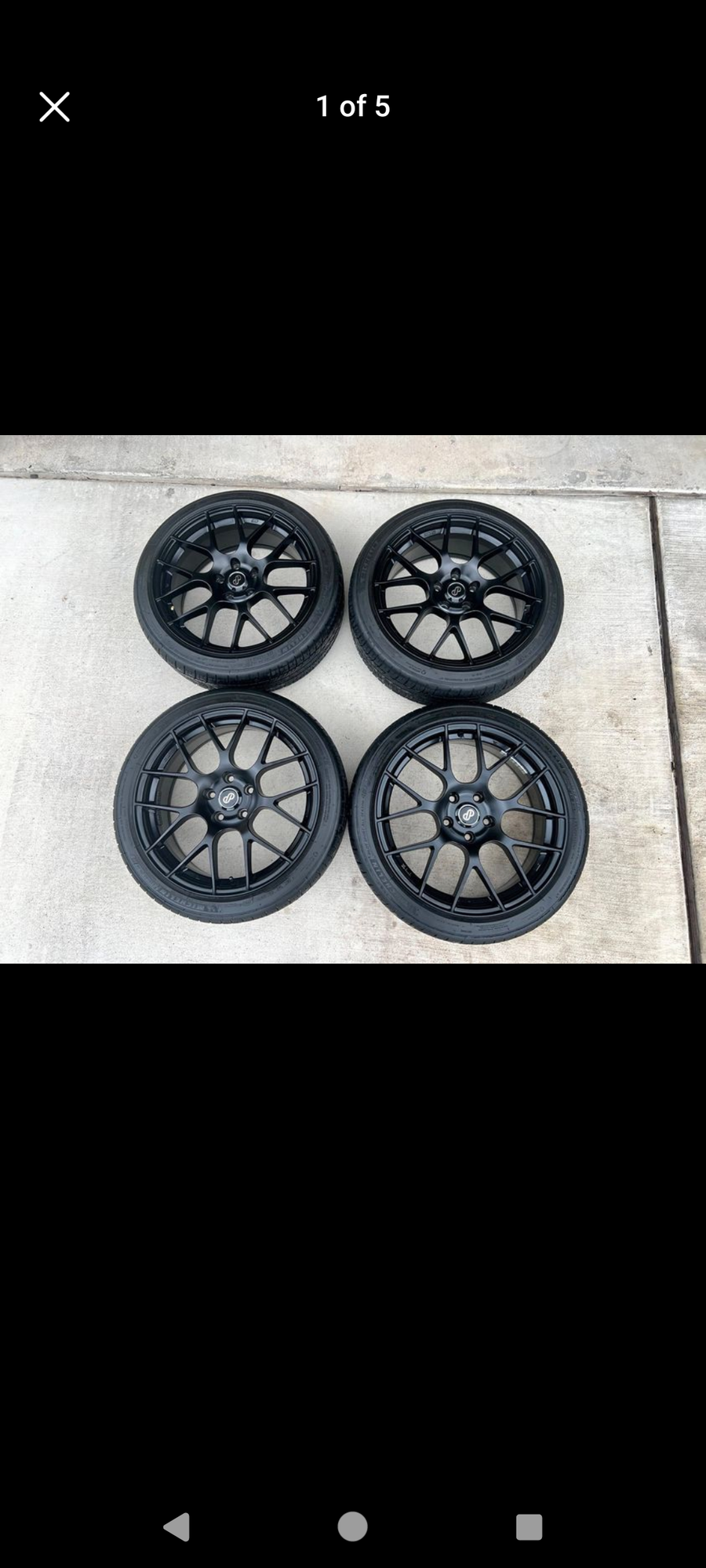

Default Will new wheels fit?
Found a great deal on a new set of 225/40/18 Michelin tires on 18x8 enkei wheels. Tried googling but couldn't find a concrete answer on it these would fit my 2019 UX 250h. Any input would be appreciated. Thanks.
