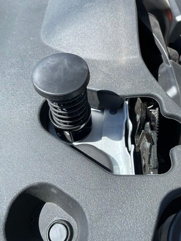

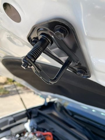

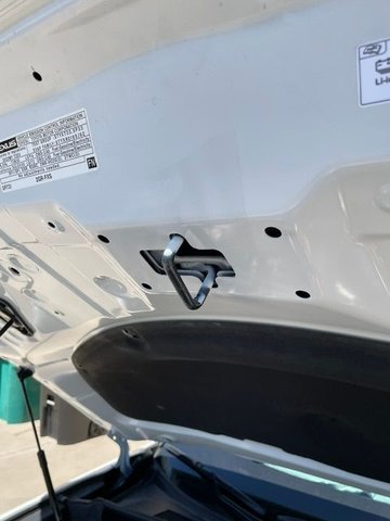

While my 2025 TX 550h+ (July 2025 build) has spring loaded stops mounted to the car that push up against the hood when it is closed, these stops are not adjustable. While they can be turned, this does nothing. Mounted to the underside of the hood on each side, are two strikers that catch on the latches on each side. There is also a main striker in the middle.
This is one of two strikers on each side. I think it can move on the one side and the other being spring loaded can be adjusted to raise and lower this a bit.
Thius is one of thew two spring stops that push up on the hood. Everyone seems to say they can turn and adjust the height of thse. But mine do not adjust when turned. I measured the height and even dozens of turns did nothing.
This is the main striker in the middle of the hood.
I recently had the TX in the shop for something else, and brought up that the hood stuck up a bit form the body. The tech said, "oh, we'll just need to turn those round things to adjust". When I later picked up the car he said, he was surprised to find those round things are different than other Lexus models and they did not adjust.
Possibly Lexus made a change and not all TX years and models do it the same way.
Anyway, just thought I'd show how my TX hood latches
