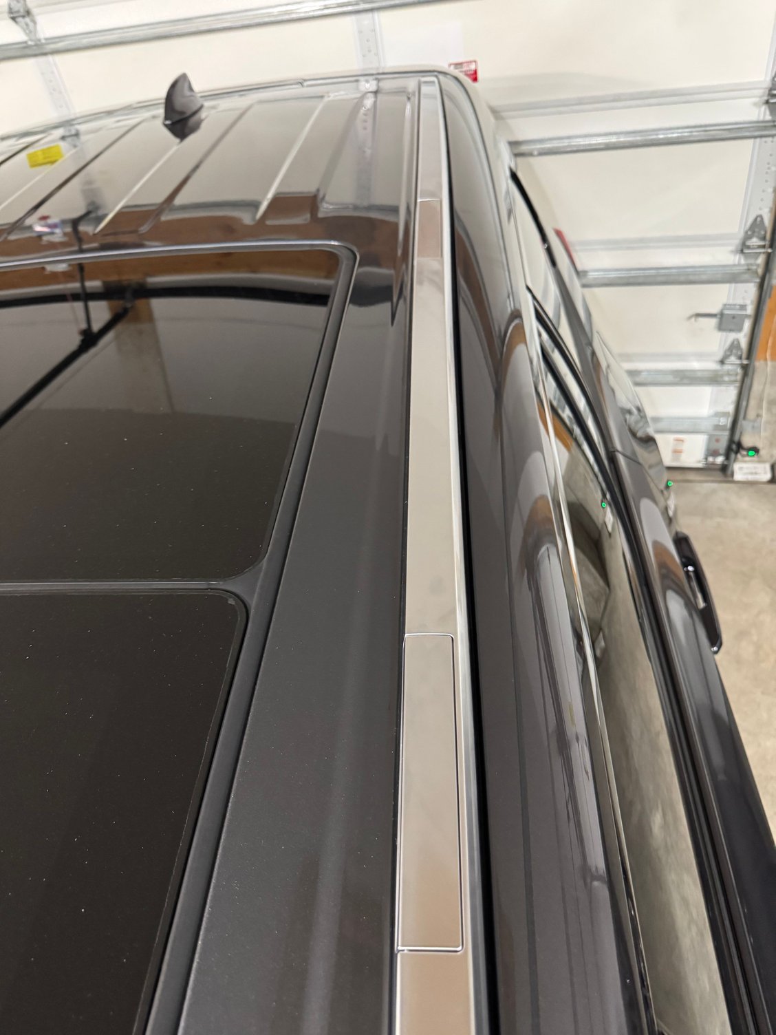

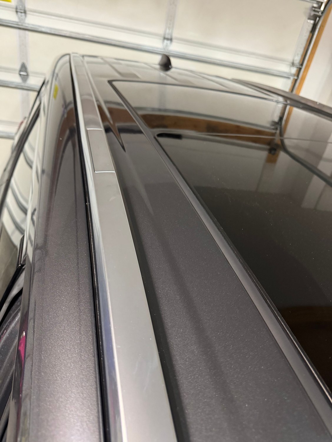

Just got a brand new tx350 and noticed a "slapping" noise with high cross winds. I took my car in for service abd gut a loaner. Same noise only louder. Investigating believe i found the issue although not the solution. In the roof rails the are some " plastic caps " that cover the bolts where i believe cross bars would attach. They sit in there loosely and i highly suspect they're rattling as they get buffeted by the wind. Thoughts?

I don't have then either although I think of i did it would solve the problem. It's the plactic caps that sit loosely in the rails covering the crossbar attachment spots.

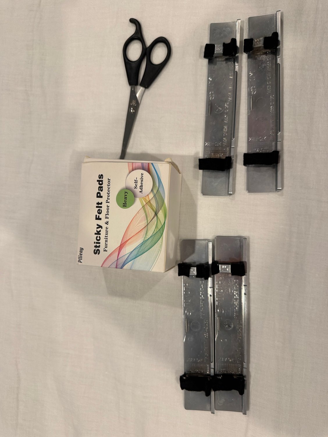

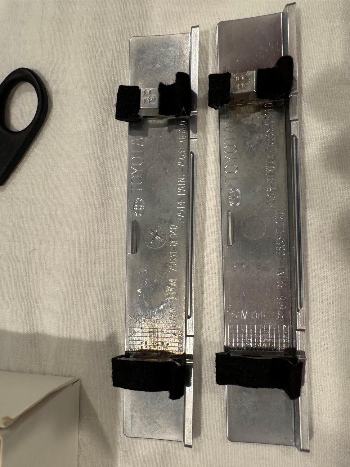

Thank you very much to everyone who commented and helped expand on this topic — I truly appreciate it.
After spending some time checking things over on my car, I was able to resolve the rattle, although I can’t say with certainty which fix made the difference.
One thing I noticed right away was when I was drying the car with a leaf blower — every time air passed over the license plate, it would rattle. It turns out the dealer hadn’t tightened it properly. I secured it, which already seemed to help.

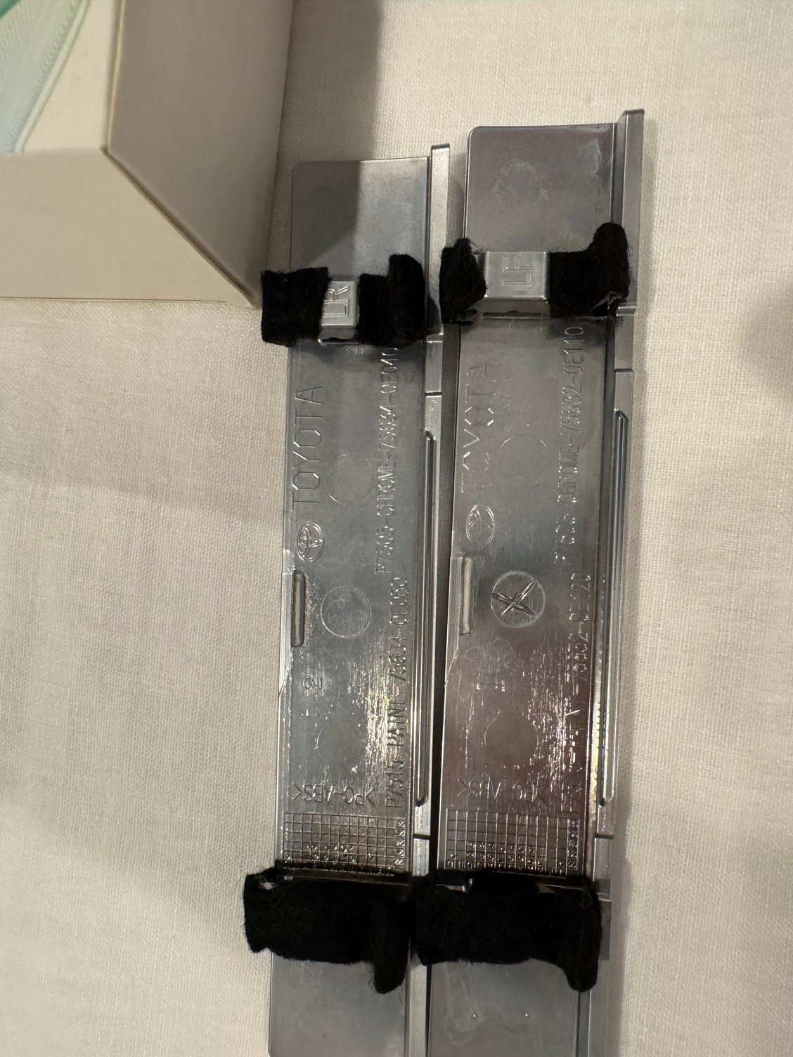

At the same time, I also removed the covers from the roof rails and reattached them using felt tape.
Since then, I haven’t heard the noise at all — and we’ve already had some strong wind, so it seems like the issue is resolved.

Genius! One of the 4 caps were loose and it was in the area where that sound came from… I used felt tape on the cap’s legs and now it’s very tight!
Driving around so far it seems to have fixed it!
Update: After driving around for an additional 2 total hours in a windy day in the setting to cause the noise, THE ISSUE IS FIXED! Thank you!
