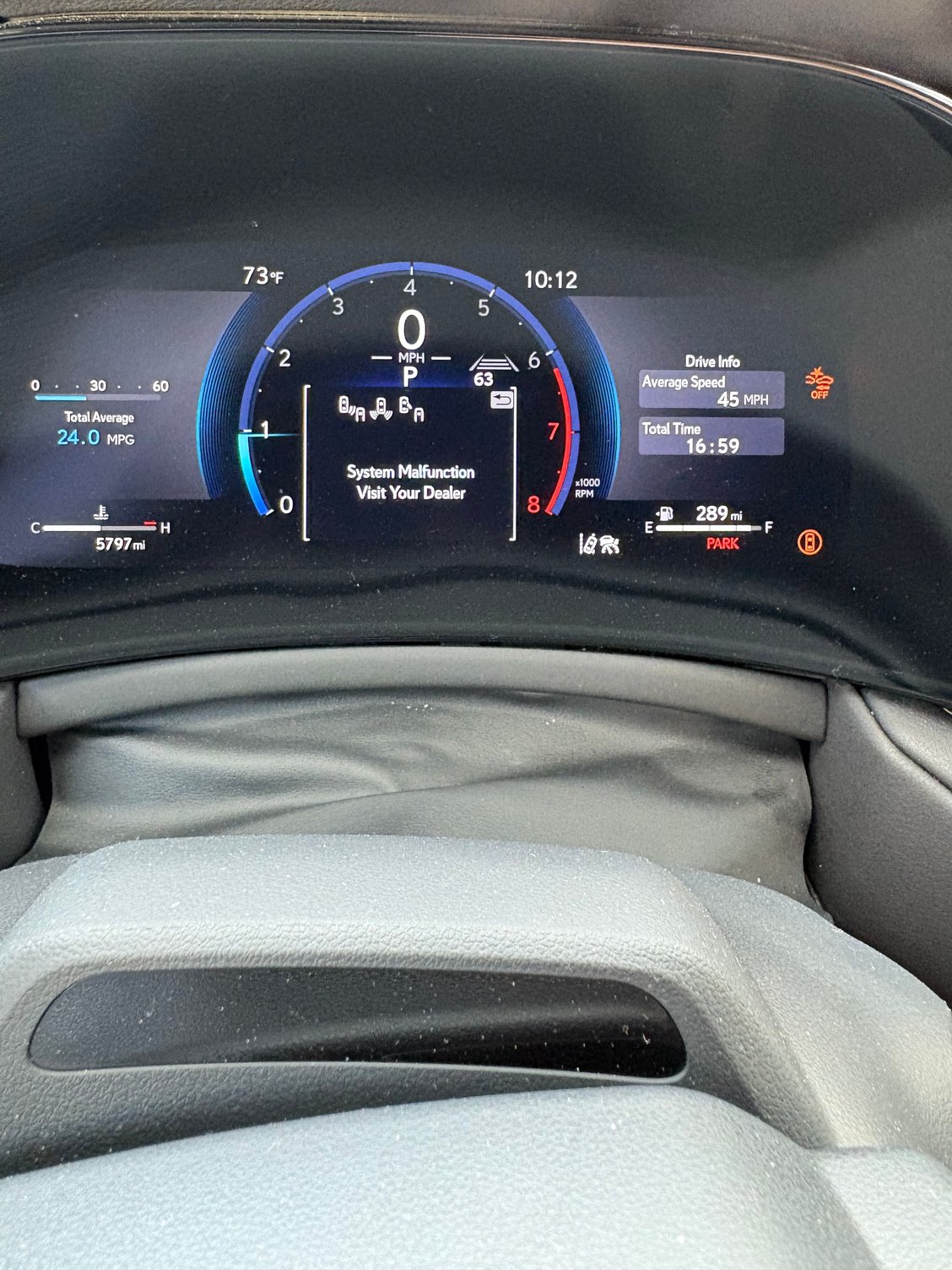

This thread is really helpful - had a similar warning pop up while on my 2024 TX350 Premium (~5800 miles odometer) during a long road trip - see attached pics. Message is slightly different but may just be a recent update. Looks to be related to side impact sensors (?). Took it to the nearest Lexus dealership (Charlotte Lexus - they were *awesome!*) to do a safety check. After reading the vehicle status, told us it was safe to drive althoughsome of the safety features were not available. Stated they would repair if we were going to be in the area for a few days, but we were heading home next day.
Drove 750 miles home without incident, my local dealer picked up today to tackle the problem. Will update when fixed.
