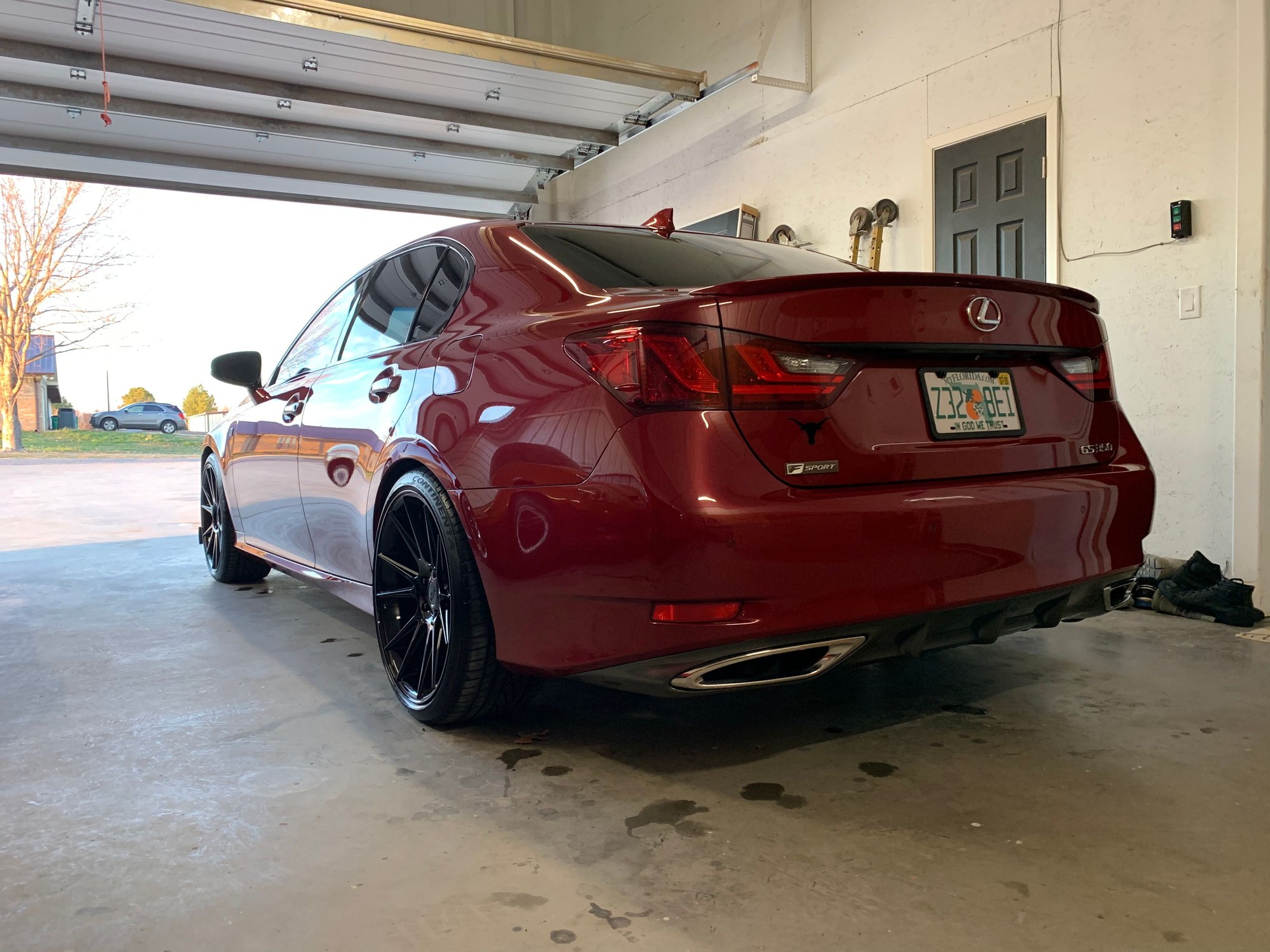

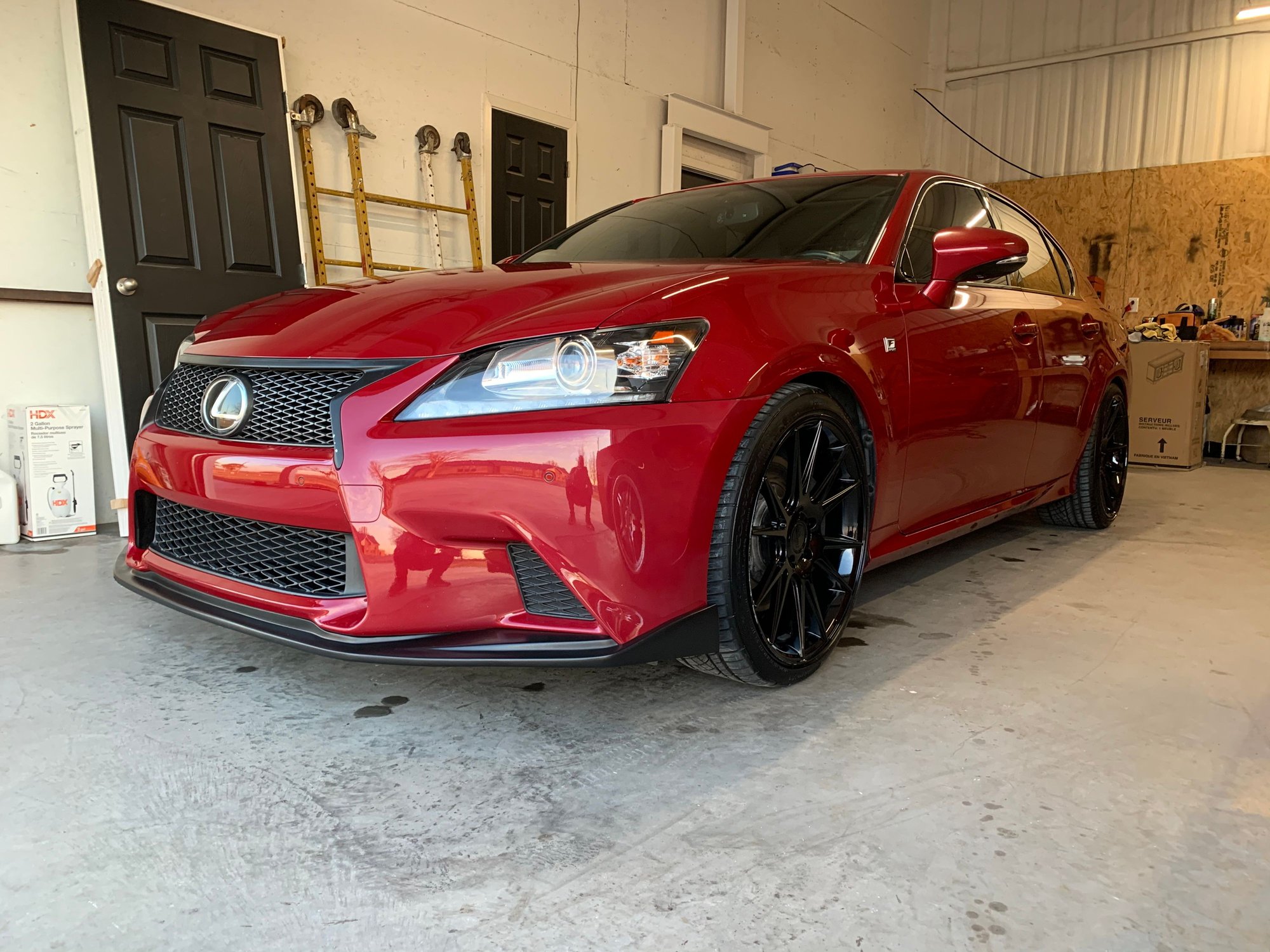

Do you have more pictures of your car ? etc side view

Wow, that red is really spectacular!
