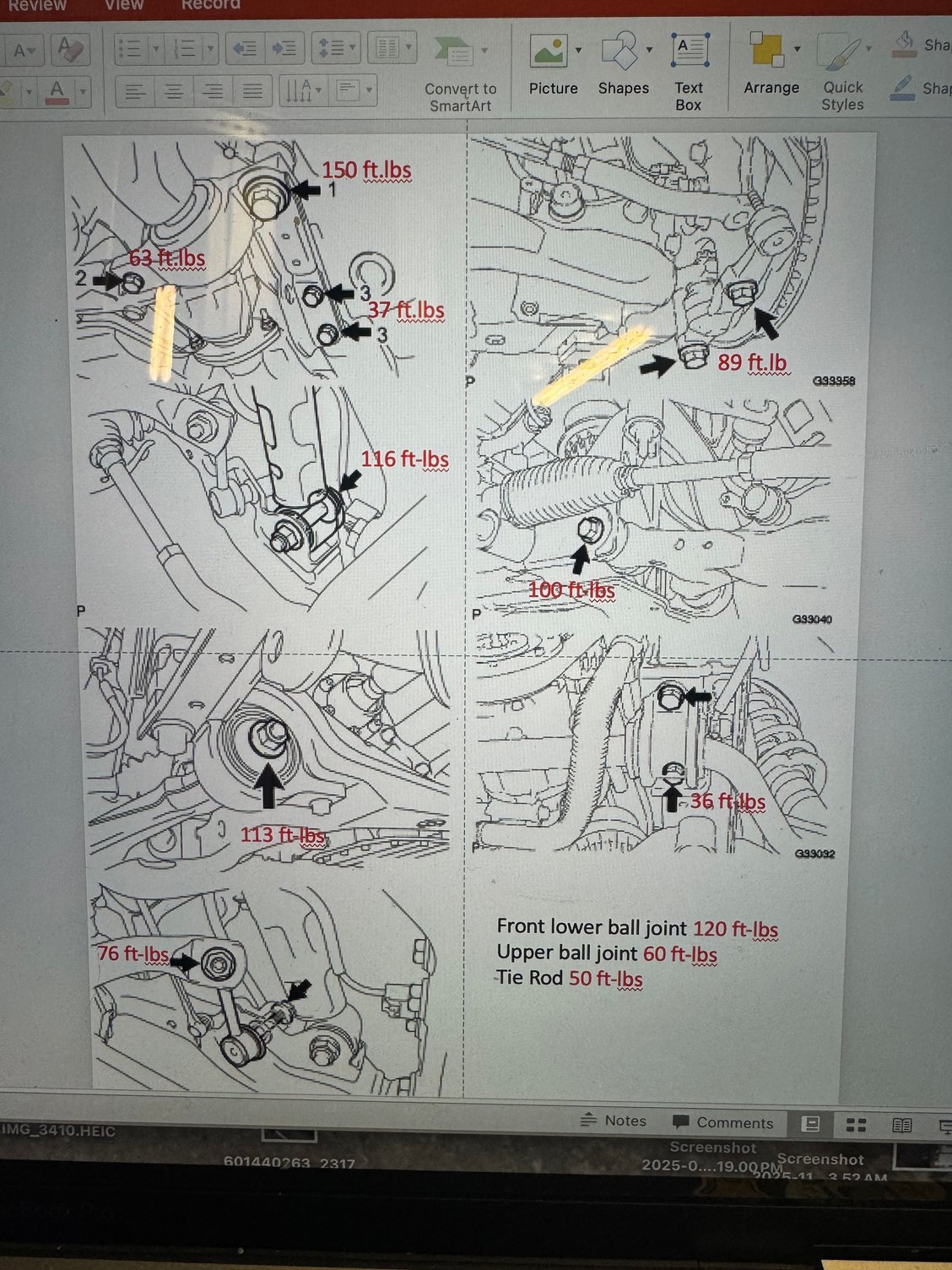

Here are the torque specs to bolt everything back. These are from 08 GS 460 manual, should be same.
