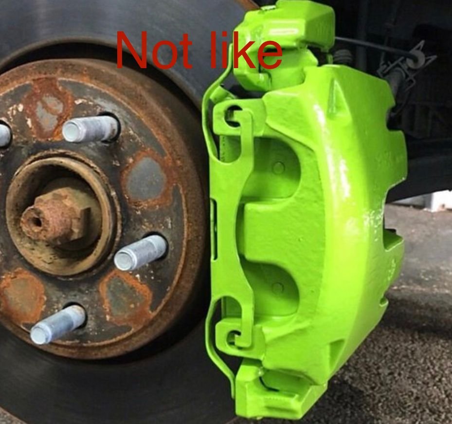

Hello friends . I have a Lexus IS300H 2015 . I want to replace the calipers and paint them. I want calipers to be wide and it will look good after coloring. Can anyone here recommend me?

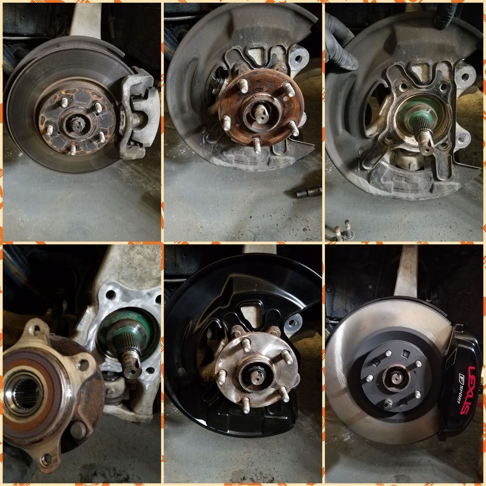

Does it look like the one at the top left of the photo below, and you want it to look like the bottom right after?
2014 IS250 AWD front brakes converted to IS350 front brakes

If you want to convert you IS300h to the larger calipers, I'll explain what I did to convert my IS250 to the larger IS350 calipers.
Since we don't have the IS300h here in North America, I'm going to assume that the front brakes on your IS300h are the same as my IS250 was...i could be wrong though as I have no way to confirm.
I'm also going to assume that you have the IS350 in your country, so you will be able to gather the necessary parts for the conversion.
Parts needed:
  • Left front backing plate (also known as a dust shield)
  • Right front backing plate (also known as a dust shield)
  • Front rotors x 2
  • Front pad set
  • Front pad shim set
  • Left front caliper
  • Right front caliper
  • Anti-rattle clip x 2
  • Pad pin x 2
  • Pad pin clip x 2
  • Brake fluid
I would suggest getting the backing plates from the dealer...they should not be expensive.
The front rotors you can get from the dealer or aftermarket...it's up to you.
The calipers are quite expensive new, so I would try to get used or re-manufactured calipers.
If you want to paint the calipers, that's up to you.
I will assume the IS300h is rear wheel drive (RWD), so the parts you are getting for the conversion would be the same as found on the front of a 2015 IS350 RWD.
My picture above is my IS250 AWD, so you will not have driveshafts in the front if your IS300h is RWD.
To swap the brakes you will need to:
  • Remove the old calipers and caliper brackets
  • Remove the old rotors
  • Remove the front wheel bearing assemblies...they are held in by 4 bolts at the back
  • Replace the old backing plates with the new ones
  • Reinstall the old wheel bearing assemblies
  • Install the new rotors
  • Install the large brake calipers
  • Install the new front pad set, with the shims attached
  • In each caliper to hold the new pads in place, you will use an anti-rattle clip, pad pin, and pad pin clip
  • After everything is assembled, you will need to bleed the brakes...this would be a good time to flush the brake fluid in the entire system
This is a simplified list of how to do the conversion, the actual work would take more detail to explain.
