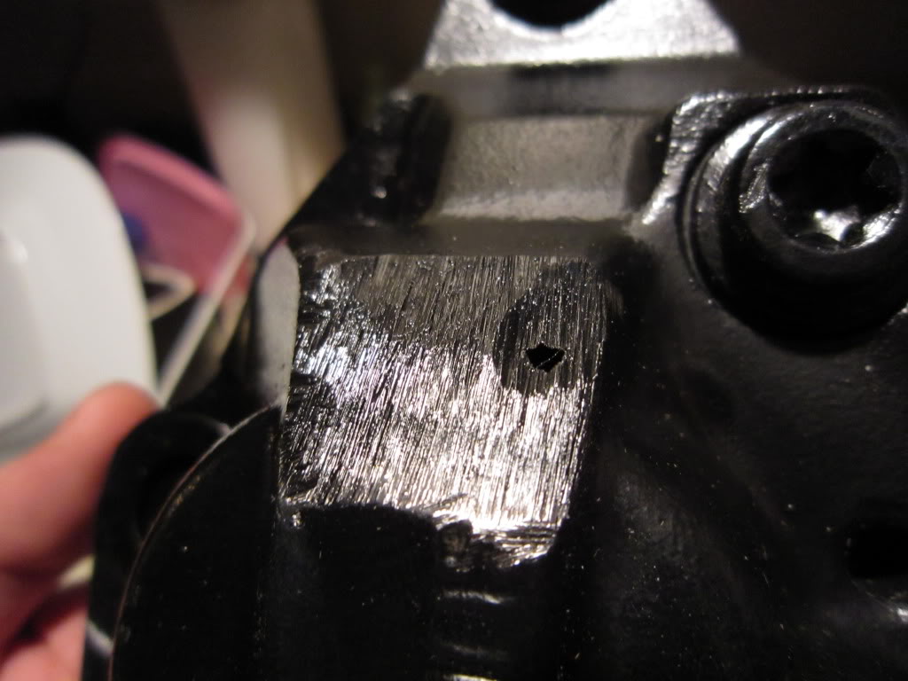

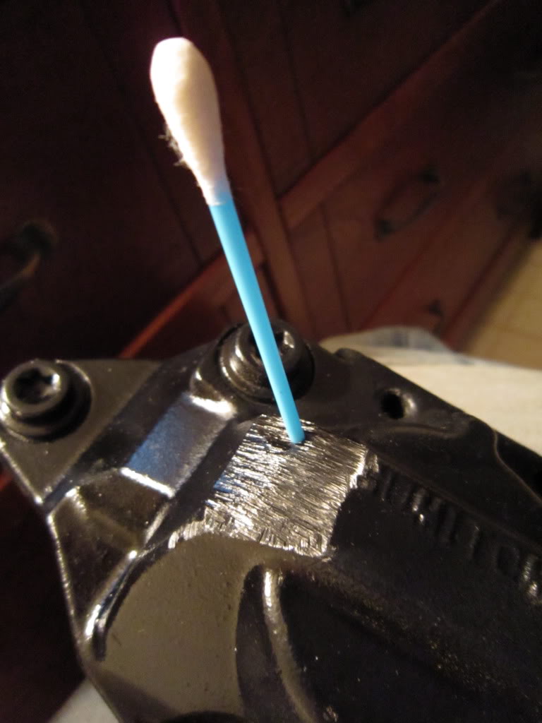

This may have been covered before , but I just wanted to post some detailed pics and give a word of caution to anybody who is doing the LS400 caliper swap on the GS without RCA,s (unfortunately I discovered what RCA is after this problem). If you are doing this without RCA you will have to grind down a portion of the caliper itself as well as the nut on the tie-rod. Neither of these is a good thing but it can be made to work if you are very careful. However there is a fine line between success and grinding a hole right into the fluid reservoir of the caliper. So the following pictures is what happened after a friend encouraged me to "stop being pu$$y and grind it like a man"

Well my trash talking friend had completed the swap before on his GS and diddnt have any problems. So after me doing a tedious grind,test fit ,grind,test fit for half an hour I started to get a little frustrated and gave in to his heckling. I dont blame him I just should have trusted my better judgement.
I came across a pic of the same situation but it was buried in a thread and hard to find and without very good pics. Just wanted to make a easy to find thread that has the word "caution" in it and that has pictures up front and that also mentions the RCA option instead of grinding things. Anyway Im new to this forum and thought this might help someone to not make the same mistake.

Sorry to see that! I did mine the same tedious way you started out for fear of this very thing happening, had seen it mentioned somewhere in my research. Took quite a bit of time and effort and the grinding is less than ideal but I've been driving on them for a year without any issues.
