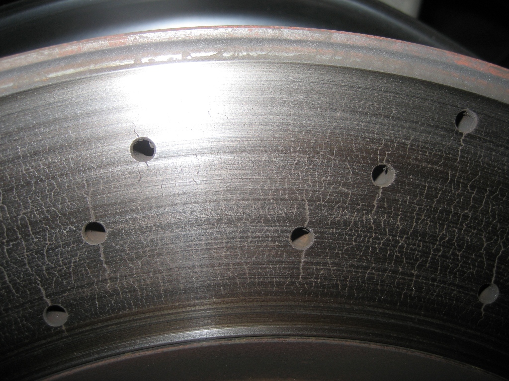

Drilled rotors suck. These are IS F Brembo rotors from the front. Slotted is OK, but plain is best.

I want drilled bc they look good. I will never track this car other then some thursday night drag racing once in a while, which won't take a toll on the brakes or crack them. I recall lobux's rotors cracked after a few autocross track days.

Those pictures scare me.
I myself don't drive my car hard but I wonder how the owner before me drove for the 8 months he/she had him.

why would anyone want drilled or slotted rotors for the street? unless you're tracking the car, there's no need. slotted and drilled just wear your pads down faster and drilled rotors are prone to cracking. just good blank rotors and upgrade pads/lines.
Your answer is in the post a few above yours-
Personally I agree with you, it's not worth the shortened pad life and eventual risk of cracking, but to some folks apparently it is.
