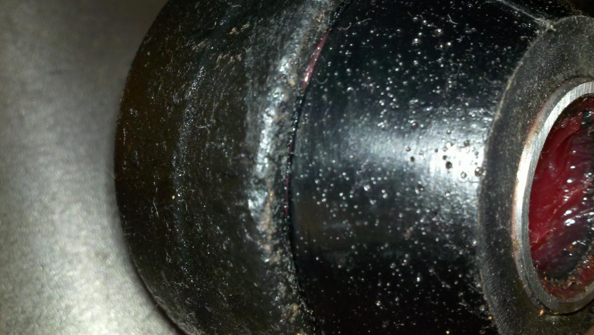

nice clean up for a perfect fit.

Mar 7, 2012 | 09:32 PM
  #112
you didnt have to keep the outer sleeve?

Mar 9, 2012 | 02:53 PM
  #115
Quote: you didnt have to keep the outer sleeve?
Yes, thin metal sleeve with in the arm must be left in, if not, the bushing will have too much play.. look at the previous posts, there's a picture in there showing the xtra space..
