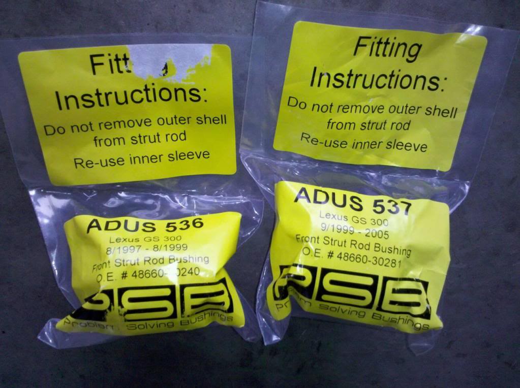

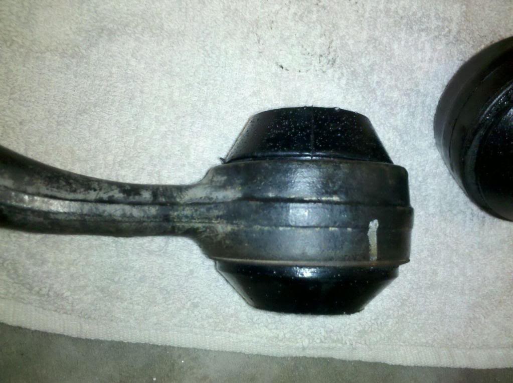

Just did my bushings today. I went with the l-tuned/carson bushings and yes, i did leave the outer sleeve and re-used the inner sleeve. If you didnt use the outer sleeve then you may have wiggle room when your driving. It might have felt tight putting them in by hand but once the cars load is on them they might give to much. I might be wrong though. I used a press to push them in. First i removed all the rubber, then chiseled out all the small pieces of rubber, then for the inner sleeve i used my grinder and grounded off all the rubber i could off that. Then lubed the arm, the bushing and the sleeve. I pressed the inner sleeve into the bushing first, then the whole bushing into the arm. Its alot easier if you have a press.

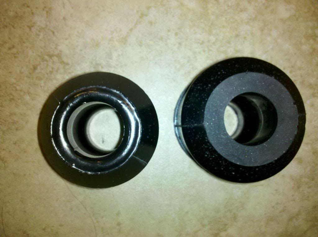

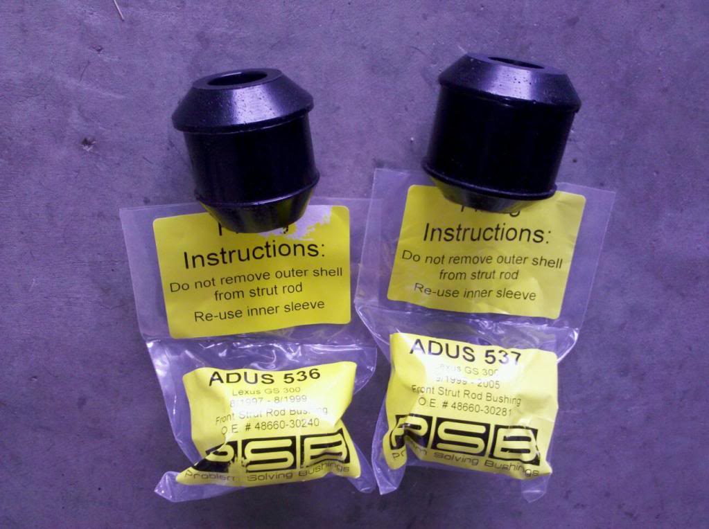

Here are some photos of the the two different bushings. The left is for 98-00 the right is for 01-05. Look closely at the size difference. Also, look at the package, it has two different part numbers. Left is 536 and the right is 537. When ordering these, you have to be specific as to what year you have.

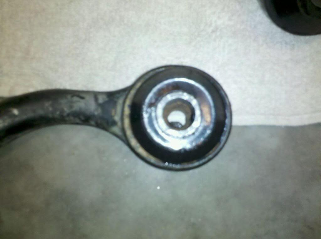

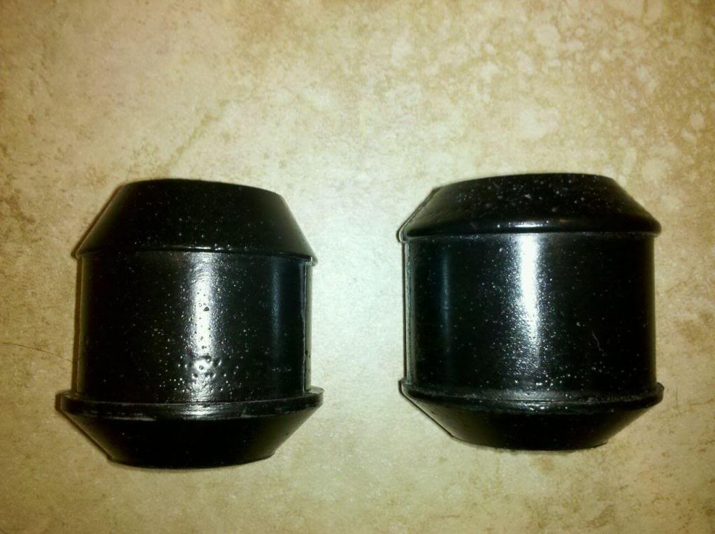

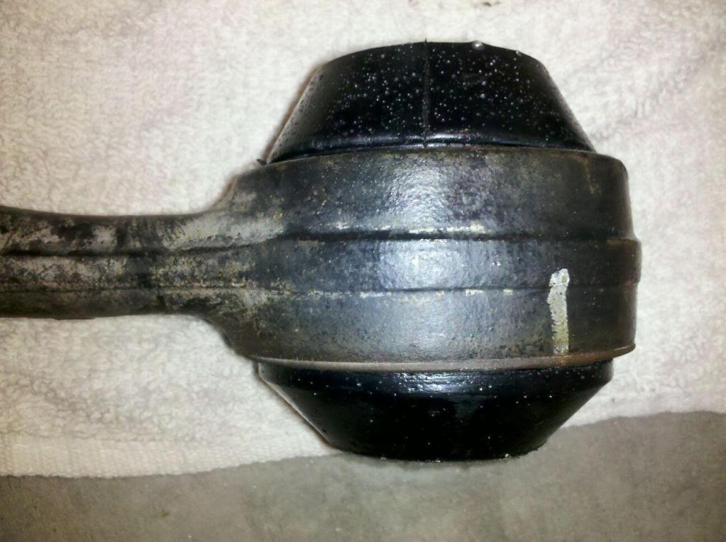

left one has a smaller yet taller end. That end goes upward, toward the car. The bushing on the right is the same size on both ends, so that one you cant get wrong. Except when you install the inner sleeve. The inner sleeve goes in with the widest opening up. It wont fit any other way.
