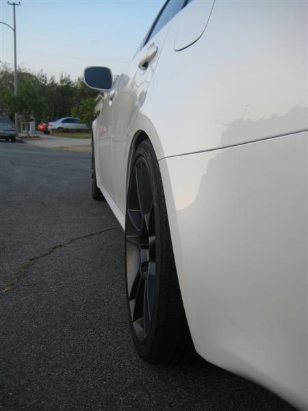

Five Axis used my car for fitment testing for the S5:F wheels. Unless they recently added some different offsets, I don't believe they have an offset of +35 for that wheel size. However, you should be fine with the +30 offsets with 235/35 tires. My current set up is 19x8.5 (+30) with 235/35 in front and 19x9.5 (+35) with 265/30 in rear. Your rears should clear easily. Mine clears by 2 mm with my set up. As for the front, I needed to slightly modify the plastic inner lining with a heat gun...not a big deal. BTW, I'm dropped on S-techs. You'll love the wheels...I do

hmm.. ur on the RWD.. the s-techs would have dropped it a bit more for you than it would on my AWD. The +35 offset r on the 19x.9.5. Do you have any pics you could send me? Thanks

Here are a couple of pics. You'll be fine with the 19x8.5 (+30) in the rear.

nicee, using ur pics at reference when i order them.
thanks bro.
