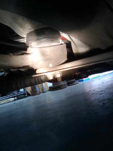

So my driver's side lower control arm is looking like this:
So I'll be switching back to OEM I guess. Just curious, anyone else with Daizen Control arm bushings having this problem?

Never had a problem. When the bushings were pressed in, was there any major damage to the lip of the bushings?
Not that I know of. The shop just claimed that its the design thats flawed. The lip of the bushing is to small to hold in place.

My lip definitely extends far out like it should. I have a pic in the FS thread.
Sounds to me like the shop didn't do a good job of pressing it in. Check to see if the lips are rounded off.
