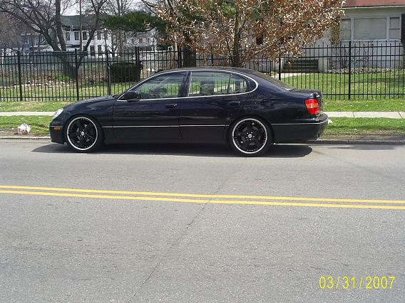

here is a pic of my gs on tein ss , i can lower the car lower then this with no problem

Slammed...I like the look of your ride on the SS; hot! Regarding your drop, would you say that you are on the "middle setting"; have a lot more to go as far as lowering or are you more towards max adjustment (i.e. lowest drop)?
Also, I am really contemplating getting either the CS or the SS. I'm from NY, I think Jersey has the same type of poor road conditions...how does the SS perform? Is it a little too harsh for these roads even on the softest dampening setting? Sorry for all the questions...thanks for the advice.

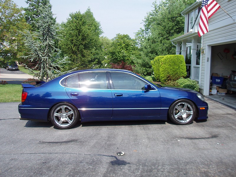

Here is mine on CSv2's
Could go down a little more, you can get the wheels to tuck just a little bit at all the way down.

Oh, we kind of missed the question, lol...He has them just wants to know if running them all the way down is ok. Well....I think it's fine to run them all the way down BUT take care if you have a few people in your car and want to turn into a steep driveway etc...I learned the hard way and am now shopping for 2 new fenders because the tire caught them and creased them on both sides.
