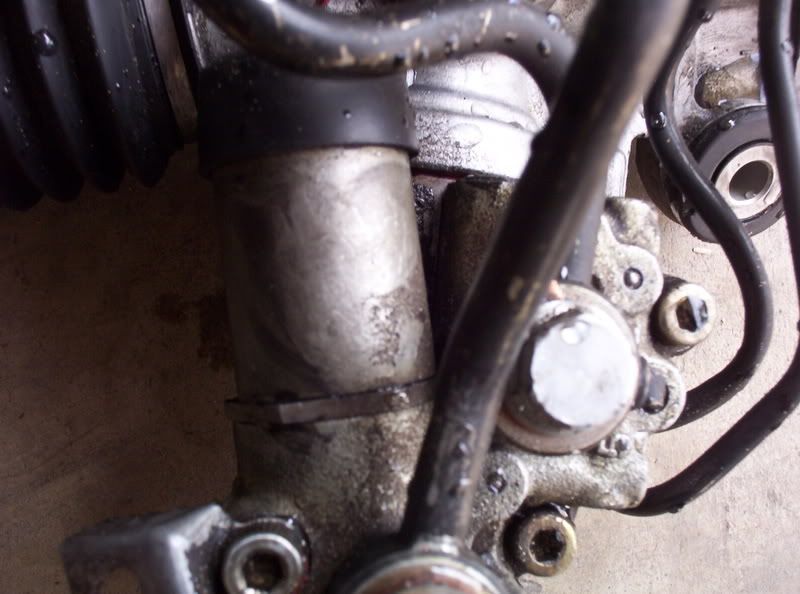

here was my deal, i have a 94sc400 with 168,xxx miles and it was leaking powersteering fluid from the rack somewhere up top where the pressure and return lines go into it (just below where the steering shaft goes in). I talked to a mechanic and he was saying that usually when a rack goes bad it will leak fluid out of the boots because the seals where the steering arms go back into the rack go bad and this usually means a new rack. well i felt that maybe my rack was salvagible because i was still dry in this area.

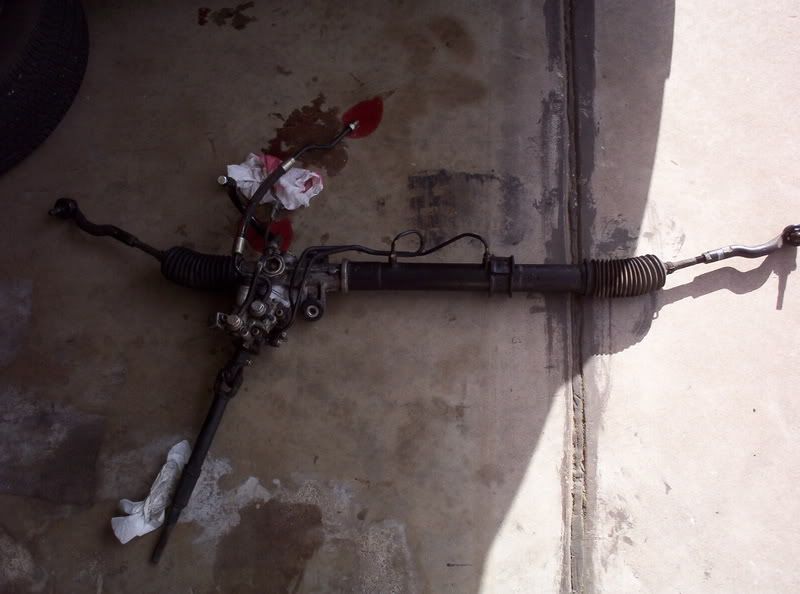

so, i pulled the rack (when taking the tierods off, make sure you have a pickle fork, i rented one for free from checker). then i took the top part of it, (where the pressure and return line go in) off.
A tip here, there are three bolts and they are allen head, chances are they will be very hard to get off so make sure you have an allen head bit that can be fitted on the end of a rachet because you will never be able to get it off with just a regular allen wrench. I even had to use a cheater bar just to break mine loose.
Once this is off i found that there were three little rubber o-rings that sat in recessed holes. i ran my finger across this and realized that these o-rings were just a little below the surface. so i popped these out and realized that they were very squished to the point of being flat. so i ran up to checker and bought these little rubber o-rings.(width 2.5mm, ID/OD 12mm "metric o-tite! #64512), they come in a bag of 8. I then put these in, w/ a thin layer of silicon on the one surface and reinstalled it and the leak was fixed. sorry i dont have pictures of when i had the top piece off.
