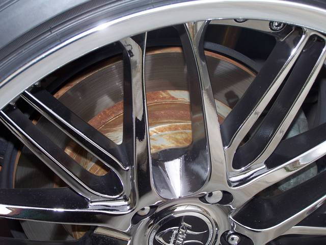

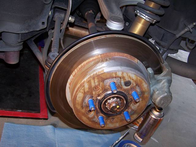

Some of you have probably already done this, but I got tired of looking at the rusty brake rotor "hats" (or hub) through my beautiful new wheels, so I painted them using some hi-temp engine paint and WOW what a difference! Just sprayed the paint into the cap and used a small brush to avoid trying to mask off the rotor surface etc.
Before and after pics:
This was the view through the spokes before:
Ready to paint-wheel studs masked off

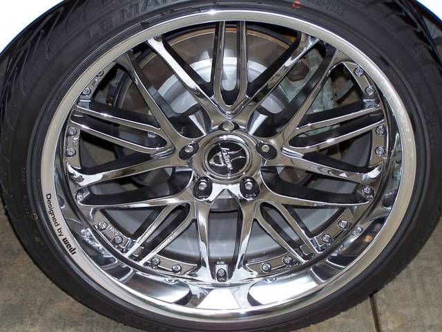

After painting-still a little more touch up to do...
Now THAT looks much better!!

When you take your wheel off to do your caliper - you might want to do the edge of your rotor as well - looks like there's some rust on there too.
