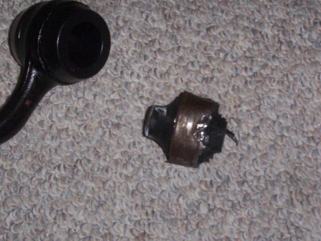

I found this thread on the sc bushing replacement. Are the sc bushings designed the same as the gs? or does the gs require a press with no exceptions.
bro the removal of the sc stuff is different then removing these bushings .. see my pic the entire metal sleeve has to be removed period.. its time consuming and not easy at all.. i have done 3 so far and i know how to do it
check the pic of the bushing removed with sleeve in one piece then you need to press in the new ones and only a hydraulic press will do it
