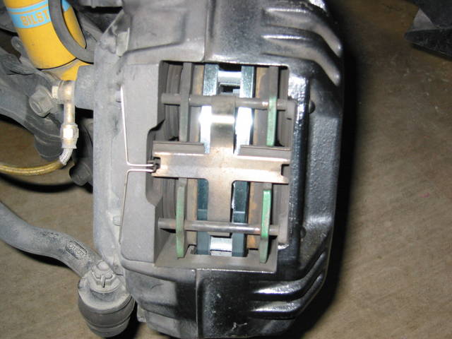

JacobT's Avatar
JacobT
Posts: 582
From: Austin Texas
Look at the pic, everything you need to complete the TT brake system is there. Of course, I had the EBC Green then and they are EBC Red Ceramics now.

Old Jul 13, 2005 | 05:52 PM
JacobT's Avatar
JacobT
Posts: 582
From: Austin Texas
Originally Posted by ILOVEGIRLS
what do the pad spacers do and do i need them?
The pad spacers should come with the pads. They are there to make the squeeking sound if your pads are too thin.

thanks jacob. you picture helped me out with this. the parts guy at toyota was a complete moron.
