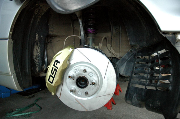

Ow, you mean these baby???? My UCF30 (LS430 monoblock) conversion with DSR brackets cost me a pretty penny, but it's sure a nice upgrade from my old TRD setup. I think besides me, there's no one else who has gone from stock, to TRD (supra), to UCF30 (monoblock). The difference from each stage is quite significant. I highly recommend it.
If you are interested in the DSR monoblock kit, please pm HKGS300. Cheers!
Yikes those things are monsters.... what size rims are required for those to clear?
Old Aug 12, 2004 | 10:12 AM
HKGS300's Avatar
HKGS300
Joined: Nov 2002
Posts: 1,066
From: HKG
At least 18"
