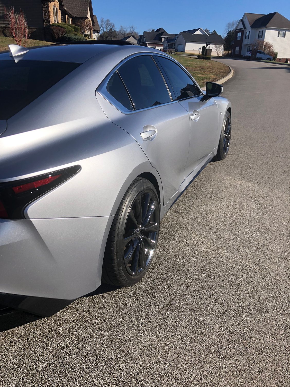

slip on and longer bolts. I just put these on mine.

I put some pictures up a few days ago, search it.
