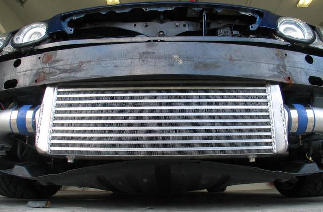

I had to take off the bumper support. Don't really need it anyway. If you crash , your screwed with or without it. We ran a custom bracket on each side that bolted into stock holes. And lastly, the inside of the bumper needed a litle shaving for the piping. I have heard of some people cutting the bumper support and rewelding it. Hope that helps, here's a pic before the bumper was put back on.

That's looking real sweet mikal. Loving that bumper, I need a bodykit sooo bad..
