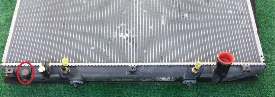

Have done some investigation of my own. Realized there is only a leak on cold start. Start car cold, observe coolant in tray, wipe up, drive to work, no further coolant in tray. Drive home no further coolant in tray. Had the wife start the car in morning so I could try and find the location of leak. Observed and filmed it drip, drip, dripping from what looks like a bolt head to the left of the drainage stopper. It then stops after car gets warm. Luckily I captured this on video and am heading back to the dealer tomorrow but can someone tell me what the actual function and / or name of that bolt head is to the left of the drainage plug. I've attached a picture I found of the lower part of an SC430 radiator for reference and circled the bolt in question in red.

I think that's a plug that goes in place of where a temperature sensor used to be. Probably simply needs a new gasket.

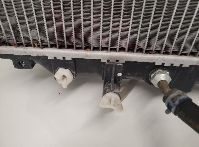

Interestingly, looking at used radiators on eBay, I notice some have a bolt like mine and some have a plastic plug like this...

It looks like they have both options in the diagram. I think...
16467A (16407-7A130) is the plastic plug with o-ring
16400U (90341-16016) is a bolt.
Wonder what the difference is and whether I should switch to the plastic plug.
