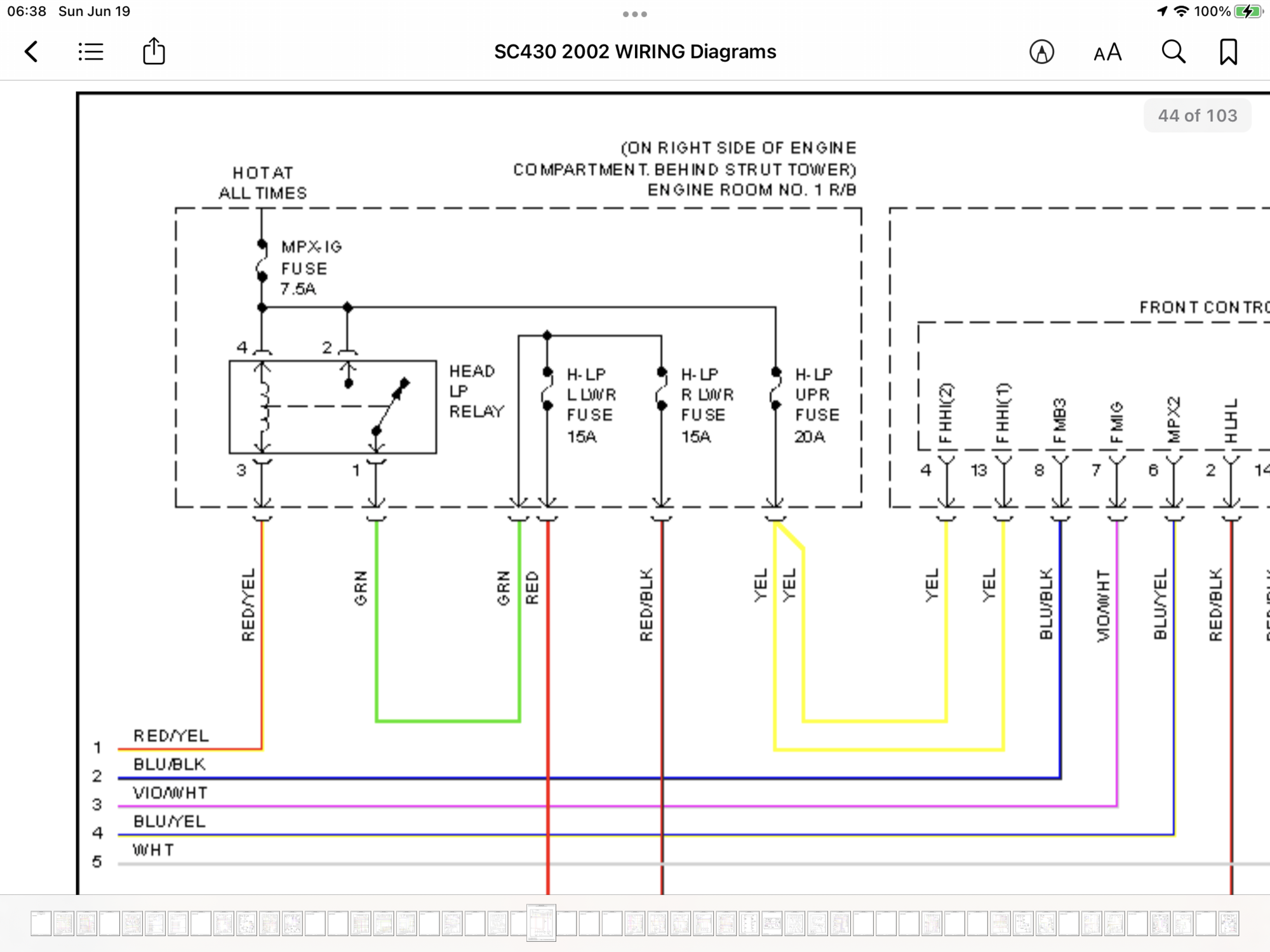

I have a 2002 SC and I noticed the passenger side low beam was out. Thanks to the great guidance on this site, I decided to drop the bumper and change all the all the bulbs on both sides while I had access. Naturally, I decided to check things before the arduous (for me) process of putting everything back together.
And....
Low and behold, the passenger side low beam is STILL OUT. I poked around through the manual thinking maybe it was a fuse but apparently the same 50 amp fuse controls both lights and the driver's side is working normally. The car is undrivable until I get the bumper back on to have someone look at it, so I'm hoping you folks have some advice before I do that. Is there something simple I'm missing?

Each headlight has a fuse…please check them and while you are there, check for 12vdc on the fuse.
If you don’t have a multimeter just swap the fuses to see if it moves the problem…you still need to know if there is power at the fuse.

I took BGW's advice and checked the fuses and to see if current was getting to the plug and sure enough it was. I then checked to see if there was continuity to the plug that goes into the ballast and there was. So, rather that take the other light apart to swap bulbs I used the old bulb that was still operational and low and behold....It Worked. I'm wondering if the original ballast that I subsequently replaced could have somehow blown the new bulb. In any event, I installed another bulb and it lit.
