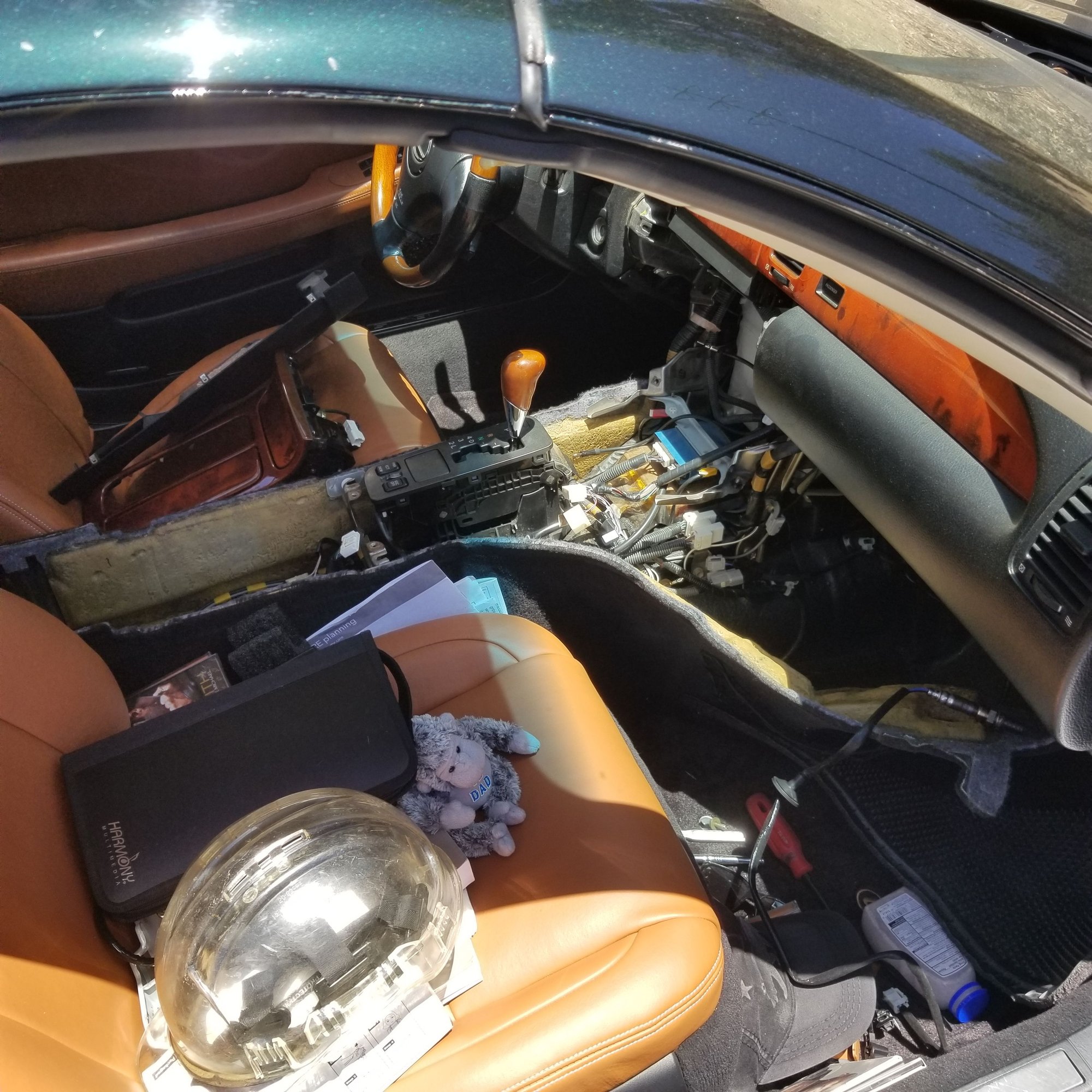

WOW. After more research I now know why changing the downstream sensors is such a problem.
The carpet isn't really carpet. It's a molded one piece rigid foam bucket with carpet impregnated to one side. The connections for the downstream O2 sensors are low, forward towards the firewall and behind a NAV unit.
Since I am tearing everything apart anyway chasing a stereo problem, it looks like 10 screws will remove the center console. I'm hoping that gives me easy access. No wonder so many people cut off the old one to splice in the new one. The trouble is, they do a crappy job.😤

Done replacing both O2 sensors. The key is to remove the center console.
It's not hard. Just a PITA. Both sides are virtually identical. Now that its done, I dont expect to ever have to do that again. And is why I just did them both at the same time.

Raven,
I'm next in line to do this job, just ordered a replacement of the B2S2 from Densoproducts. I hope I don't have to remove the center console. My plan involves a string. Thanks for posting pictures.

Anyone can think outside the box and come up with a solution that works. I truely believe the easiest option is to cut the plug at the sensor and then install a new connector. P/N 90980-10794 with the pins. Very important. Then you create a jumper and eliminate all the hassle coming your way.
Or you watch YouTube videos and see the hell coming your way if you don't remove the center console. 🤣
In all seriousness, removing the center console is a piece of cake and can be done in about 15 minutes. It gives you access to the rubber plug that goes through the body under your feet. The sensor is designed to be dropped to the outside from the inside. The rubber plug only fits one way. 🙁
