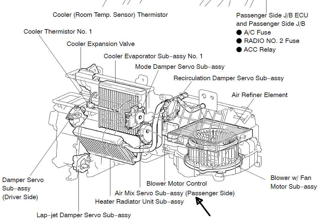

I'm guessing you have a problem with the passenger side airmix servo. I'll add a drawing from the FSM below. Also hoping someone who has had the problem looks in and posts.
Without input from others more knowledgeable -- You might be able to perform a diagnosis by removing the glovebox and switching the system from heat to AC and see if the servo moves around. Keep in mind the passenger side also has a mode control servo (control where air comes out).
I had to replace my mode control servo but did not look into how hard it would be to do the air mix servo.

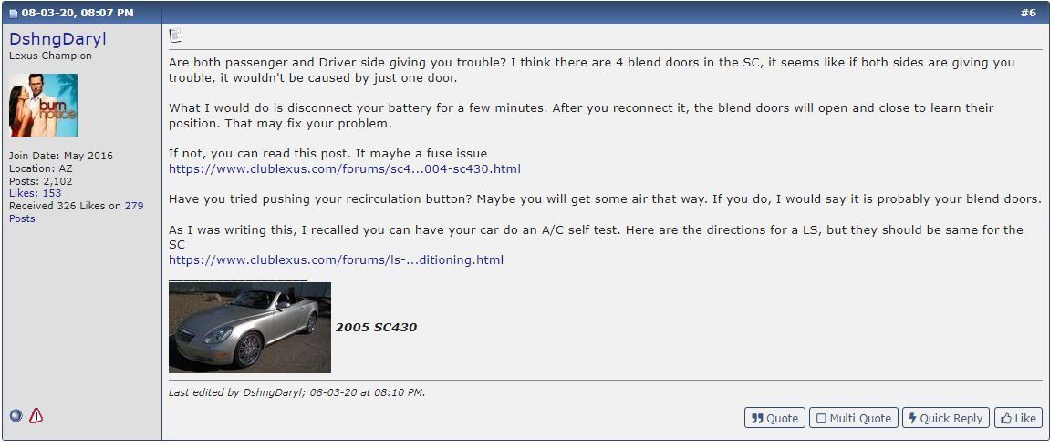

I did find this post:

Originally Posted by hlthlnk
Thank you for all the suggestions.
GmanSC- I tried every possible combination and the passenger side remains hot. The driver side does what it should do based on the temp I set.
You shouldn't listen to that guy, he doesn't know anything.(HA HA)
What did the self test show?
