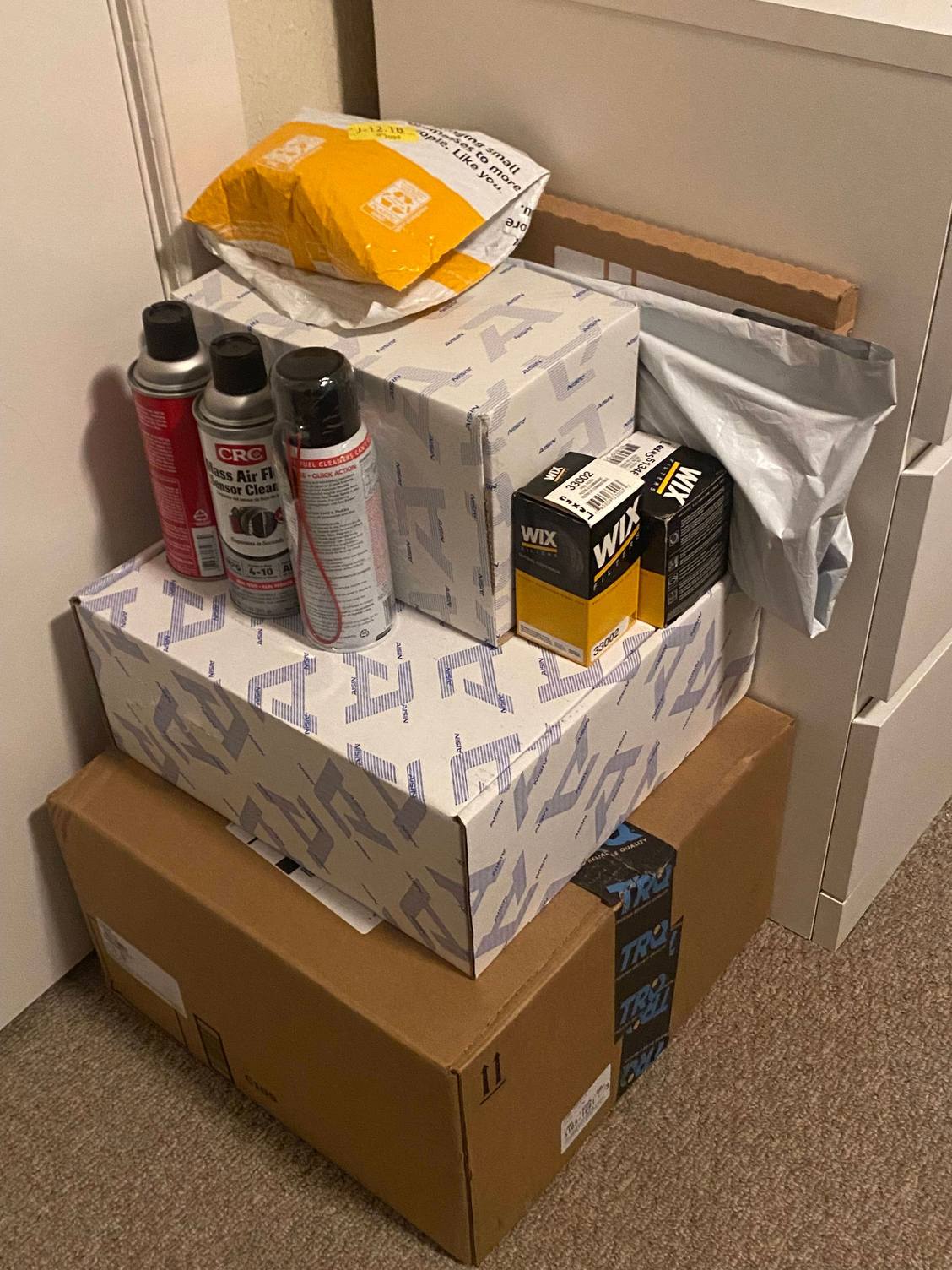

Mar 21, 2022 | 09:07 PM
75% of the parts are here. Just need the Coilovers, PCV valve, Oil, Transmission fluid, Hoses, Brake pads, Replacement weatherstrips for both passenger and driver side windows, and, Sealant (I think). Im going to lift the rear of the car when the weather clears up and see what else needs replacing (Hoping its not another 1k in parts). I could use some more advice for order of operations of these repairs. Im not sure what to tackle first or last and if anyone has some tips / suggestions i'm all ears.
Front Suspension Kit, Timing Belt Kit, Pulley Bracket, MAF Cleaner, Throttle Body Cleaner, Seafoam, Fuel Pump, Fuel Filter, Gasket, and, Seals
Front and Rear Rotors, Spark Plugs, Car Soap and Chrome Cleaner, and, New Brushes
