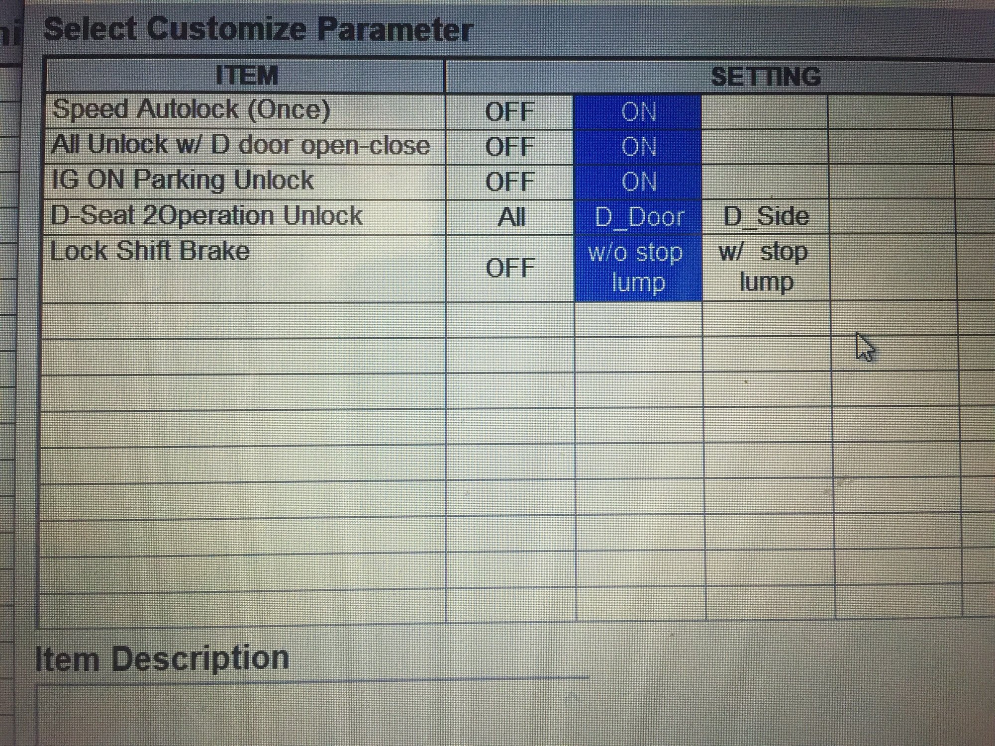

When I did a customization on door lock, one function that I did not quite understand.
On the last item, Lock Shift Brake, my section now is “w/o stop lump”. What is it? What happen if I select other function or turn it off ? Anyone care to explain?

Forgot the screen shot

I'm clueless on LUMP (some strange typo?), I expect you've already seen all the following info, but providing just in case:
For the 2002 model year I have the following on door lock customization:
5. Locking of doors when shifting from park into another range
When shifting the vehicle from park to another range, the following features can be programmed:
□ When shifting from park to another range, the doors will not lock.
□ When shifting from park to another range, while the brake pedal is PRESSED, all the doors will
lock. (Standard)
□ When shifting from park to another range, the doors will lock when the brake pedal is RELEASED.
also take a look at this link from the clublexus site.

I got it. It’s stop lamp. My current setting will lock all doors when shift from park and break release ( no stop lamp). Thanks Lee.

That's great insight. I read your post, looked at the screen capture, read a bit in the FSM, looked at the pdf I linked, even mentioned the possibility of a typo, and never once thought of swapping a U for an A. Stop Lamp - think that's a translation issue? I don't see anybody using US English describing conditions like that.
