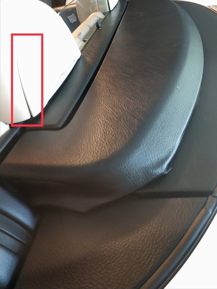

I put a red box around the area protruding only a little…that back piece just snaps in place. To remove, pull gently from the bottom…not a big deal, just an observation.
and like Wilson said above, some interior adhesive should do the trick.

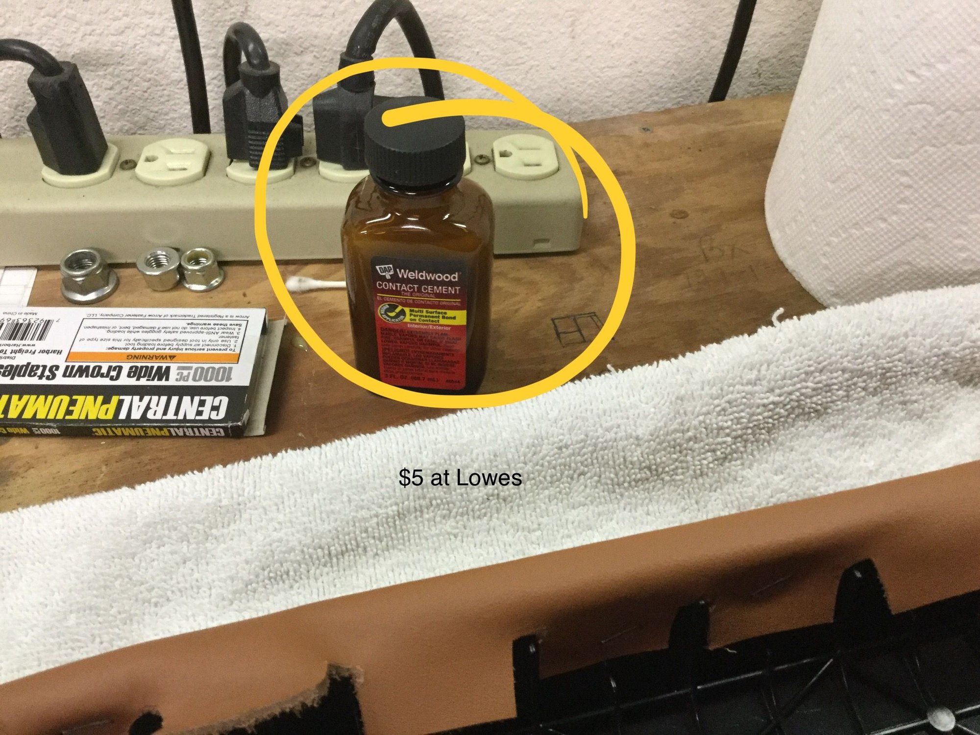

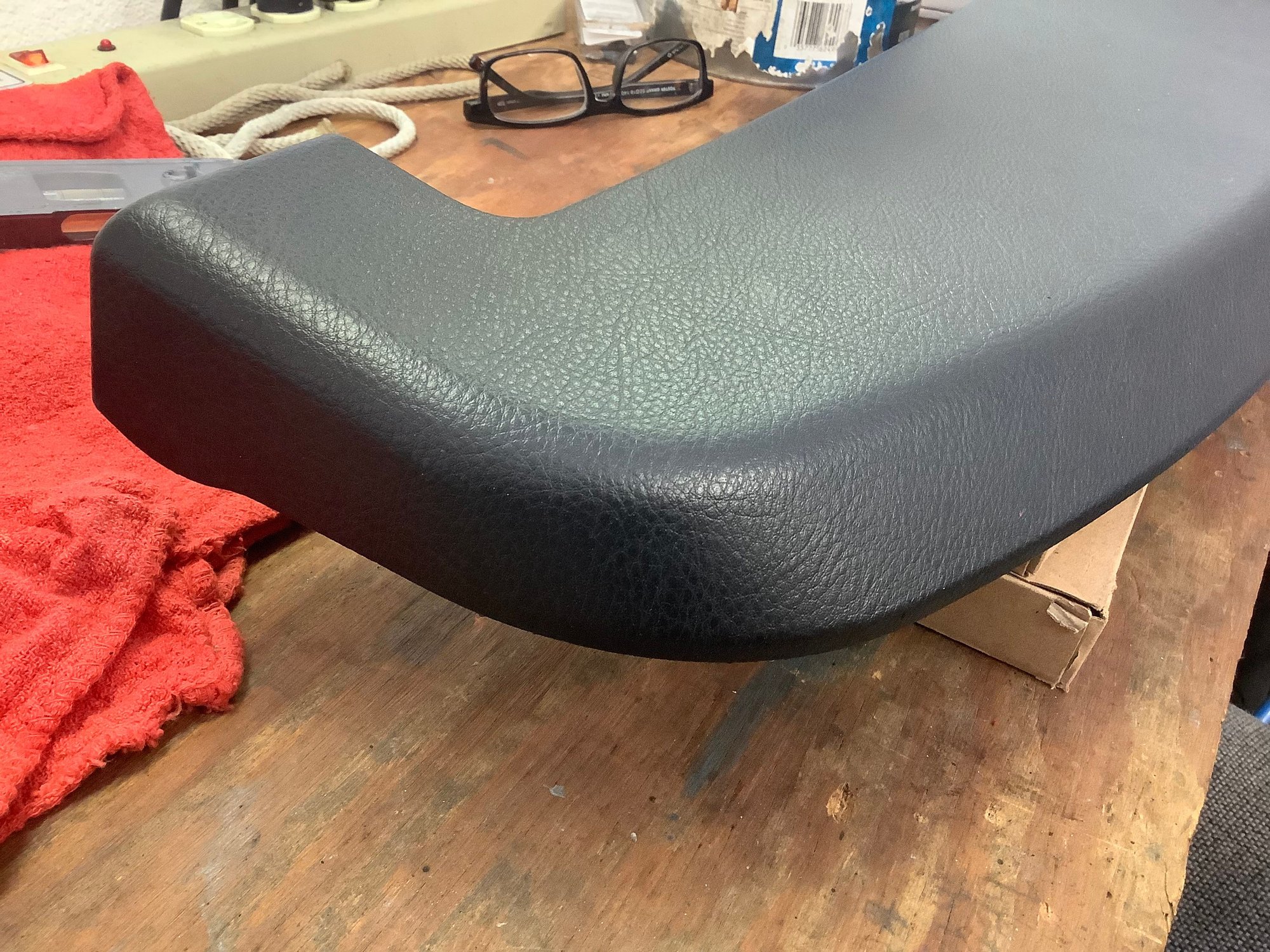

I used this adhesive when I recovered the center armrest…

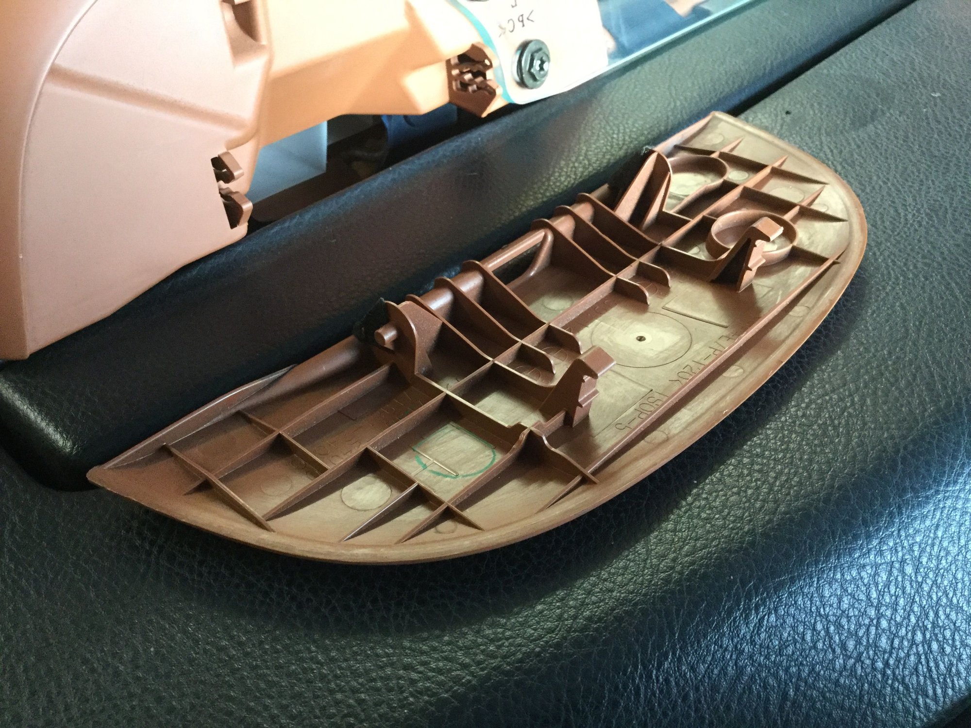

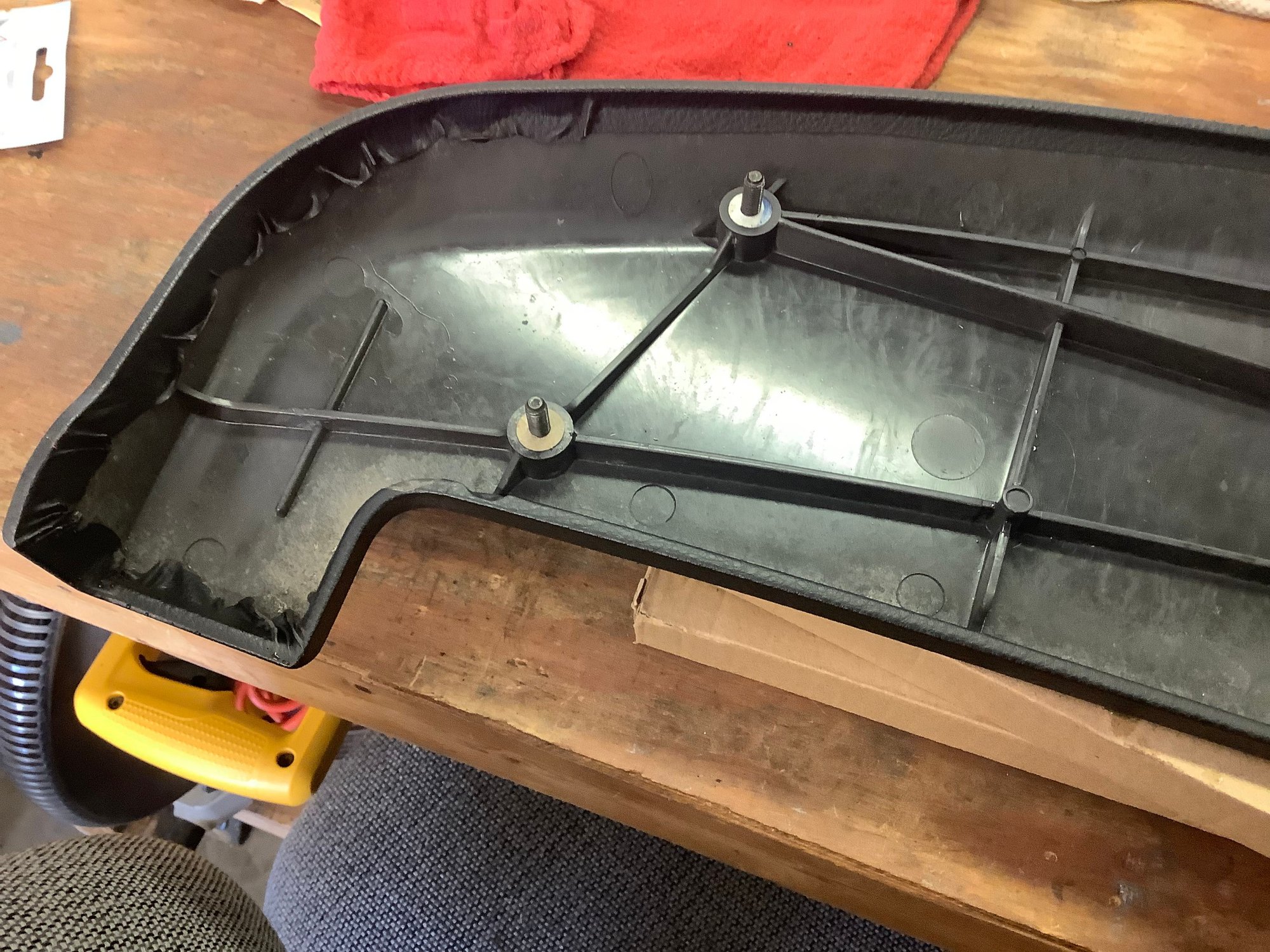

Just for reference, here is a pic of the top and underside.
make sure you have access for the repair because you may need to remove the package tray.
