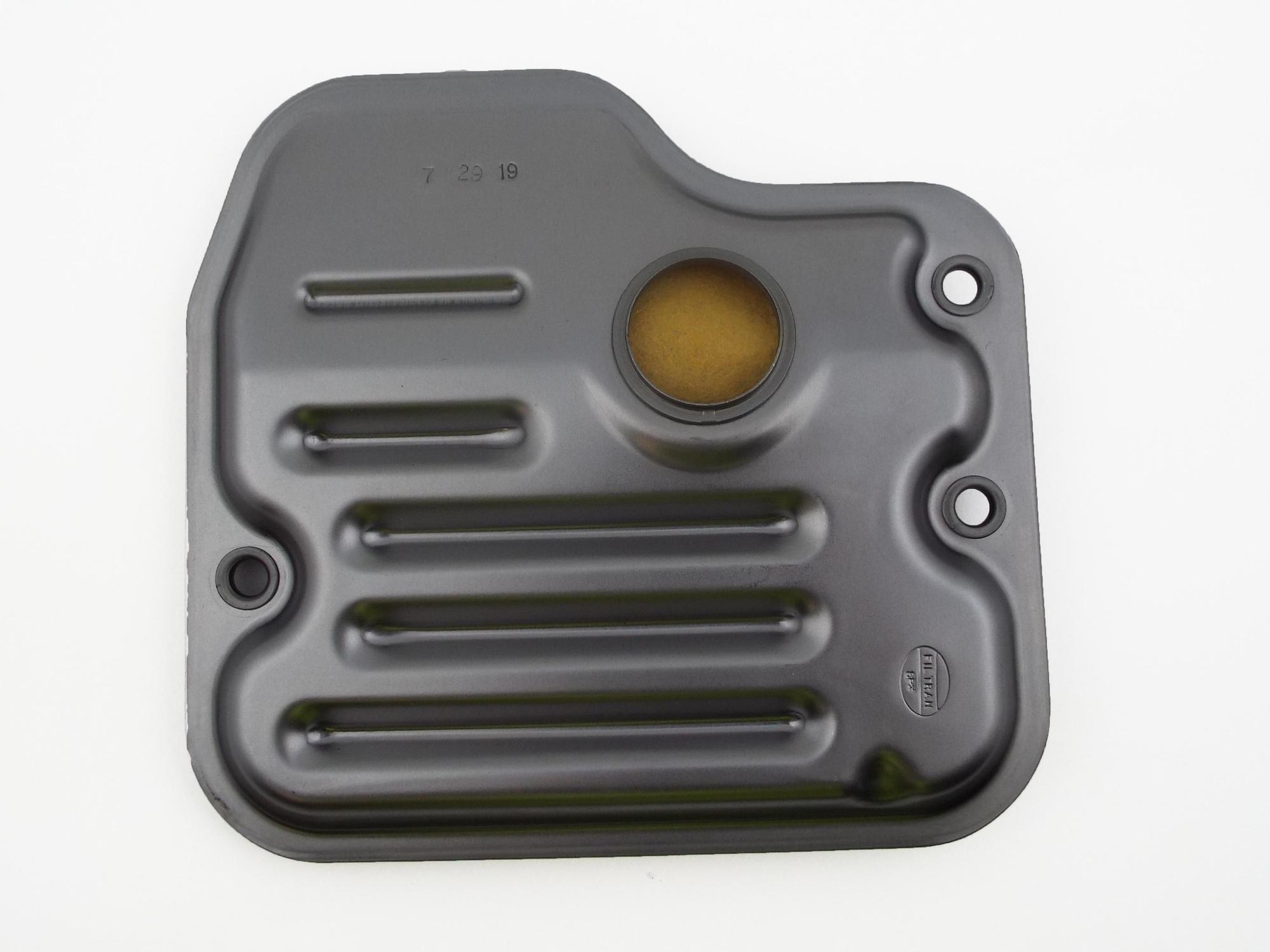

I think it looks like this.
What Digitac says about not changing it makes me feel better, but looking at the picture it appears there is some kind of filter medium in between the metal. This makes me think it should be changed at some point.

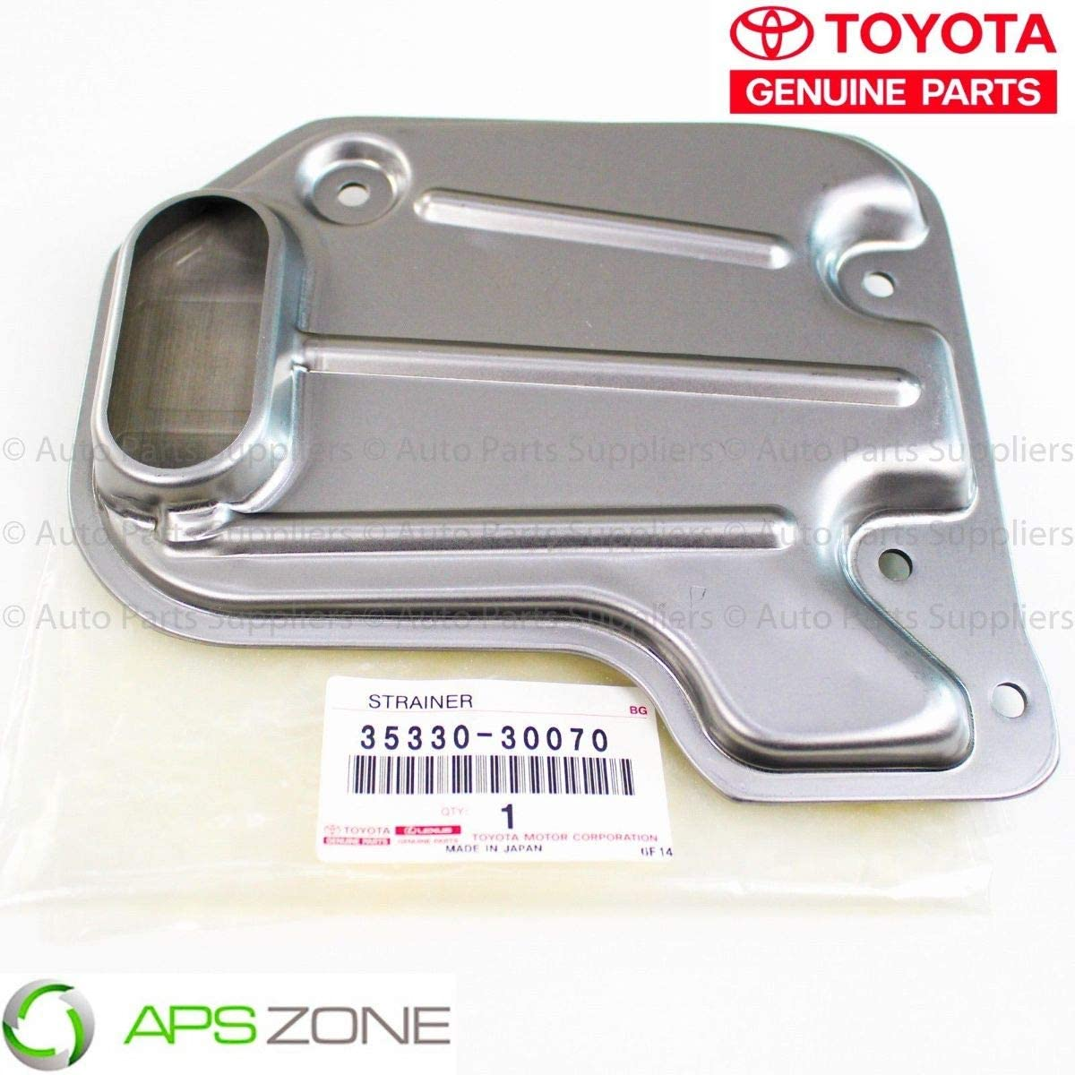

This is what it looks like when I pulled the pan.
The OEM filter, that part inside is a metal mesh, like this.
THANKS MAN! I feel better about my decision
