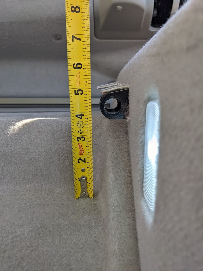

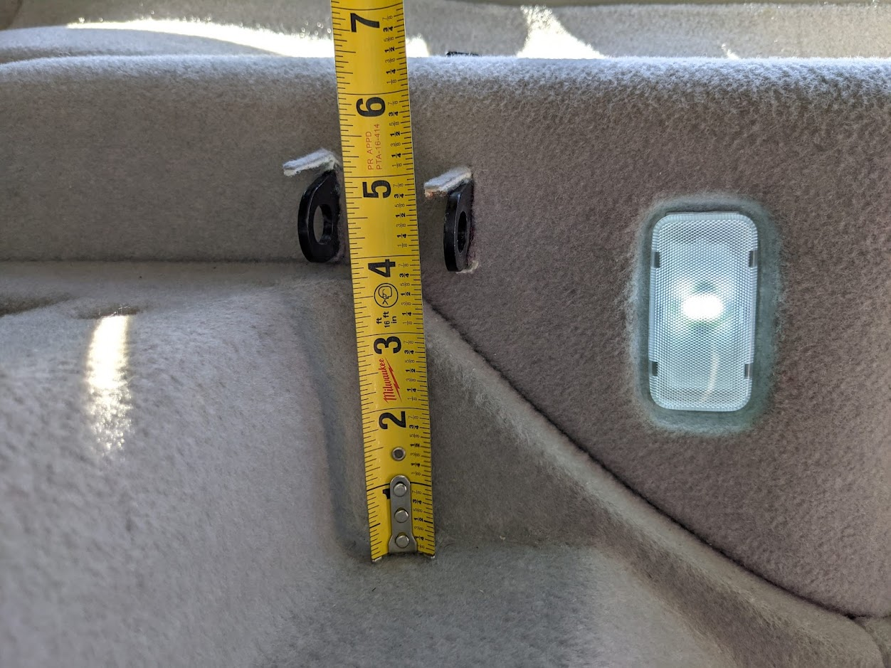

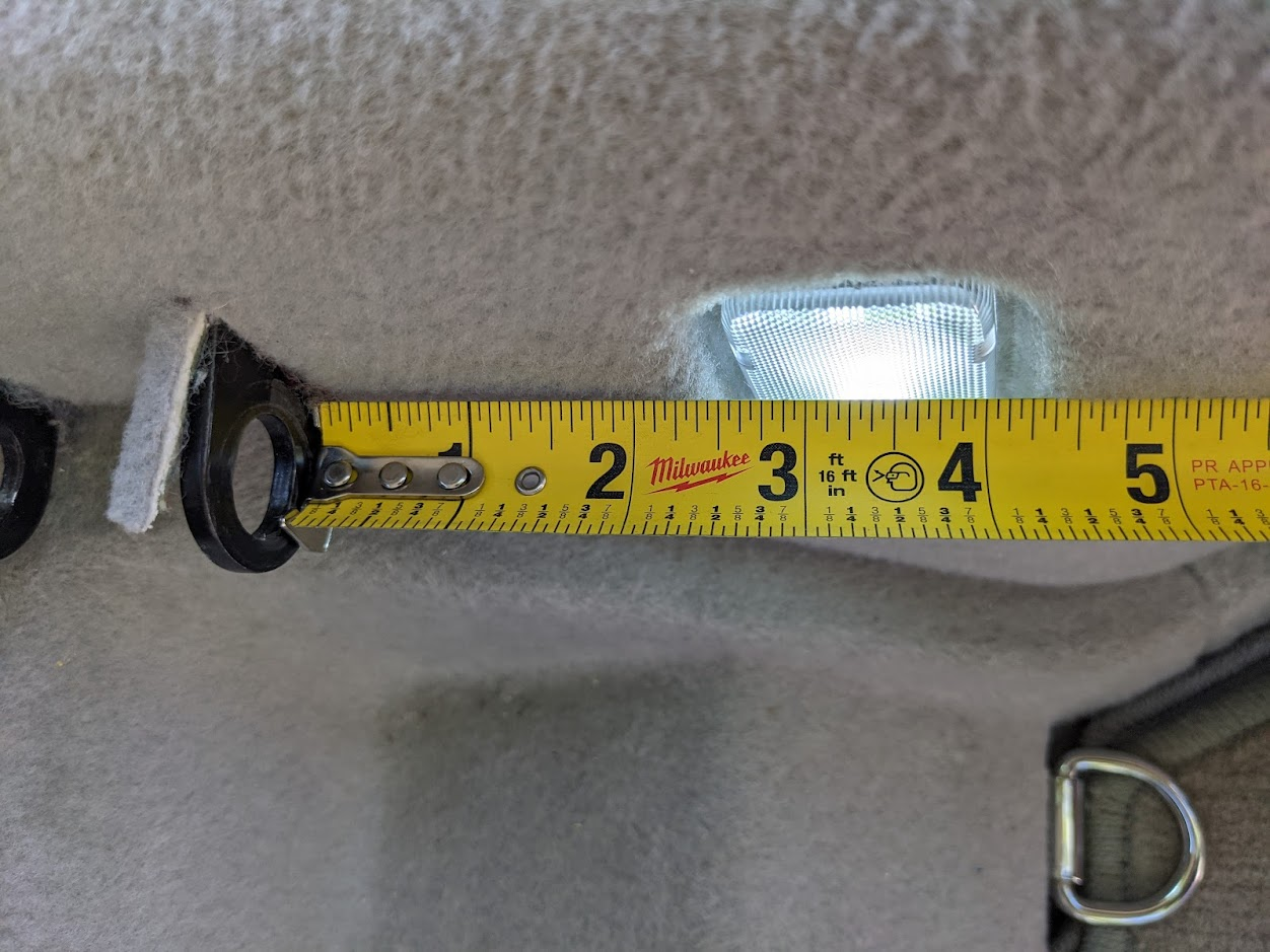

I have the same rear trunk tower strut bar. Could you make some type of measurement jig (or diagram) with the exact location of the holes which you cut? You could make it using a point of reference and cm from each point to the next? Would be very help for myself and others in the future. Thank you.

Unfortunately I do not have any kind of diagram or template. I can tell you how I got that though. I installed bracket to the strut tower, installed the linen piece, use a rubber mallet and hit from outside, right at location where I was going to cut, then take the linen cover out and cut it according to the imprint marks. Just a little bit of patience & elbow grease.
I'll get a tape measurer and take pictures when I get a chance.

Here are some pictures with the tape measurer. (Passenger side)
