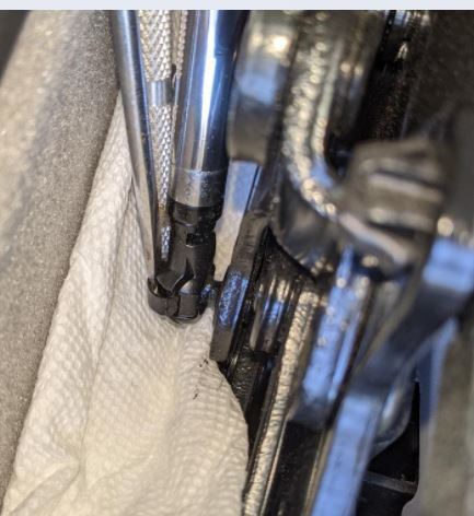

Got the Strongarm supports today, and just installed. Incredibly simple. My process was to put the roof up, throw an adjustable broomstick to help hold the tailgate up, put my shoulder under the tailgate, just in case, and then gave a firm pull on the strut as low as I could go, and the bottom popped right off. Of course, top was even easier. Pushed the Strongarm right back on the fittings. This is really a two minute job, except for the fact that on one side, the strut did not easily pull off of the fitting, so I pulled off the retainer. That process was simply to fold a paper towel and slide it under the fitting so the retainer would not fall down into the lift mechanism. Then I slid my magnet down there and a screwdriver and it came off easily and of course then the strut popped right off.

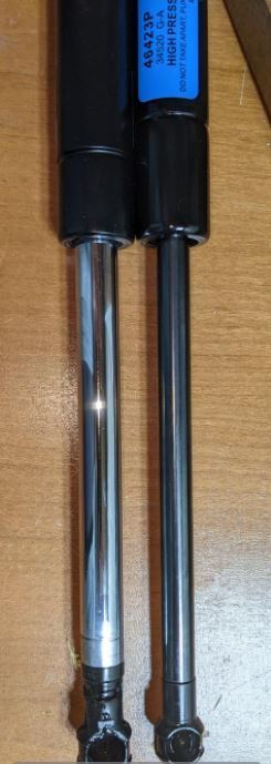

Couple of other point.s.....the Strongarm shaft is a shade smaller than the OEM. However, works just fine. I've also seen people commenting on whether the new struts open the tailgate or hold it or what. Here's my observations based on lift gate height:.
At 0"-12", the tailgate will close.
At 12" - 24" the tailgate will stay in position.
Above 24"', the struts open the tailgate to the full open position.

Just showing slight shaft size difference. Strongarm (right) vs OEM ....
Had to pull off the retainer clip since this one was a bit snug. Retainer clip comes out easily, but use caution not to drop it.
